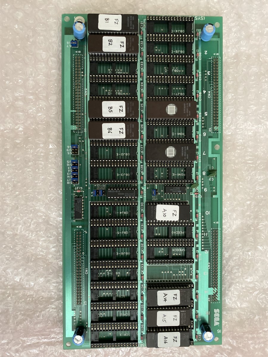

I can confirm it works on System 16B as I have a converted ROM board that I put-together myself.

Rom and jumper locations @DGS

Since I have a S16A, I wouldn't mind converting it to Alex Kidd and converting one of my S16Bs to Fantasy Zone if that's the regular version of the game. The information on the multi only lists to the "Time attack" variant, so it seems this game never made to it. Unless there are other multis around other than the ones powered by Darksoft multi romsets.
I was able to extract the program ROMs from the multi set and run Fantasy Zone Time Attack on the System 16B, but I didn't play well with the original SCR and OBJ ROMs from the original game. It behaves the very similar as when you convert a S16A to Fantasy Zone with the wrong IC69 PLD. Extracting the SCR and OBJ data is a major annoyance, because there seems to be some swapped address lines and as a result the data appears to come in 256 byte chunks, separated by 256 bytes of nothing. At that time I gave up and just used the System 16A. Sound worked fine with extracted Sound Program from the multi set. Test menu worked fine.
