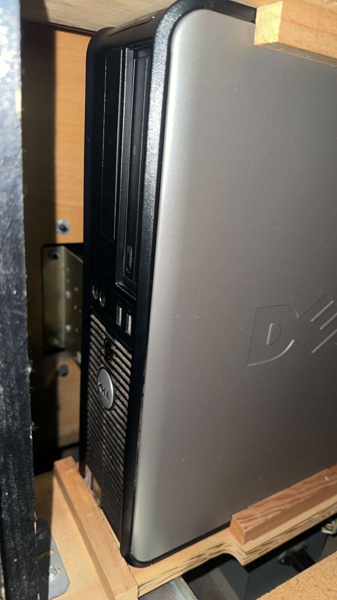

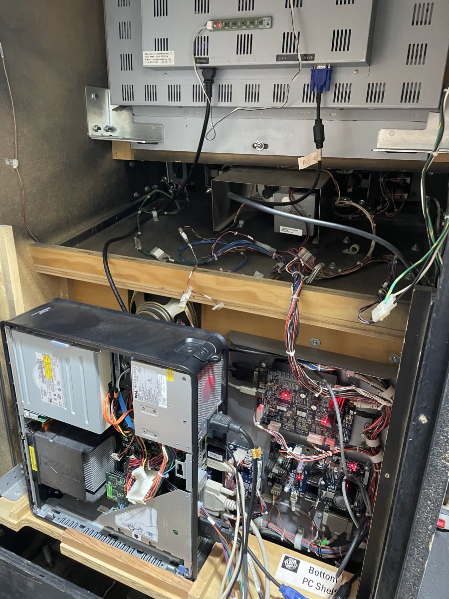

Hey guys, I am new to working on old arcade systems and stuff but at relatively inclined in all the systems involved as I am an aerospace engineer. The person I bought this system off of ran a business leasing them out to other businesses and he said it wasn’t worth his time to fix it. He said it just stopped losing the game one day. All the lights turn on and the board flashes a bunch of lights, but nothing sound wise or on the screen when turned on. Any ideas? Anything I should check for or test? Pictures are attached. I think it has had a LCD screen put in a while ago. But it has worked since then.

The Dell PC. My guess the problem lies in either the GPU, RAM, motherboard or PSU.
You don't need to have it inside the cab to troubleshoot it. Once you have it booting to the game, put it back in.
Okay👍. I think based off what I am seeing, the GPU is the likely culprit, or at least I hope it is. I’ll take the PC out and apart today and see what I can find. The PSU looks fine and sounds like it is fine, but for some reason the disc drive doesn’t open? Is that an indicator of anything? All of this circuitry is so old I’m not super familiar with what I am looking at.

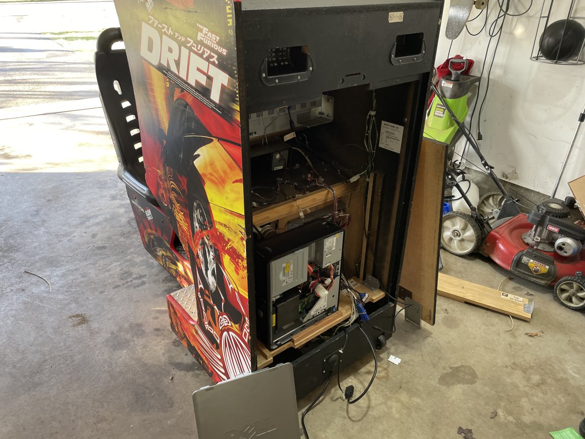

Okay, I’ll just get an optiplex 740 off eBay then. Is there a listing you would recommend for it? Can I just swap the GPU I have in the current Optiplex into the new one? Will be interesting to see if this works. Does it matter which operating system it has on it? ie. windows xp vs windows 7? Does it need to have an OS at all? Also, here are some more pictures.

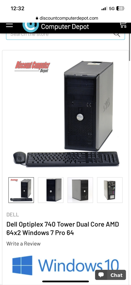

That's not a 740 though. Listing says it's 755 or 760.
740 is Athlon 64, 755/760 are Core 2 Duo.
I haven't tried the game with a C2D. My guess is you'll run into issues, but if you've already ordered it, I guess there's one way to find out if it works or not!
Ugh. I wondered, it didn’t say what exact model it was on the listing, but it looked identical so I didn’t think much of it. I’ll try and cancel the order and pay the upcharge for the 740 model with the AMD CPU.

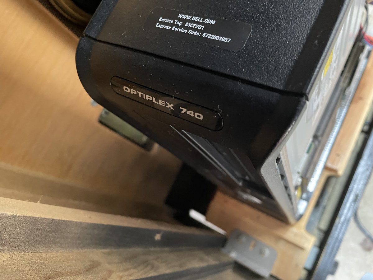

I’m not sure which chassis this is supposed to be based off the diagrams dell provided. Maybe this is the mini tower in the listing? It just looks to big to be that.
