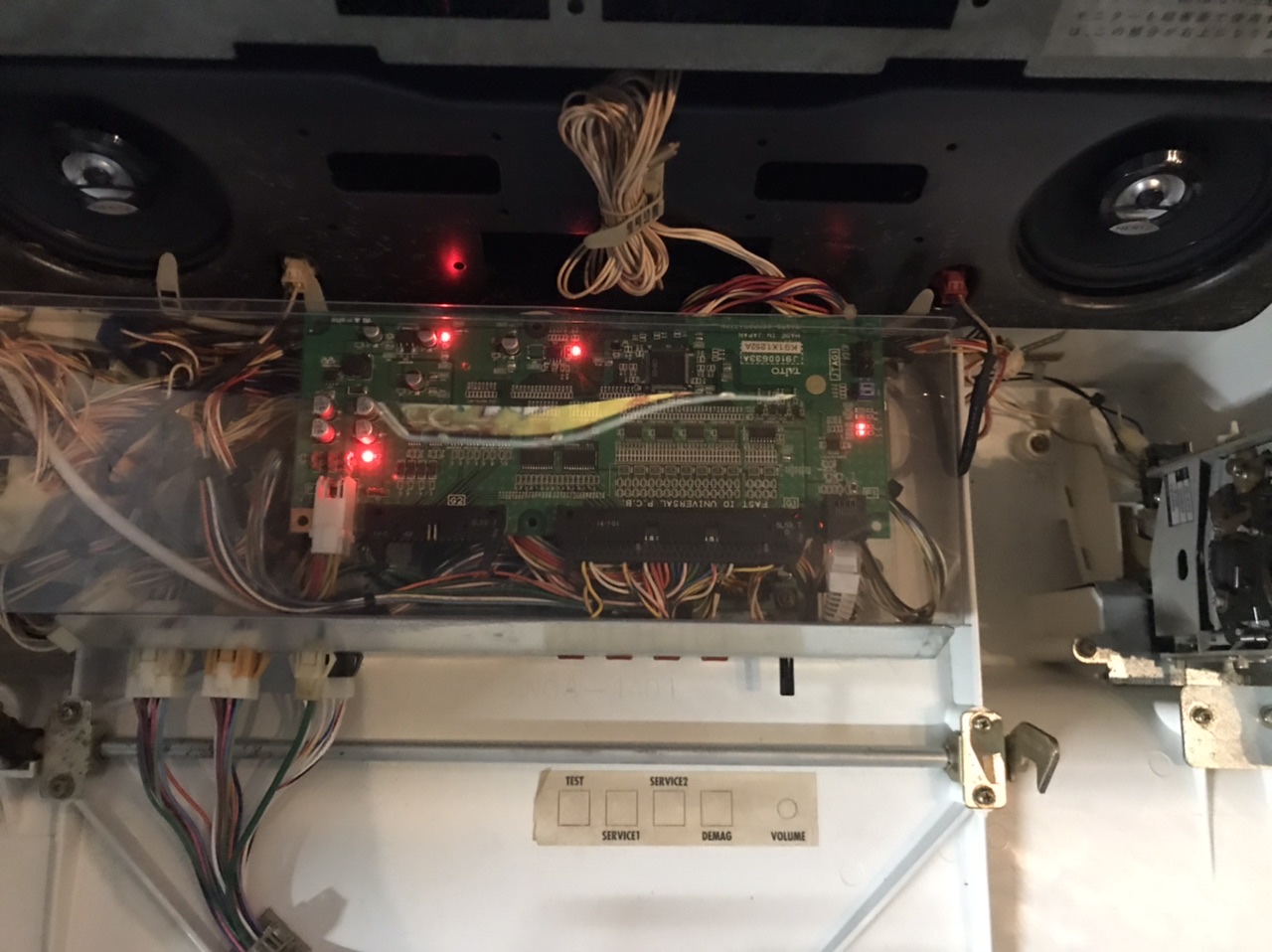

Cool so they do all work then, if it works on test menu, might be an issue of the game then for some.
yeah I’ll prep an SSD with more games to test, haven’t used it in quite some time.
But pretty positive back when I installed the FastIO it worked in my USF4 TTX3 unit

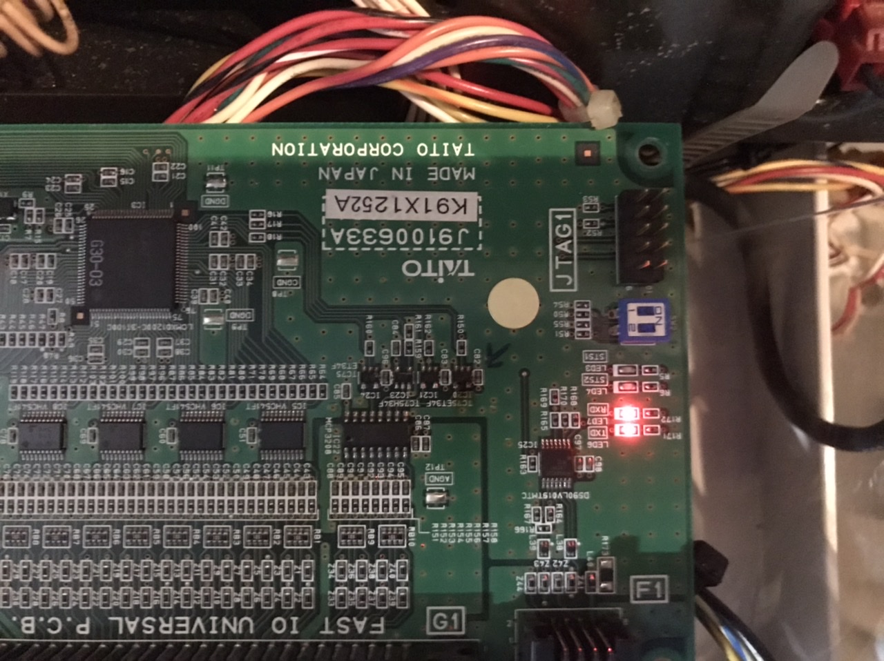

Thank you so much @PascalP!
So we can confirm K91X1252A works with 6 buttons.
Hopefully @Derick2k can confirm his board model but at least we know the K91X1243A board doesn't work.
If anybody else has a B or C revision of the 1243 series and they test/confirm, that'd be great.
I have a few of the 1252A variant and a whole bunch of the 1243A variant, dont have any B or C, unless I find another box I have with more ios.
So will test both the 1252A & 1243A that I have just to see that I get the same results.
Maybe its a firmware based issue, so hopefully we can dump the 1252A to update the 1243A??

Thanks for confirming.
Unless someone knows how to dump the f/w of the 1252A to update the 1243A, then I pretty much have two options for the fast io route... either find 1252A's for sale (assuming they're cheaper) or get the Jamma edge one - more expensive by the look of it.
guess I got lucky them when I picked up the FastIO PCB on YAJ a long time ago.
Have you double checked the jumpers on your 1243A if they match my 1252A?
Yeah I've been on the lookout for your model now. I've seen B and C versions of the 1243, just never the 1252A.
I have also tried your jumpers and it's pretty conclusive, it has no response :(
Might have to suck it up and buy a jamma edge one from Cererth and get it shipped over to AU

Which pcb did you use to do this test?
1243a is confirmed 4 buttons only, buttons 5 and 6 do not work.
I wonder if its a firmware issue or if those inputs are just not connected somewhere?
