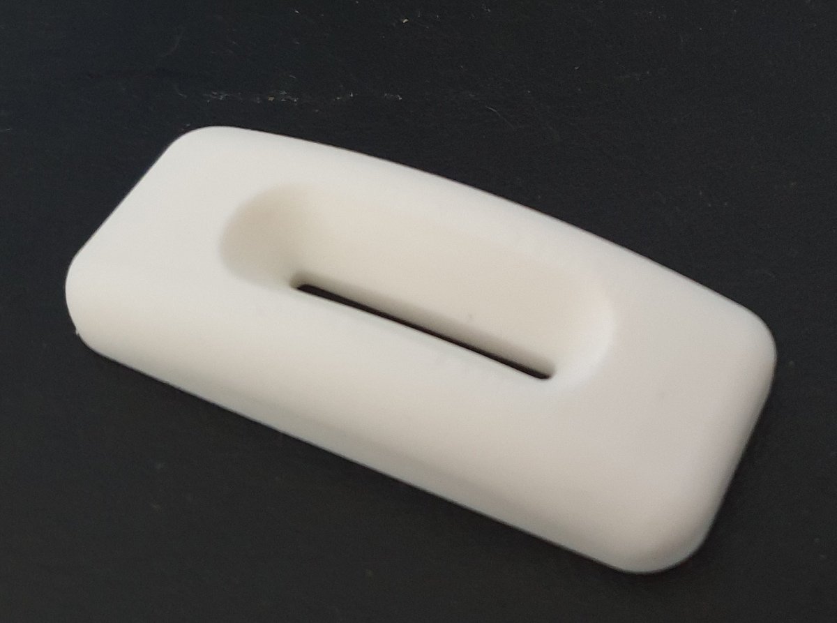

Sorry for the confusion and hassle. I'm trying to determine how the plastic coin receptacle, the part the player sees above the control panel, is attached to the panel. The picture you posted of your coin slot, the white plastic part, has no threads that I can see, so I don't know how it's fixed to the panel.
So far the only details I have from a chewlix user are of a replacement Sega coin slot that he drilled new holes to install.
As I don't know how the original coin slot is different than this aftermarket one, , your guess is as good as mine. I did pull this off the ebay product page where I bought it (translated from french):
The coin slot screws onto the control panel with fine plastic screws not provided.

This is going to require (I'm guessing) plastic-compatible screws of a specific size. The Sega/Namco/SNK cabs have coin slots with metal M3 threads, so I know exactly what I need to include in the kit to make it fit. I'm going to either need a local unit to tinker with, or someone with more knowledge about the specifics, so I can create this kit. =/

@Jughead - I've whipped up a new coin slot from scratch. If the hole spacing is correct then this should solve the problem. =)
How does it attach? You've got two holes in the white coin slot that don't appear to be threaded. The photos I've seen show a bolt with nuts holding it on from beneath the plate, but I have no idea how they connect to the white part. Can you help me understand that?

Well thanks! Let me know if you'd like me to do anything else. I could also put the inserts in like the thread above.
OK, so now I just need an accurate measurement. That photo suggests the distance between holes is 44.8mm (I suspect it'd round up or down to 44 or 45), where the imperial->metric measurement I have so far is 41.3. That's the last thing I need to finish the VLX option. =)
I'll measure with a metric ruler this evening. You want the control panel hole distance, not the coin slot, right?

Add $5 if you want my external coin slot, or you can slam the heat press inserts in your own, of course.
