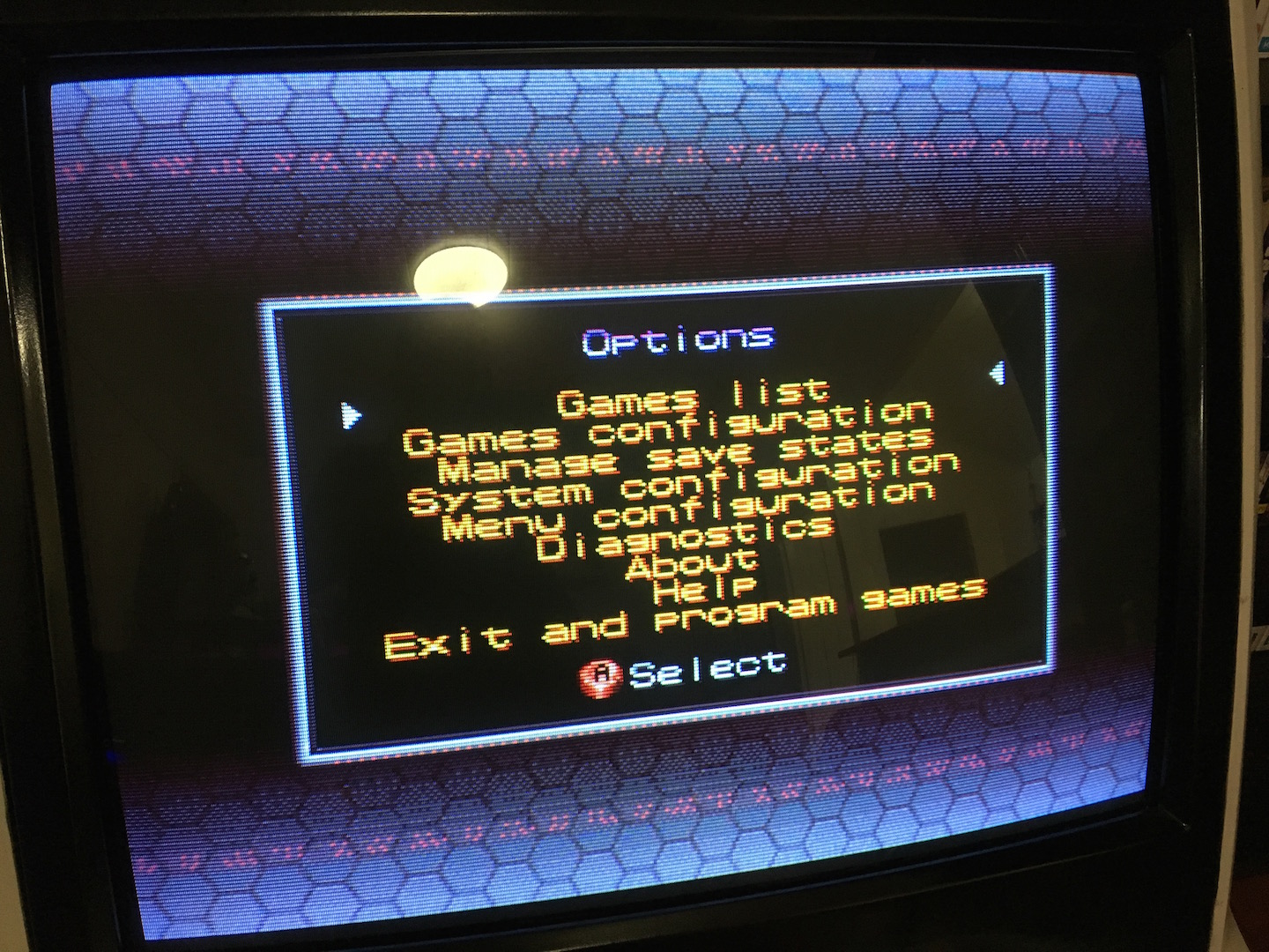

As @Sp33dFr34k pointed out it was the line of static which was my point.
It only happens if animations are turned off.
I have found the animation setting but it does not turn off what I want.
When the system boots you get a logo fading in, then you get a menu and when you hit 1P Start the POW starts walking off the screen. I would like the system to boot straight into the menu and no POW present.

The line that flashes in the menu is well known. It's not affecting operation so it's not near the top of the list to try to fix at this point.

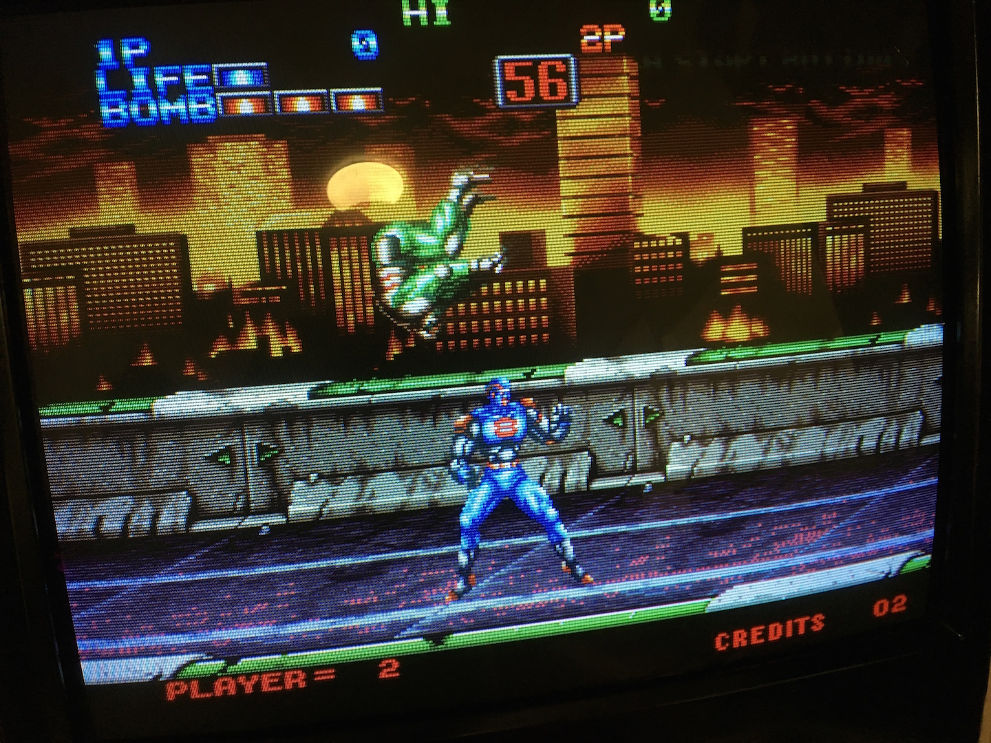

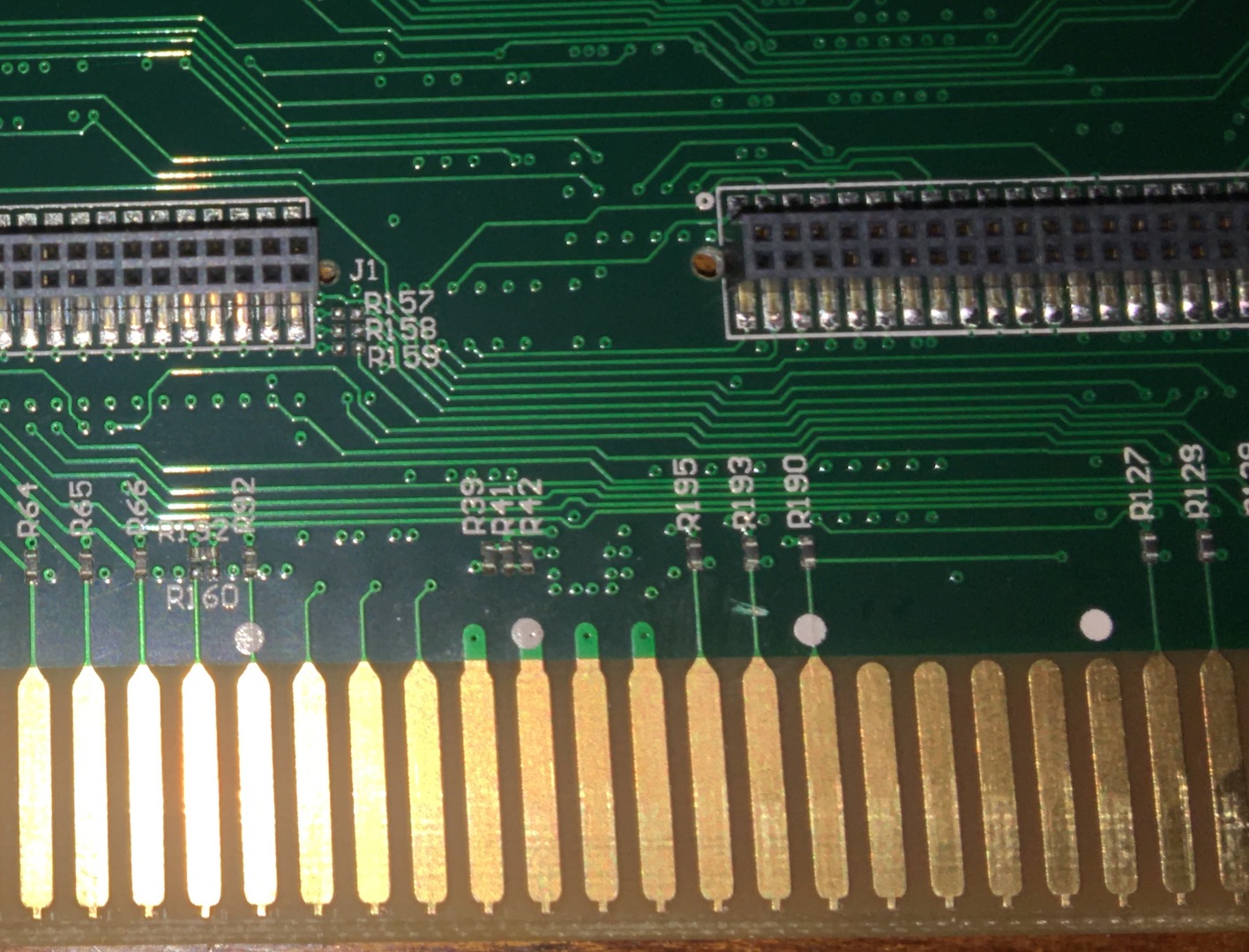

Finally got around the cutting the trace (see photo) and tested for continuity with a multimeter. Rebooted the cart and still having these issues of graphical interference. If anyone knows a solution, please lend me a hand. I'm dumbfounded...

@djsheep those issues are something else. I dont think they come from the multiMVS. Have you tested the cart with original carts?
Hey @Darksoft -- I've used original carts with this Motherboard before. But I will test the multi with a friends motherboard sometime soon and see if that works. At least I've cut the trace now :)
Happy to report that I tried the cart with a different motherboard (MV-1FS) and the red dots/lines aren’t there anymore. Will test the cart more soon, but doubt there’ll be any issues.
Now that I’ve used another motherboard, I realized “cart flashing” text on my broken motherboard was blue, so there are colour issues with it (text should be white).

No the cut trace was for some graphic glitches on some board types.
