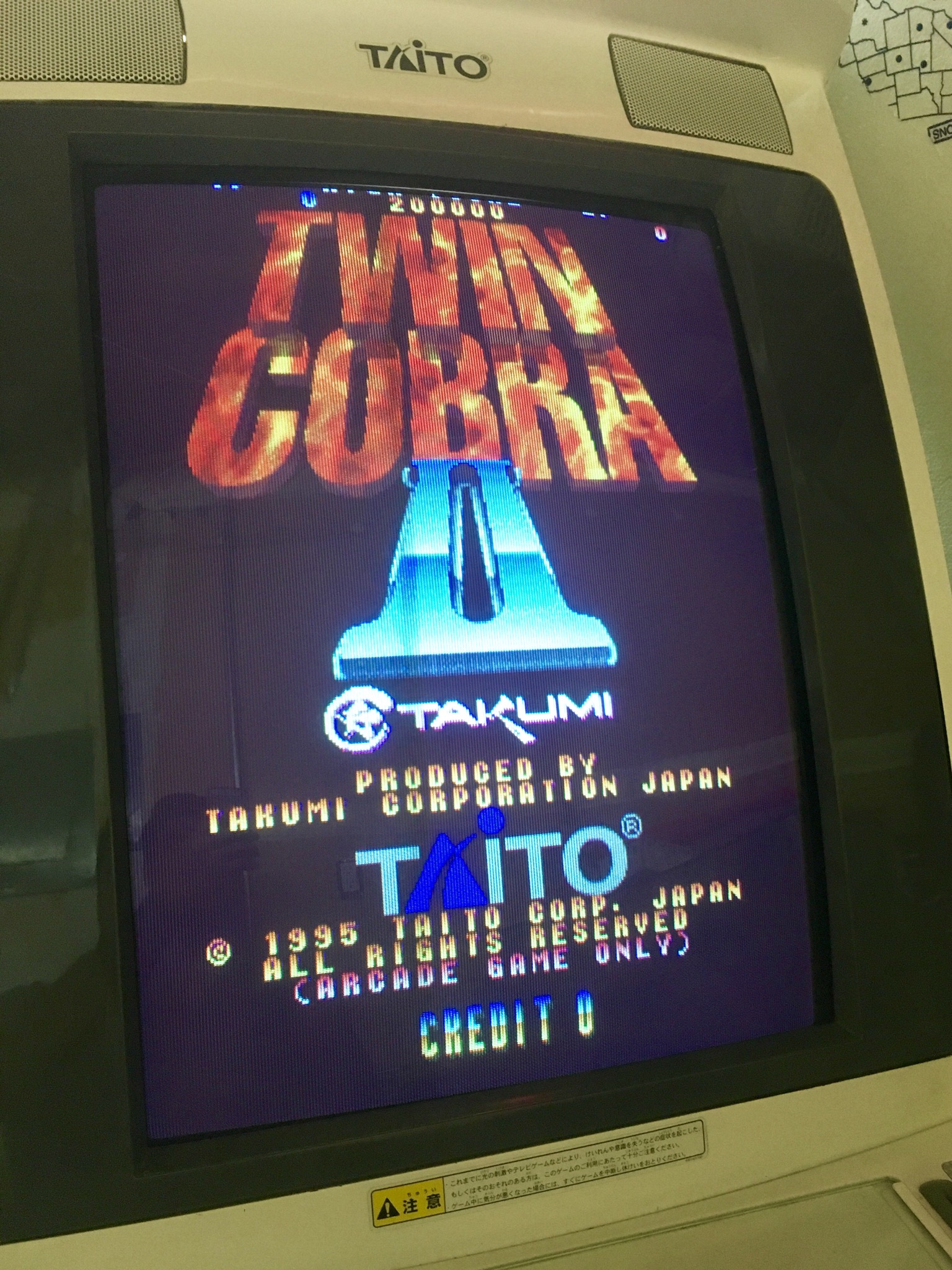

Got her working dawg. Say when you wanna do this. Also, I say first thing we check is your SD card.

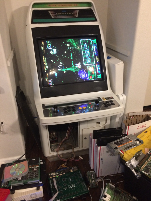

Got my F3 multi back from Mitsu and it’s alive! Thank you for the service!
What was the problem with this cart?
