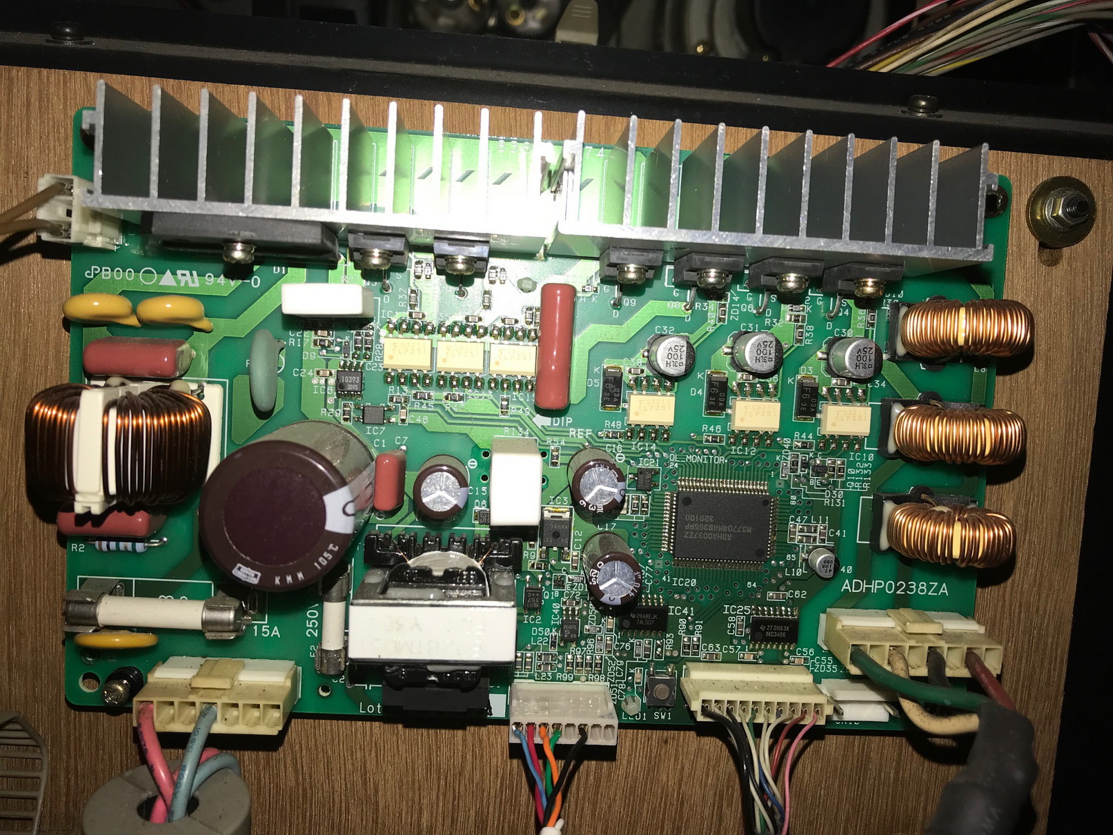

Everything should in theory work as-is, with the exception of the Force Feedback Board. The Chihiro talks MIDI to the board I have, whereas the Lindbergh wants to speak RS232/RS422 with the 838-14592-91 board.
I have tried to find a 838-14592-91 board, but haven't been successful.
This got me to wondering if it would be possible to make some sort of adapter/conversion board based on an Arduino that would allow a Lindbergh to connect to a MIDI system.
So with a weekend with not much on, I started doing some research.
The Outrun cabinet wiring diagrams were a big help and allowed me to quickly zero in on which connections would be of use. The ones I am interested in are CN2 on the 838-14174 DRIVER BD MIDI.

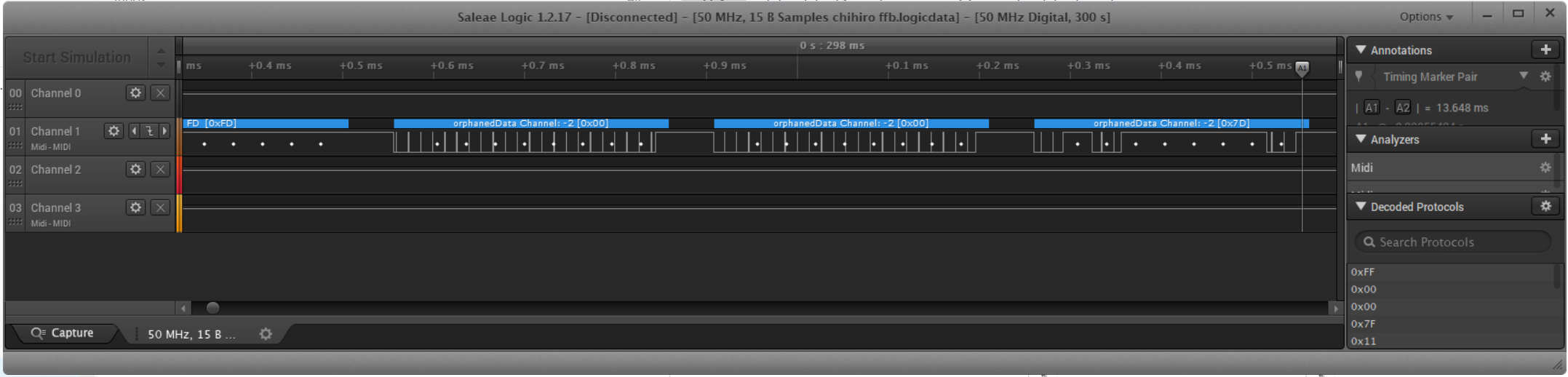

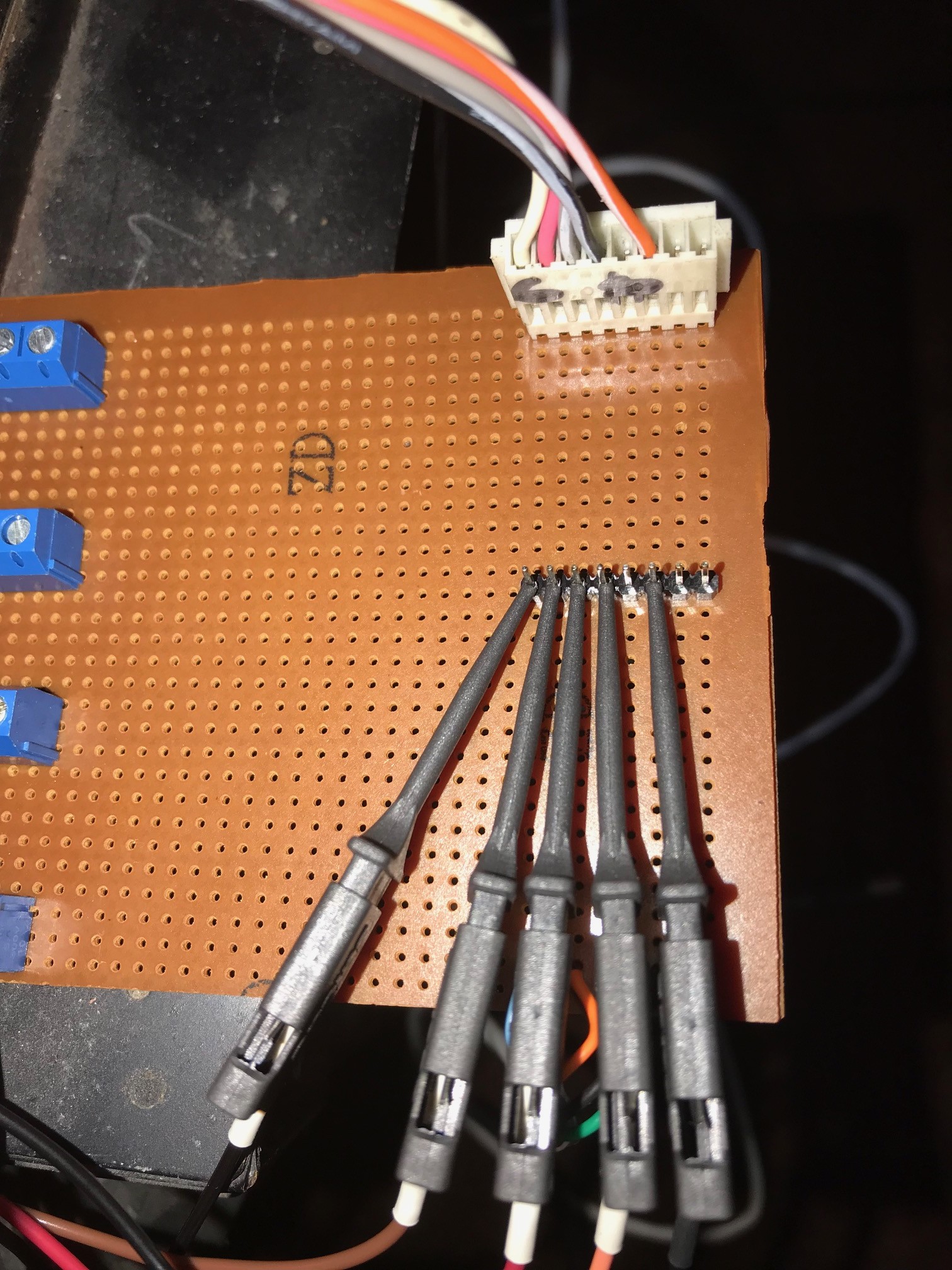

CN2 has 5 wires connected: shield/gnd, TXD,TXD_R,RXD, and RXD_R.
Figuring this was a good place to start I connected my logic analyzer to those 4 pins and captured the cabinet booting until the game loaded. This includes the self test where it asks you to stand clear and it rotates the steering wheel full right.
As luck would have it, my analyzer already knew how to decode the MIDI protocol. So I ran the software just to see what would happen.
The first group of data that caught my eye, was the Chihiro repeatedly sending the packet:
FD 00 00 7D
Which was answered by the FFB board with:
0x44
So I went digging into the Midi protocol spec and quickly discovered that 0xFD is a system message that's undocumented and should be ignored. Great.
