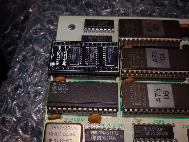

Recently I made a reproduction of the Fujitsu 'MB112S146'.As far as I know this custom IC is used on few Taito arcade PCBs like Arkanoid (which uses two of them), Legend of Kage and Wyvern F-0.It's a DIP28 .600mil chip having the main function of graphics shifter :

As for me, I reproduced it in a 'poor' way using simple TTL gates instead of programmable logic devices :
Testing was successful on my Arkanoid PCB :

I much prefer your TTL approach if the circuit is simple enough. Because in 20 years from now we're going to need repros of the CPLD repros...
Yes, i think there is no need of programmable logic devices for these small designs, they would be a waste.
Hopefuly TTLs will be still available, I can see some manufacturers have stopped their production.But this is a problem for next generations of arcade enthusiasts :)
I'm not too worried, there are still several dozens of manufacturers making TTL chips. And given their extremely high popularity and longevity I think we should be good for the next 30 years. Then as you said the challenge will be in the hands of the next generation.
