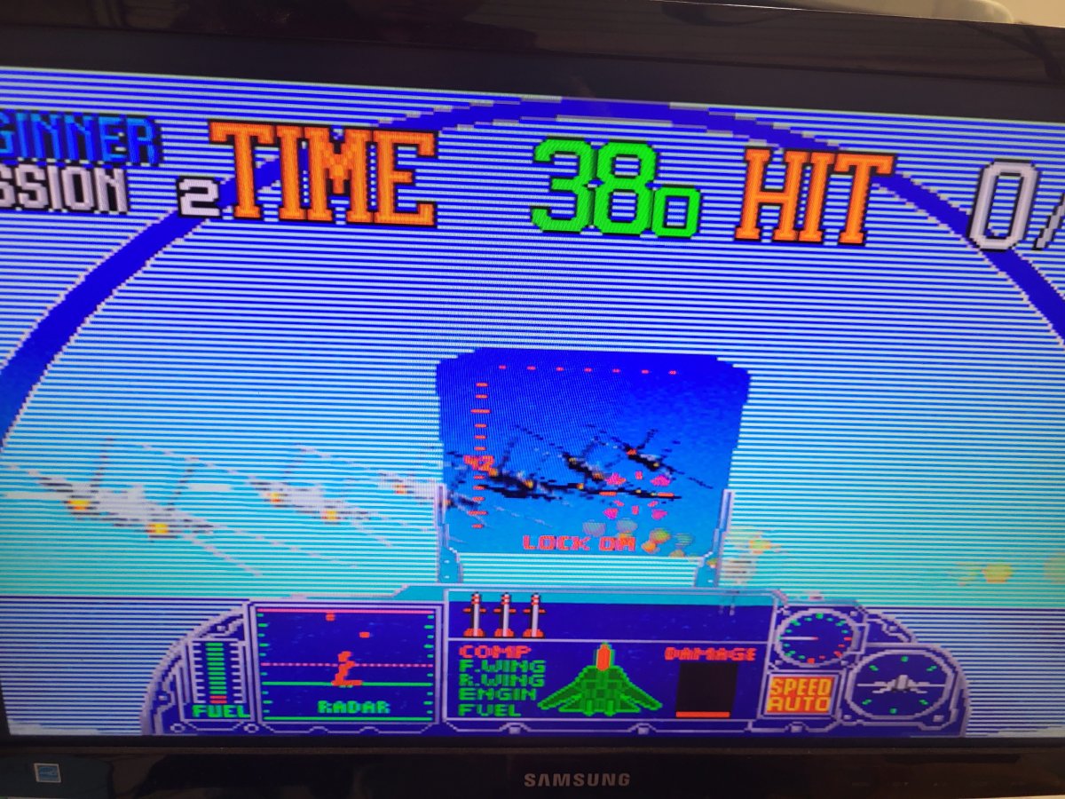

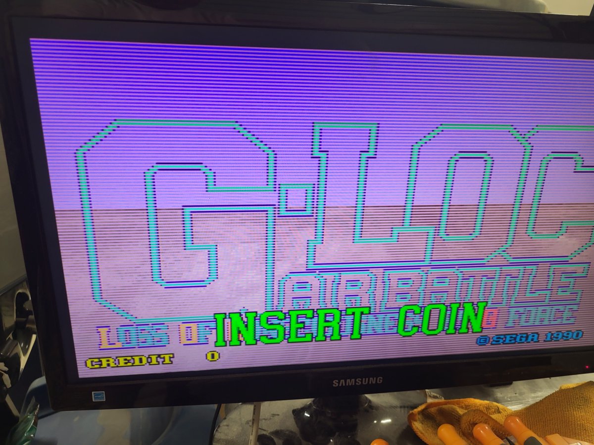

Just picked up a G-loc. The game plays fine but it has horizontal lines through the background. From what I have read this is a bad Rom.

It’s hard to tell from your pics, but is the horizontal lines through the entire display or only certain tiles? If it’s only certain tiles then a ROM issue is likely the culprit. If the lines run through the entire display then it’s more likely an issue with line buffer RAM.

Thank you for spending the time to write this up! This is great info. The lines go through all of the background the objects like the heads up and the overlays look great.

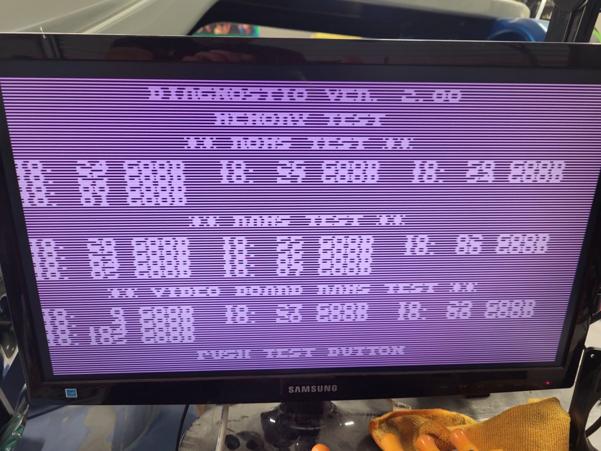

First of all, G-LOC has a Self Diagnosis mode that you can load up through the Service Menu. I highly recommend starting there if you haven't run it already. If you're lucky, it'll find the problem for you and indicate which chip(s) are your culprit.

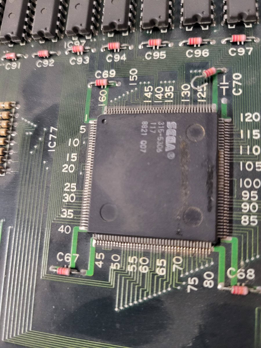

You are the man! Thank you so much for the direction and help. I ran the memory test and it looks good. (It also shows you how bad the screen looks.) I did notice that C70 was only soldered on one end and the other end looks like it was never connected it attaches to chip 315-5306. I'll take a picture tomorrow. Would they put a cap on a board and not connect up both ends? I hate to connect it up and fry that chip.

I got the pins fixed. Moving back to the board. I've attached a picture of C70 which is not connected. It has a very long leg, making me think it was never connected. I am thinking I will solder it down and see what happens.
