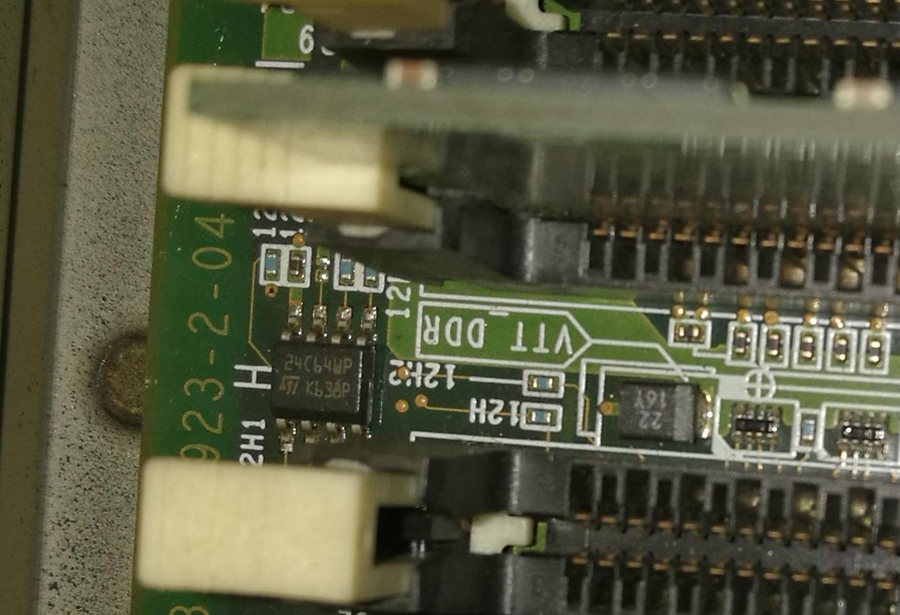

It seems that you have a malfunctioning EEPROM chip which stores region code on the mainboard
