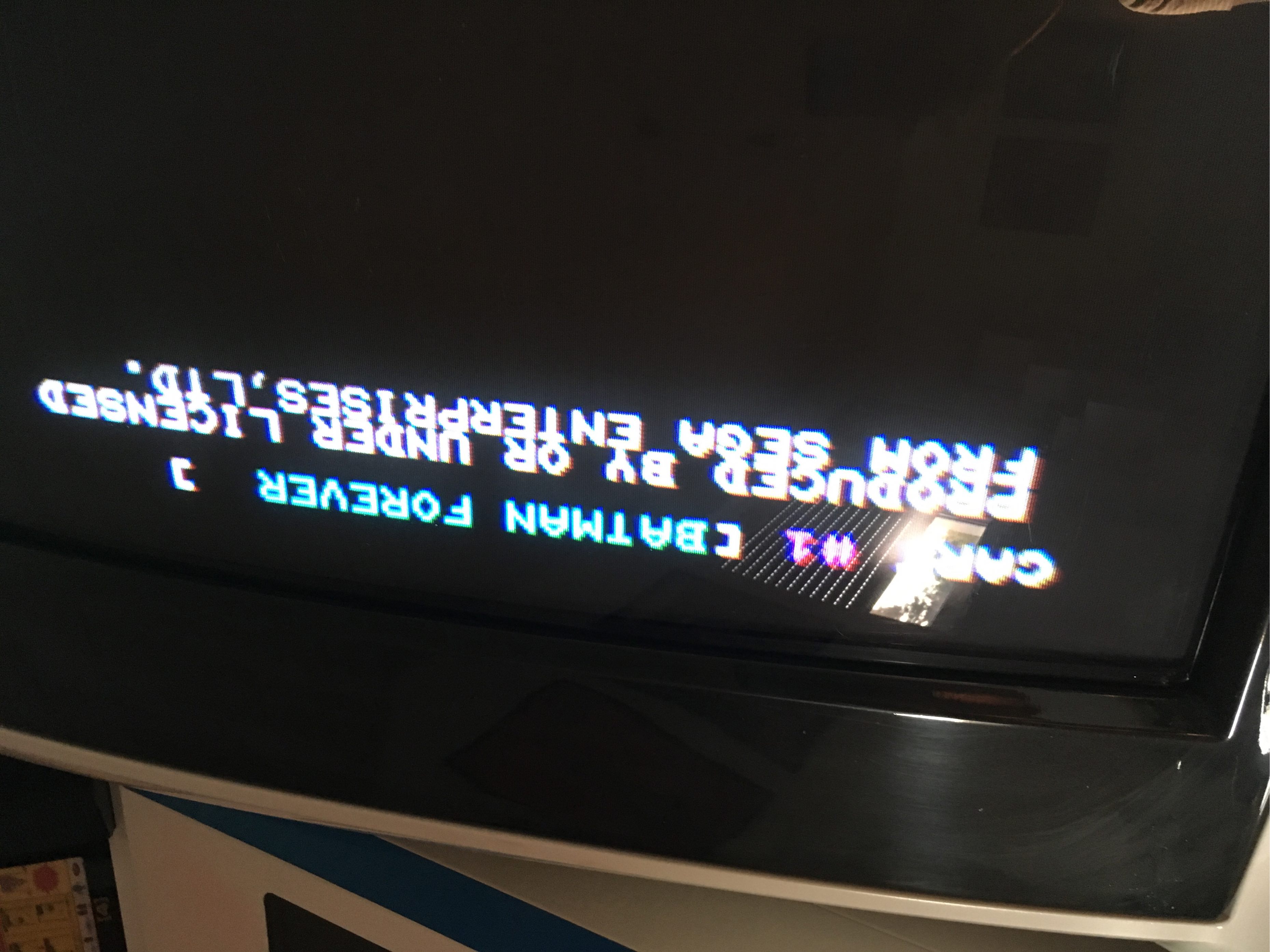

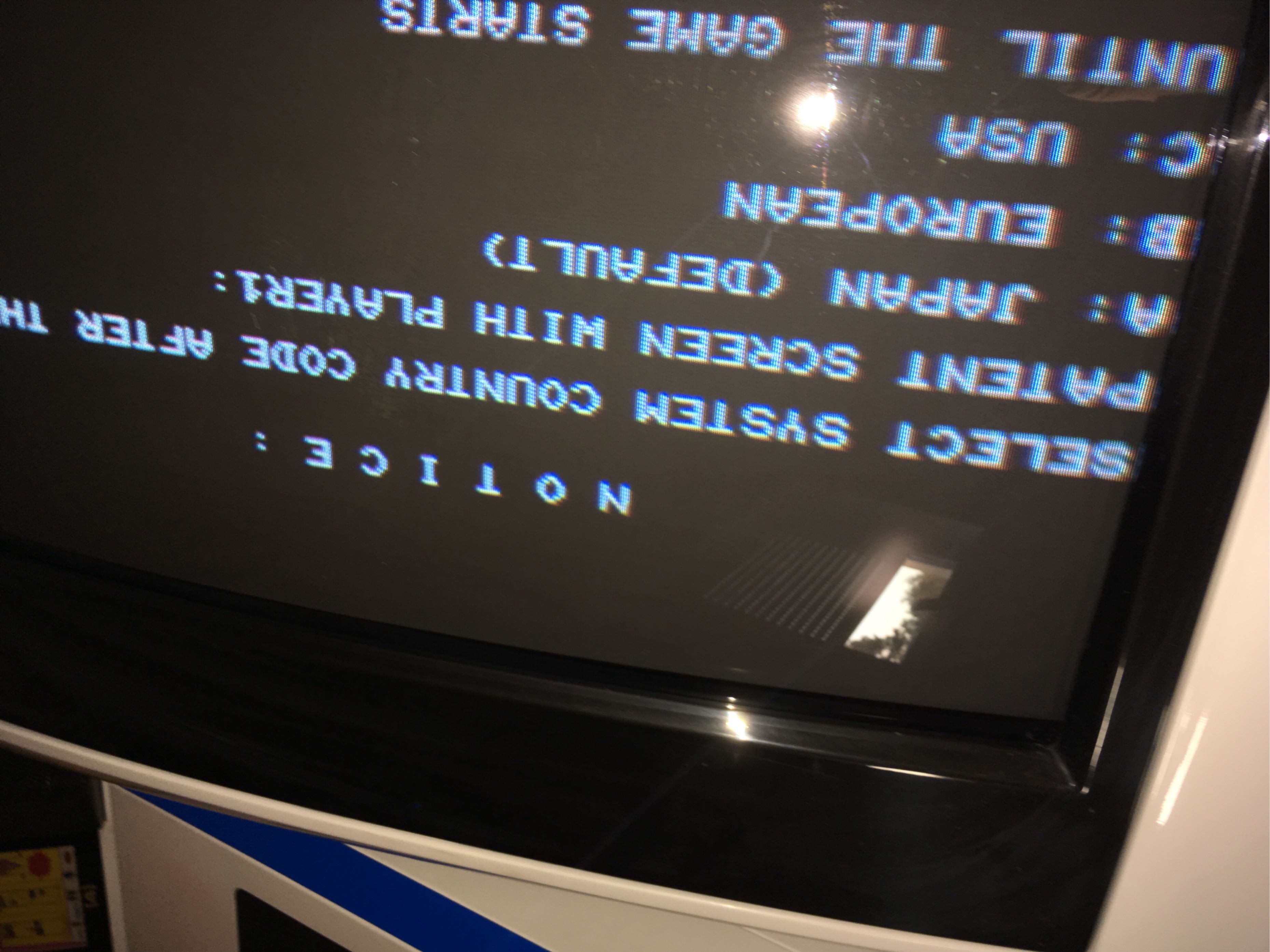

That's the case with almost every game. He loads the game and then only black screen.

That shows that the game was loaded properly, it's being recognized by the STV mobo but then you get a black screen. Either your eprom or your mobo is bad IMO.
