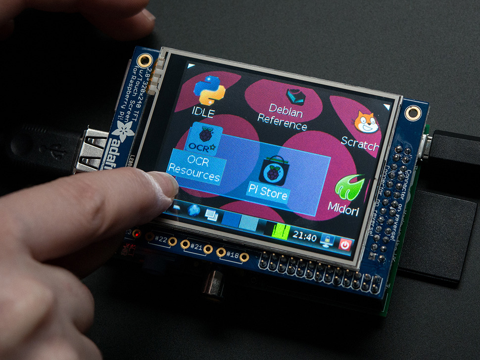

I am currently working on getting a touchscreen solution (like pictured below) to work, the screen really doesnt cost that much more than the standard character lcb. If I get it to work, which I dont see why I would not. I am planning to make a bezel to install in on the instruction panel of blast cab.
My project use the touchscreen to switch between Naomi and Mame PC.
It will be integrated in the cabinet...of course it`s more easy to have some simple switches...but i like complicated things.
As for your idea, I will suggest not to use a bezel instead of instruction panel. I mean not entirely. You can trim the glass, move the metal holder and use one of the corners to fit the touchscreen. At least i`m doing like this for my other Blast City cabinet which will hold 6 consoles.

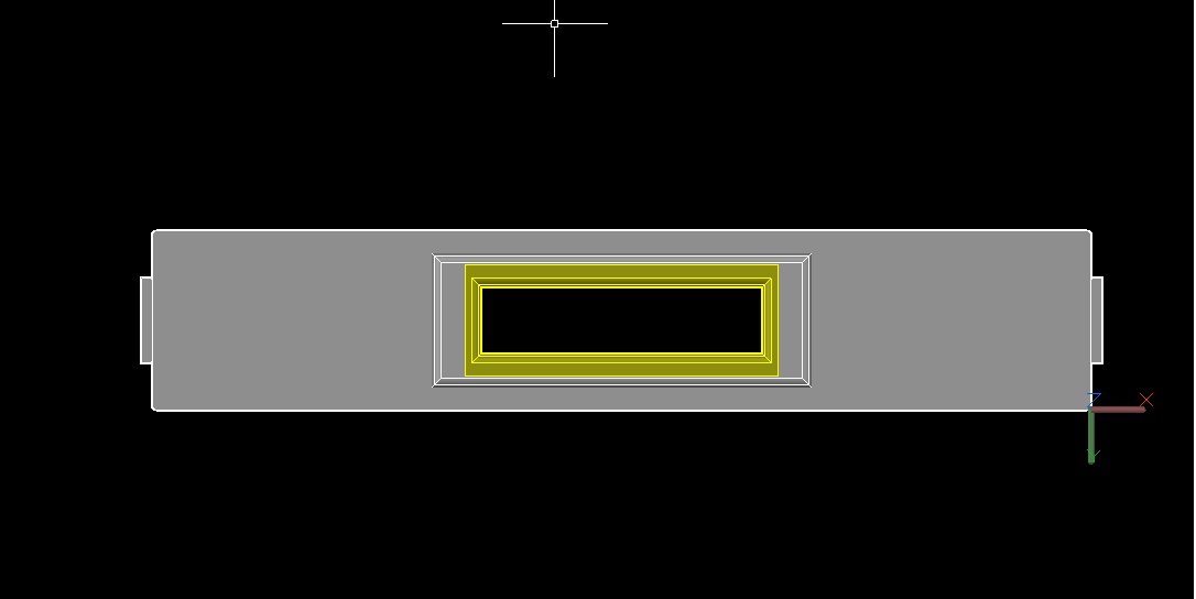

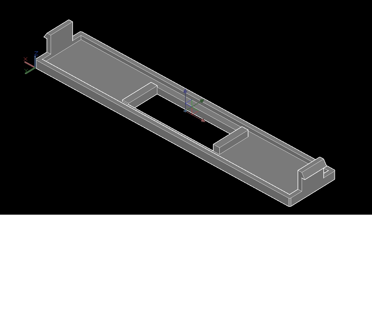

For my Piforcetools display on NetCity cabinet i used a custom made mask, created in Autocad and made with a CNC tool. 3D printing sucks...big.
Check the picture...just for idea
My project use the touchscreen to switch between Naomi and Mame PC.It will be integrated in the cabinet...of course it`s more easy to have some simple switches...but i like complicated things.
