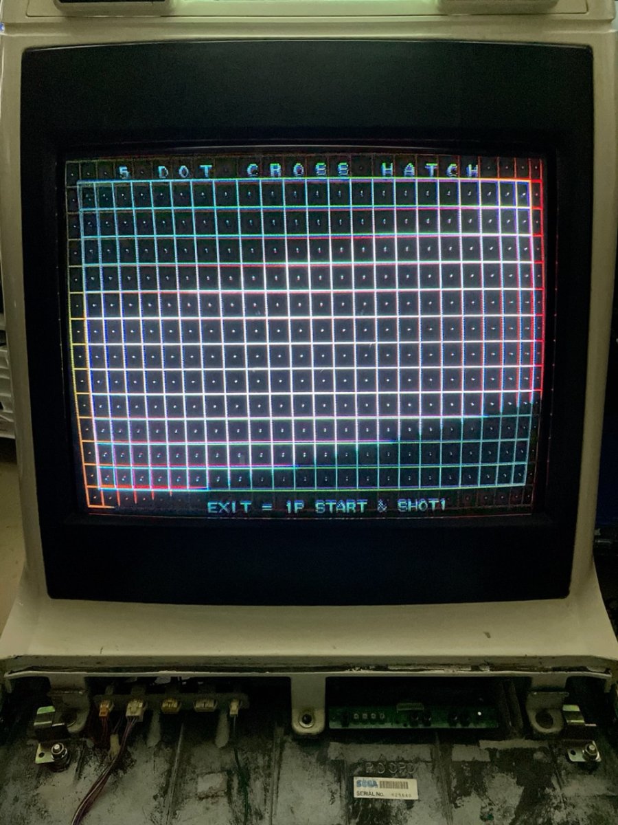

It really just might be flipped 180 degrees. The little adjustable coil is normally on the bottom of the MS9 yoke.
I rotated the yoke 180° and, while adjusting the HH15 pot, the monitor shut off and now doesn’t come back on. The chassis recently blew a HOT and I replaced with a HOT from a parts board so I’m thinking I need to use a new HOT?
New HOT from eBay seems to be working fine. I also replaced the voltage regulator at Q901 just because I had a new one.
Now, the image is way too wide, even with the chassis set to “narrow.”
EDIT: I adjusted the H Lin pot and was able to make the image narrower but the far right and left don’t look right now.

Let's get a shot of your chassis near the HOT and the S-capacitors.
If the image is way too wide, and your corners have such jazzed up convergence... it's possible you have a Blast MS-293x yoke?! That tracks with the extra coil situation on the back of the yoke.
If it's a Blast yoke, save it - could be useful one day - but it will never look good on this tube.

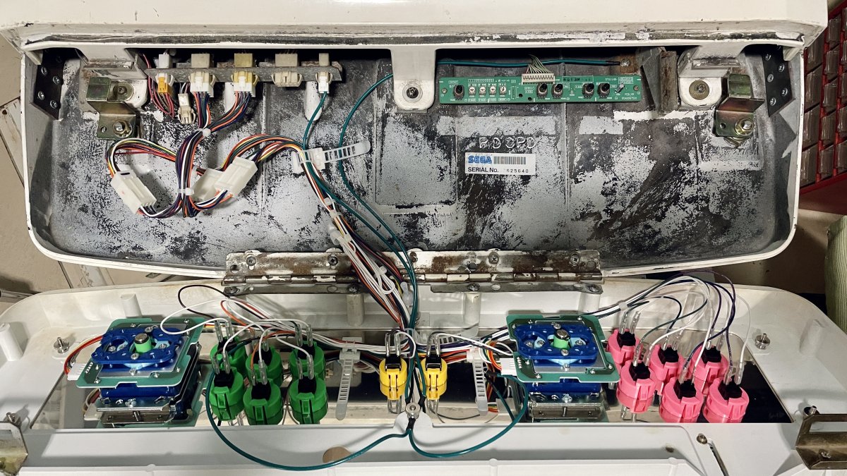

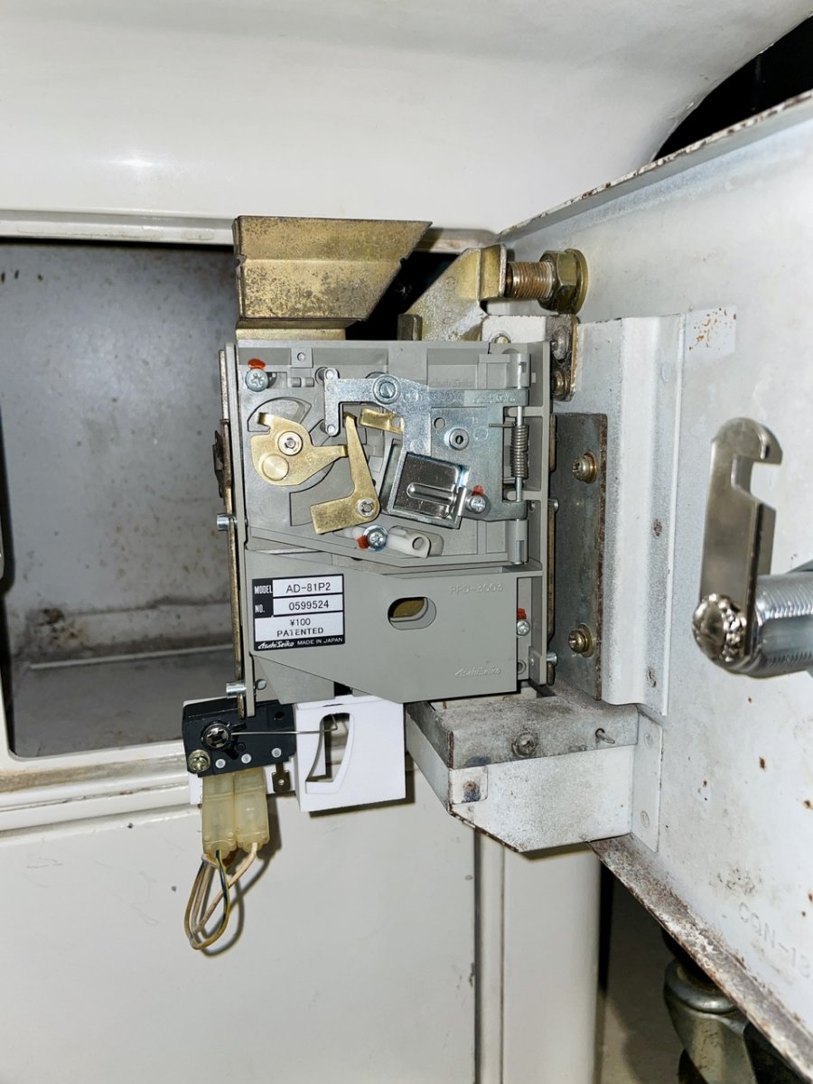

While I wait for a replacement MS9 yoke, I wanted to provide some small progress updates from the past few months.

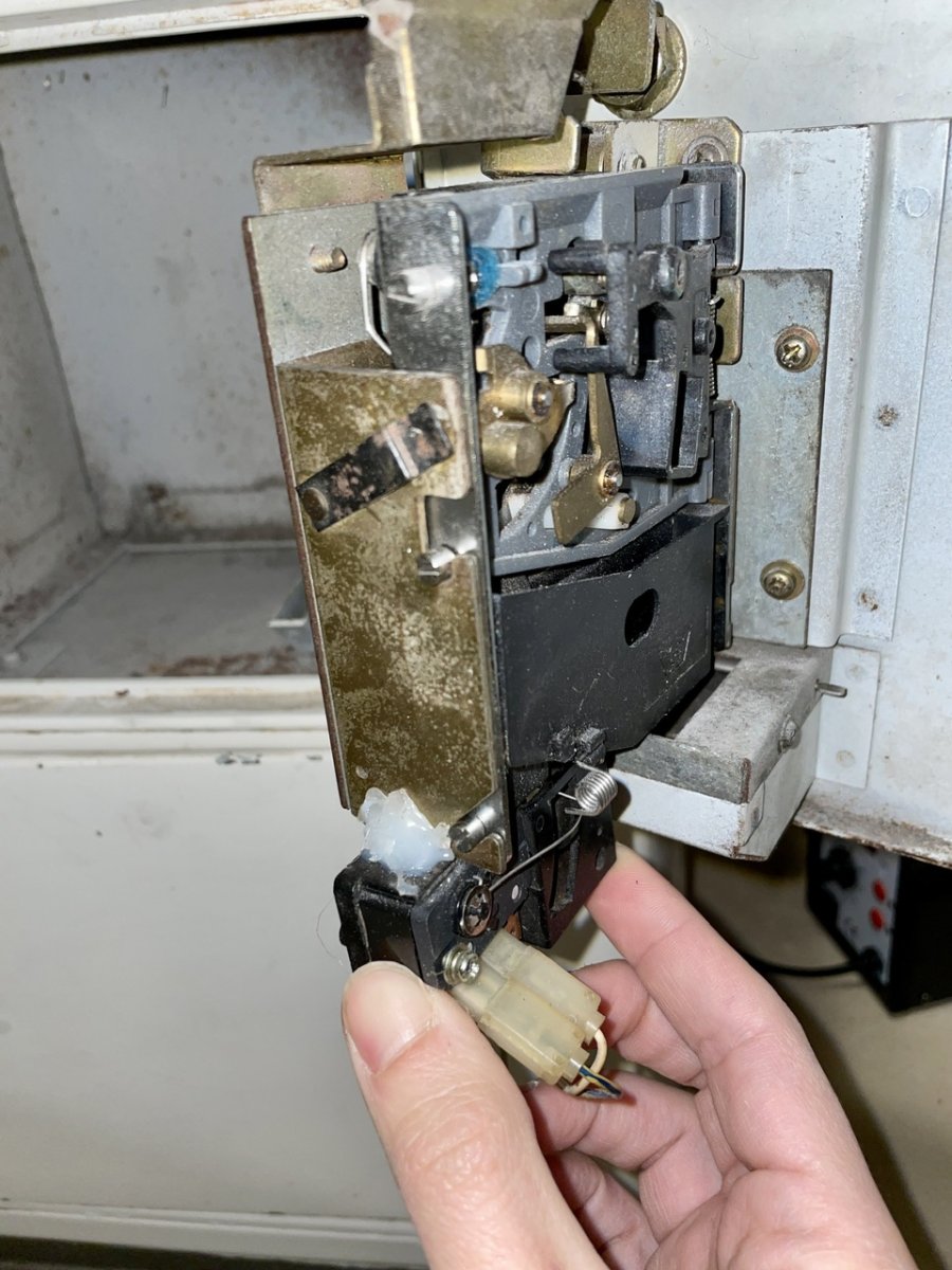

The bracket that holds the coin switch arrived broken and poorly glued. Luckily, someone has already designed a 3D-printed replacement bracket and it works really well!
I also took this as an opportunity to replace the non-original coin mech with what would have been included in a NAC. Thanks to @AlxUnderBase for sourcing an original Asahi 100-yen coin mech.

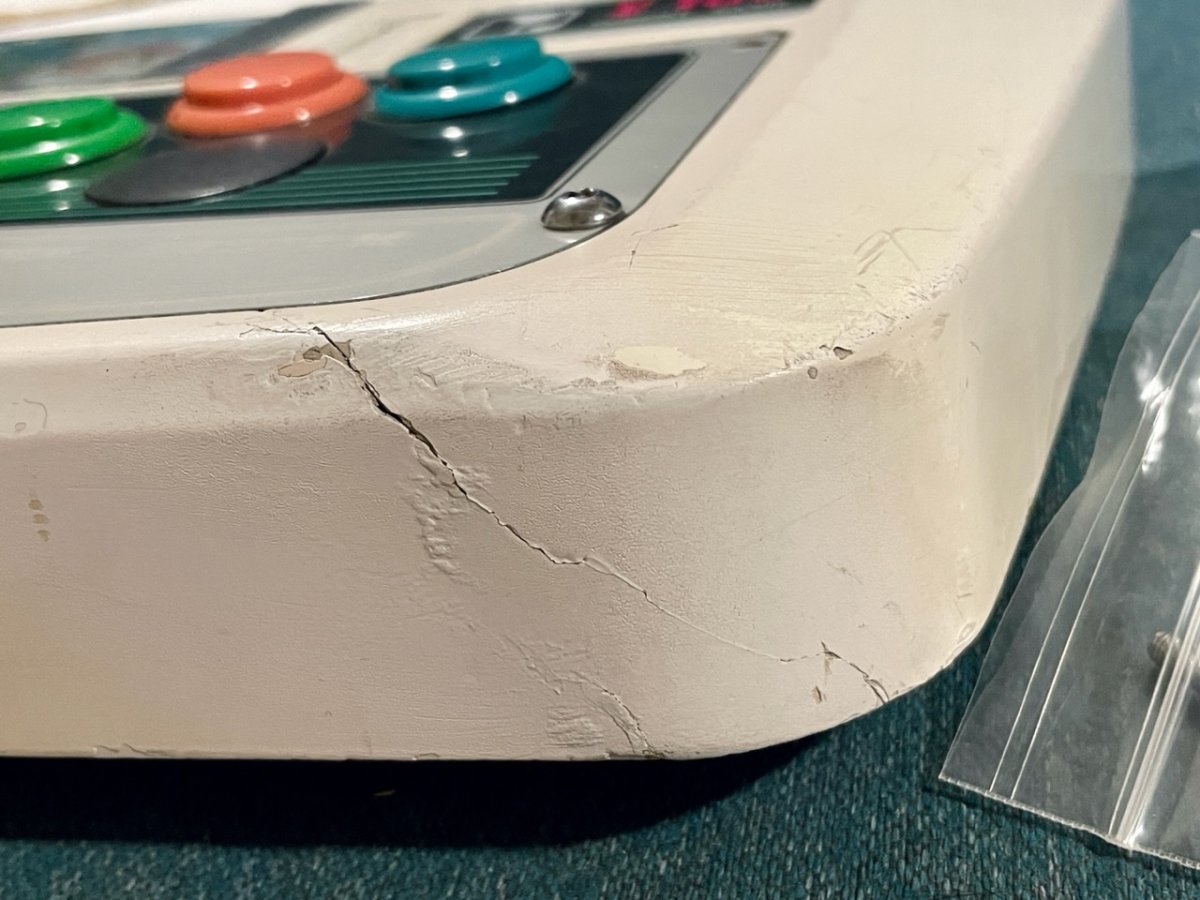

Secondly, I was able to source a new control panel support to replace a poorly repaired one. @stickfans responded to my WTB post a while back and shipped it from overseas. The replacement CP support has minor surface scratches but it's in overall great condition. I'm planning on respraying the entire cabinet so I don't mind the very minor surface scratches. (Check out that color difference!)
I would have preferred to keep the original panel support, however, the person who repaired the corner crack did a sloppy job and redoing it would have been above my skill level and/or a ton of work. The crack in the center seems to have been repaired well or, at least, the plastic on either side of the crack was properly aligned.

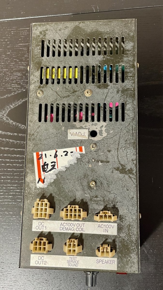

Additionally, I took some time to replace the electrolytic capacitors on the PSU that came with the cabinet. It's a 400-5198 PSU in good working order. so this was just preventive maintenance. I'm glad that I took this step as some of the capacitors had already started leaking and were eating away at the PCB. Cleaned it up and shelved the PSU as a spare given that I'm using the NVS-4000.

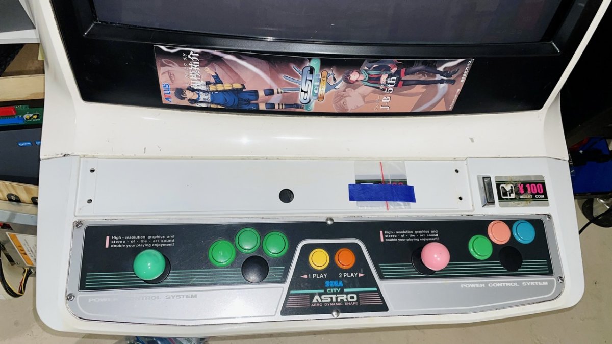

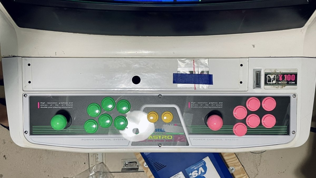

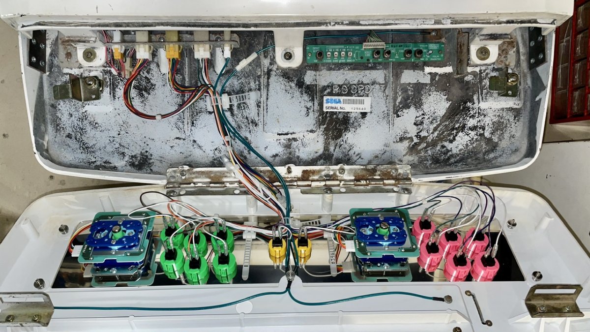

Finally, I replaced the original 2L6B control panel with a reproduction 2L12B from @alberto1225
Thanks to @clintkolodziej for recommending knurled thumb nuts for mounting the CP. makes installation (and swapping) faster.
I had to whip up new 1P and 2P harnesses to accommodate the new LS-32s with PCBs and kick harnesses for the extra buttons.
Upcoming tasks include adding ground wiring to the control panel and coin chute and refurbishing the NVS-4000 PSU, (new electrolytic capacitors and fan).
Posting a quick update on control panel wiring.
I whipped together a short adapter harness to convert a 2L12B panel to JAMMA+
