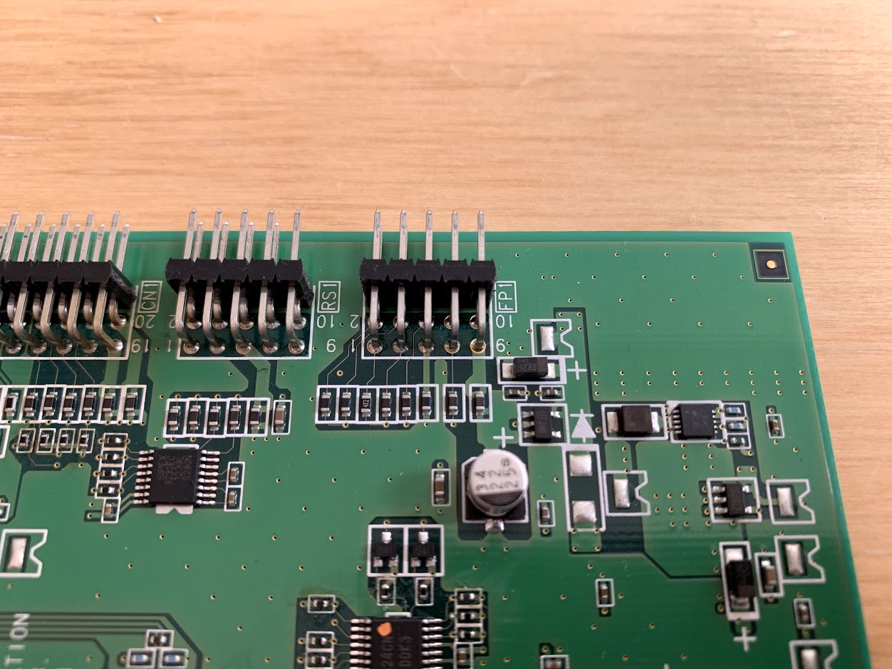

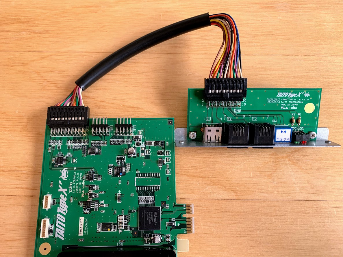

Since I plan to wire everything internally, here is a rough pinout for the CN1 connector.
I should be able to bypass the daughter board entirely.

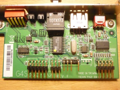

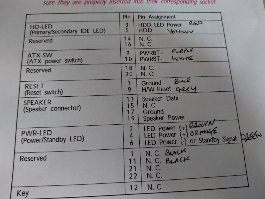

Hi - I also need to power up the IO board on a TypeX+
Please can you tell me the exact pins and wire colours - I dont want to damage anything.
Pin 4 is LED power? Orange wire 5v?
Pin 7 is Earth (H/W Reset)? Blue wire Earth?
is that right?
Thanks for any help
Should I join pins 2 and 4 together and give them 5v?
Brown and Orange wires?
A picture might help?
Its this style I/O, correct?

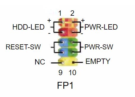

You need to connect +5v and Gnd to the 11 pin header on the I/O card.
This is the pinout on the motherboard. Pin 1 is top left. Pin 12 is missing (keyed).
+5v --> Pin 2/4
Gnd --> Pin 7
You don't need anything else wired up to test. Just power, ground and of course the serial port to COM2.
Just connected it up to the nearest USB header
Orange - 5v
Blue - Earth
Worked first time!!!!
Thanks a million - Still got no sound but controls all work and so does the force feedback!!
Thanks again

Are you going to use RJ45 & USB breakout boards internally?
I was going to do something similar but decided to go a different route (just installed the PCIe IDMAC board inside my gaming desktop instead).
That would be the idea. You can find all sorts of breakout cables on eBay.
Start with JVS controls first, but with the option to add Fast I/O.
Super simple if I can get this JVS2USB I/O Buddy to work with the X2.
My current sticking point is that I have a clean XP install adapted to work with @Nikos multi.
I would rather adapt Nikos multi to work with my clone hardware, but there i have other issues (Post 21).
