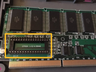

Burn the binary file (available on my website) to any 8-bit ROM with a similar pinout to the 27C010. The file size is very small, and this is the only ROM size required. So you could use a 27C020, 040, 080, etc. You don't need to even repeat the file for those ROMs, it's very forgiving. :)
Once your ROM is burned, open up the cart. You will see an empty EPROM socket on the cart's board, as shown below.
Simply put the ROM you've burned in that socket, and close it back up. That's it! Sega was very clever when they designed their carts, weren't they? ;)
