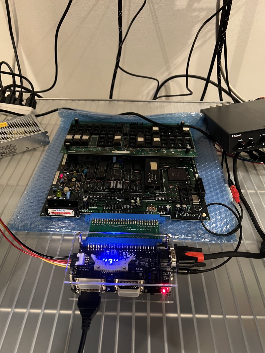

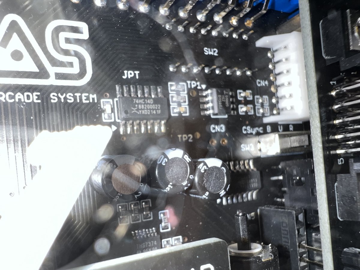

Hi all. I have the HD15 PCB on my HAS Supergun, and inputs / audio are working great. However, running a VGA cable to my Extron RGB 203 Rxi, which works with other RGBHV signals, doesn’t seem to work. It’s like the picture doesn’t sync.
Has anyone set this up? The CSync switch SW3 is set to “B”.

Looking at my HAS 3.2 manual, it sounds like you can toggle the csync switch between buffered or regenerated mode. The regenerated mode is meant to help with sync for Taito F3 pcbs or other pcbs with problematic sync. It might be worth trying. Double check your HAS manual.

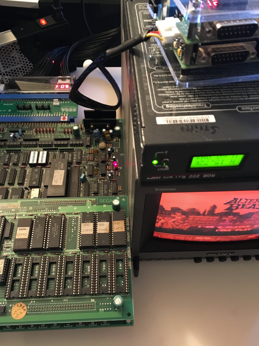

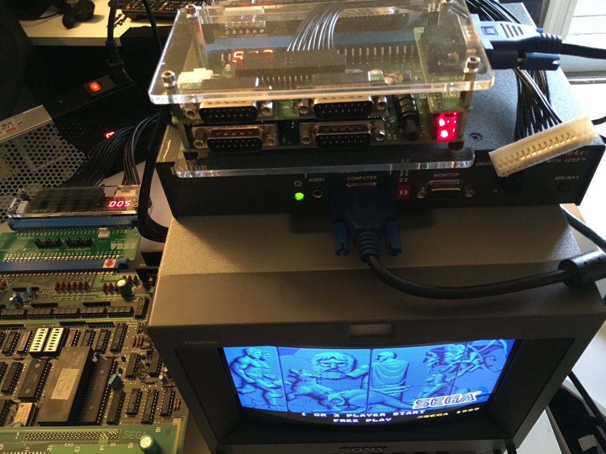

I just did a test with my Extron 164rxi to a Sony PVM-8041Q. I set my HAS csync level switch to output TTL rather than 75ohm. I set the sync processing switch to Regenerated (position A). Any other combination resulted in no image on the monitor.
I also have an Extron 202 rxi I'll test.
My Extron 202 rxi produces an image, but it's problematic. The unit accepts input through 9-pin connectors. I think my adapters are causing issues. Specifically, it looks like only the sync and red signal are getting through. Also, the weight of the adapters seem to pull the connection loose if I'm not careful. Although, I recall this unit and the adapters worked fine before. It's possible something was damaged.
Otherwsie, my red image is stable. Both Regenerated and Buffered sync types from the HAS work when it's set to output TTL levels. However, at 75ohm, only Regenerated sync works in this case. Otherwise, the Extron reports "No Signal" and no image is visible on the monitor.
Finally, I had all the dip switches on the Extron set to off. If I turn on the DDSP switch, I lose the ability to use Horizontal and Vertical centering knobs.

I have an Extron 201 RXI
I’m getting “ no signal “ on the RXI but looks like it’s having sync issues.
I’ve tried a HAS 5.0 by changing to TTL , and filtered etc. All look the same?

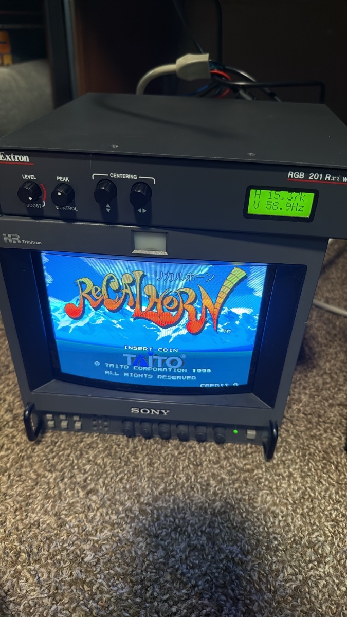

Going to try Dreamcast tonight with something Native.

I have a few extron RGB interfaces along with the 201 Rxi
Everything works fine last time I tested them two weeks ago
I've used a Dreamcast, Atomiswave, NAOMI, PS3 HDMI to VGA and I believe my XBOX 360
Also fed the OSSC into it as well
