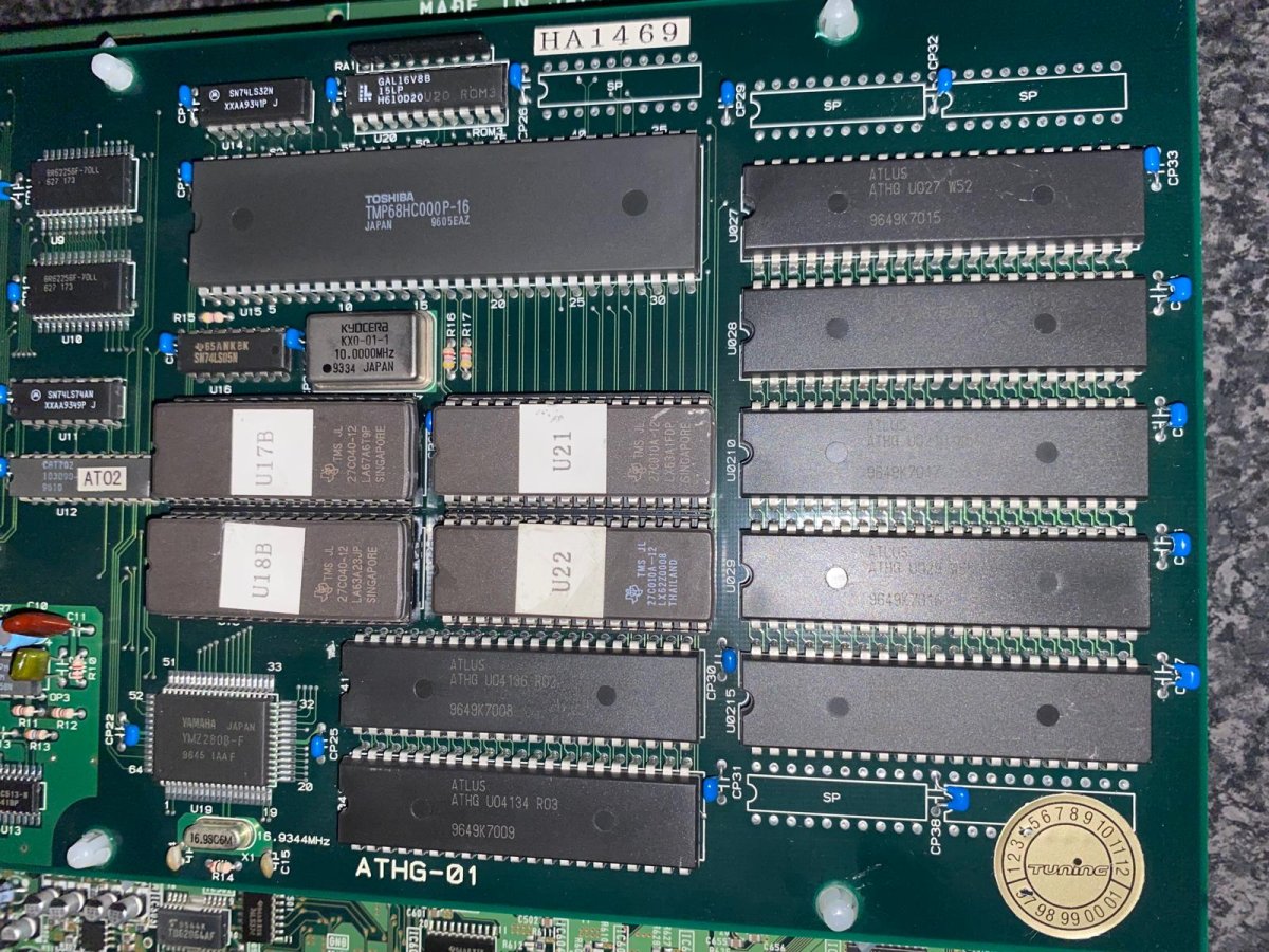

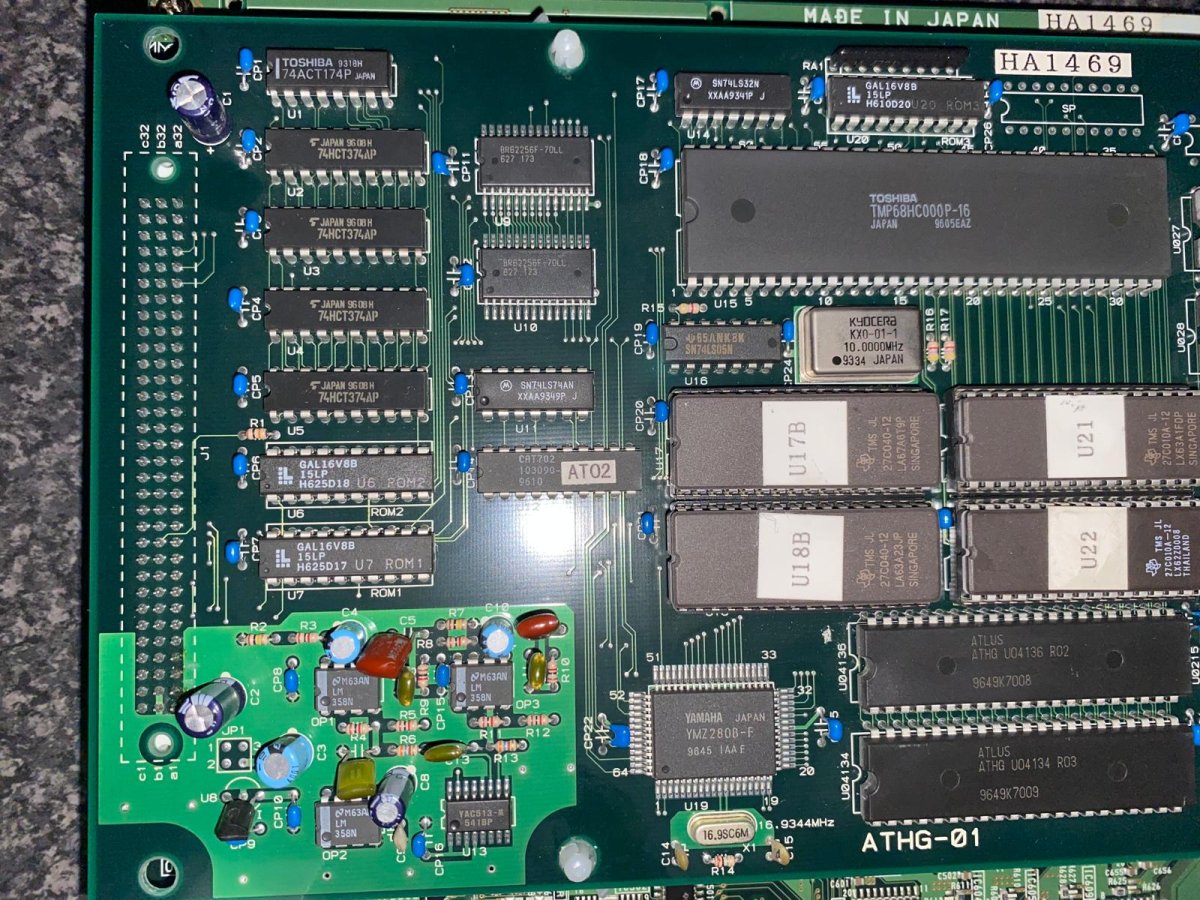

I fired it up again and had some burning smell coming from the PCB but game still works without any new issues
Some pics.

Without a scope it will be tricky to debug!
First stop would be scope at the OP-amps in the left corner.
Any chance you could dump the 27c040's? (17b /18b) these seem to be a new version?
The 2 mask roms next to the YM. but if they were dead you would get crackling noise and or corrupted samples.
Problem will be op-amp area, YM, or the 68000 and it's ram / pld's. (or a dead line etc)
Without a scope or something to probe the sound it's a bit of a crapshoot...
