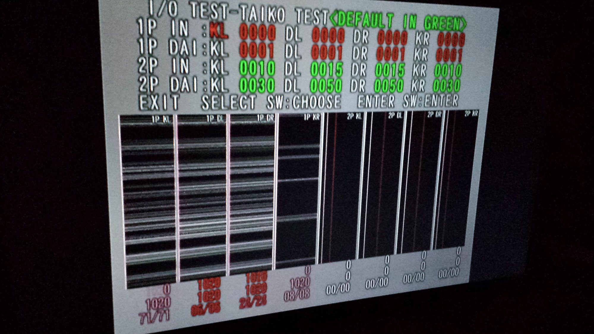

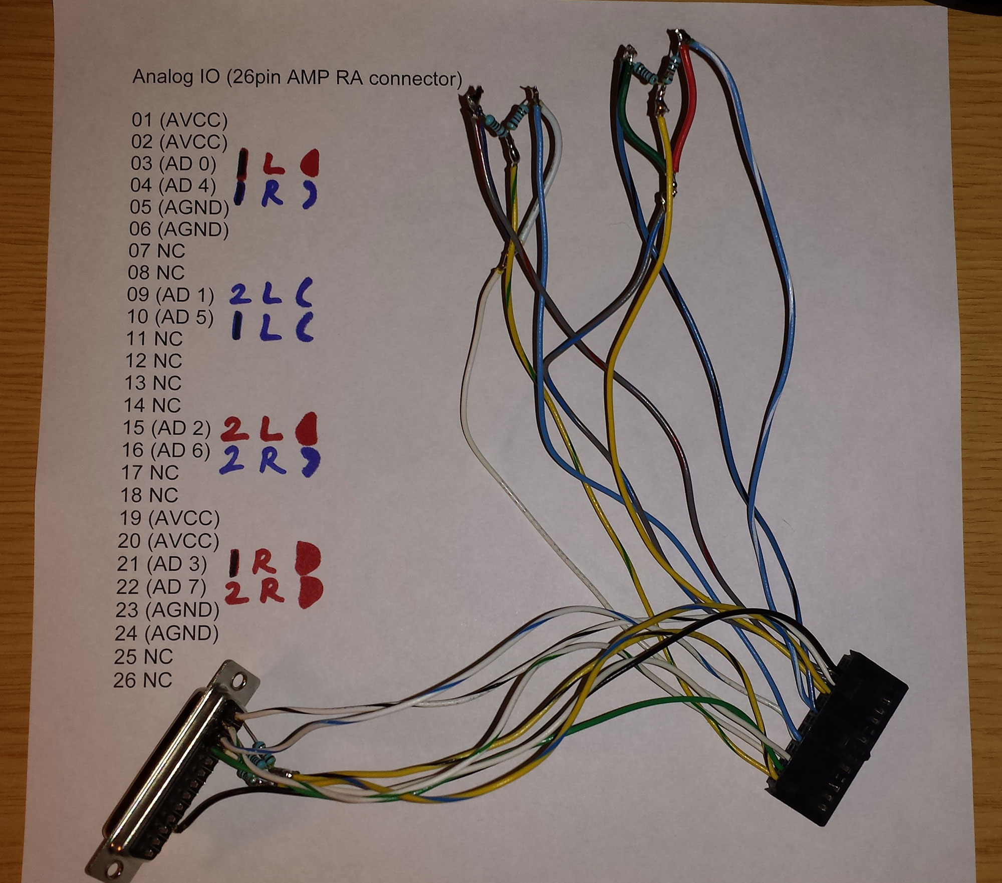

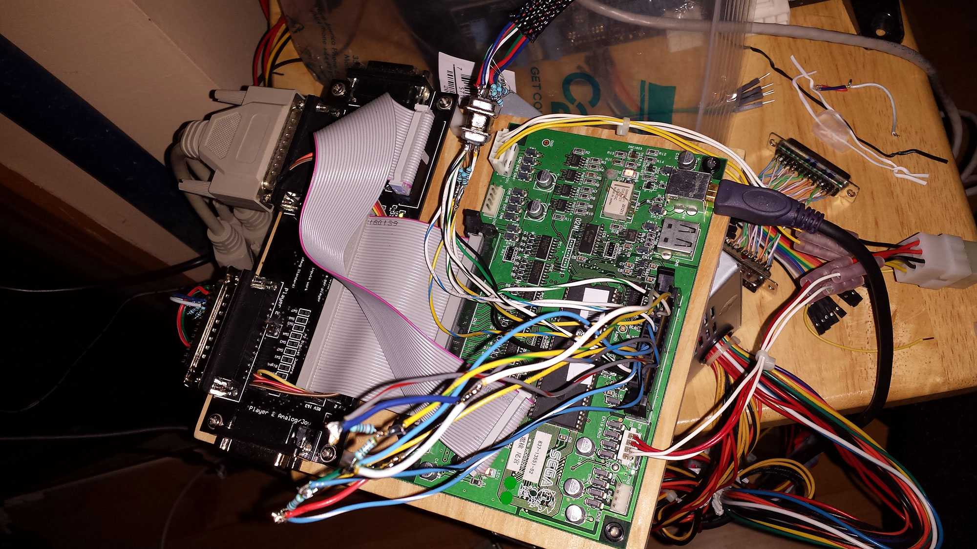

Still no luck getting the Player 1 side of Taiko no Tatsujin to be playable as I'm still getting auto-firing drum hits. But I made some progress.
I took a 26pin AMP RA Connector and, through trial error, managed to figure out the JVS analog mapping that a Taiko drum used on the Namco 246/256. I was also able to finally fully ground the Player 2 side and that is silent and no longer fires on its own. As I mentioned, I can't seem to get the Player 1 side to stop auto-firing. (It will stop if you ground the inputs, but that's not the goal.) I may just have my Taiko drum controller hooked up wrong, but I'm at a loss for how to proceed at this point. Ideas?
Helpful info:
The JVS button mapping for Taiko no Tatsujin is as follows...
AD0 = player 1 left drum
AD1 = player 2 left rim
AD2 = player 2 left drum
AD3 = player 1 right drum
AD4 = player 1 right rim
AD5 = player 1 left rim
AD6 = player 2 right rim
AD7 = player 2 right drum
