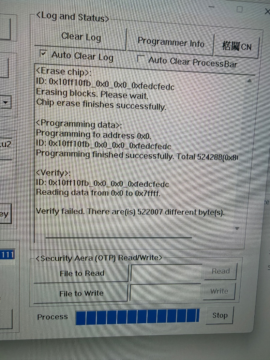

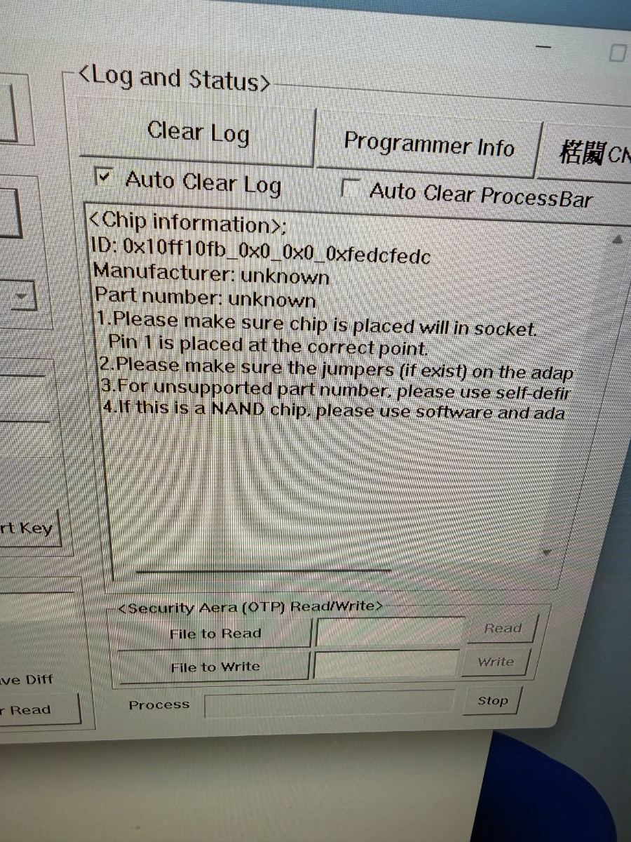

Hello guys, i am trying to flash the ultrabios using the Proman with the tsop48 adapter,but when i try click the Scan, it said Part Number unknown.
i have also tried to set the 512KB and 29 Series, it seems able to recognize it but still unable to flash it
do I need to set any jumper?
thanks
ok found out the tsop48 adapter does not support 5V. will get an adaptet and try again
