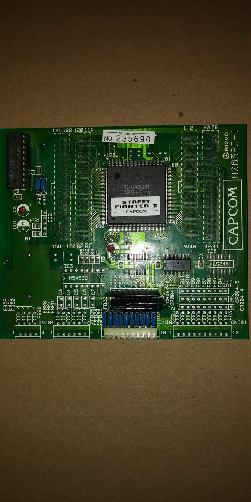

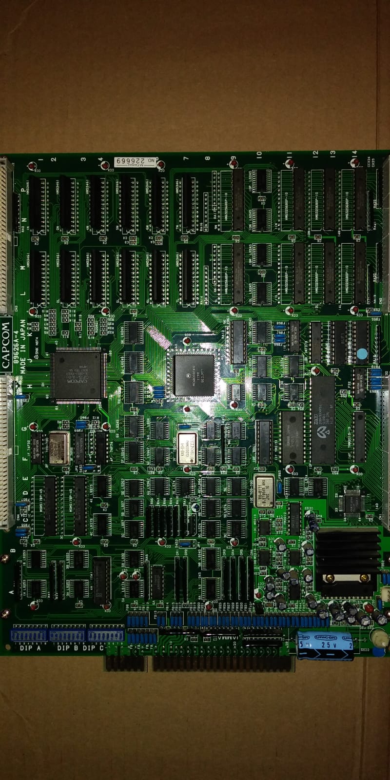

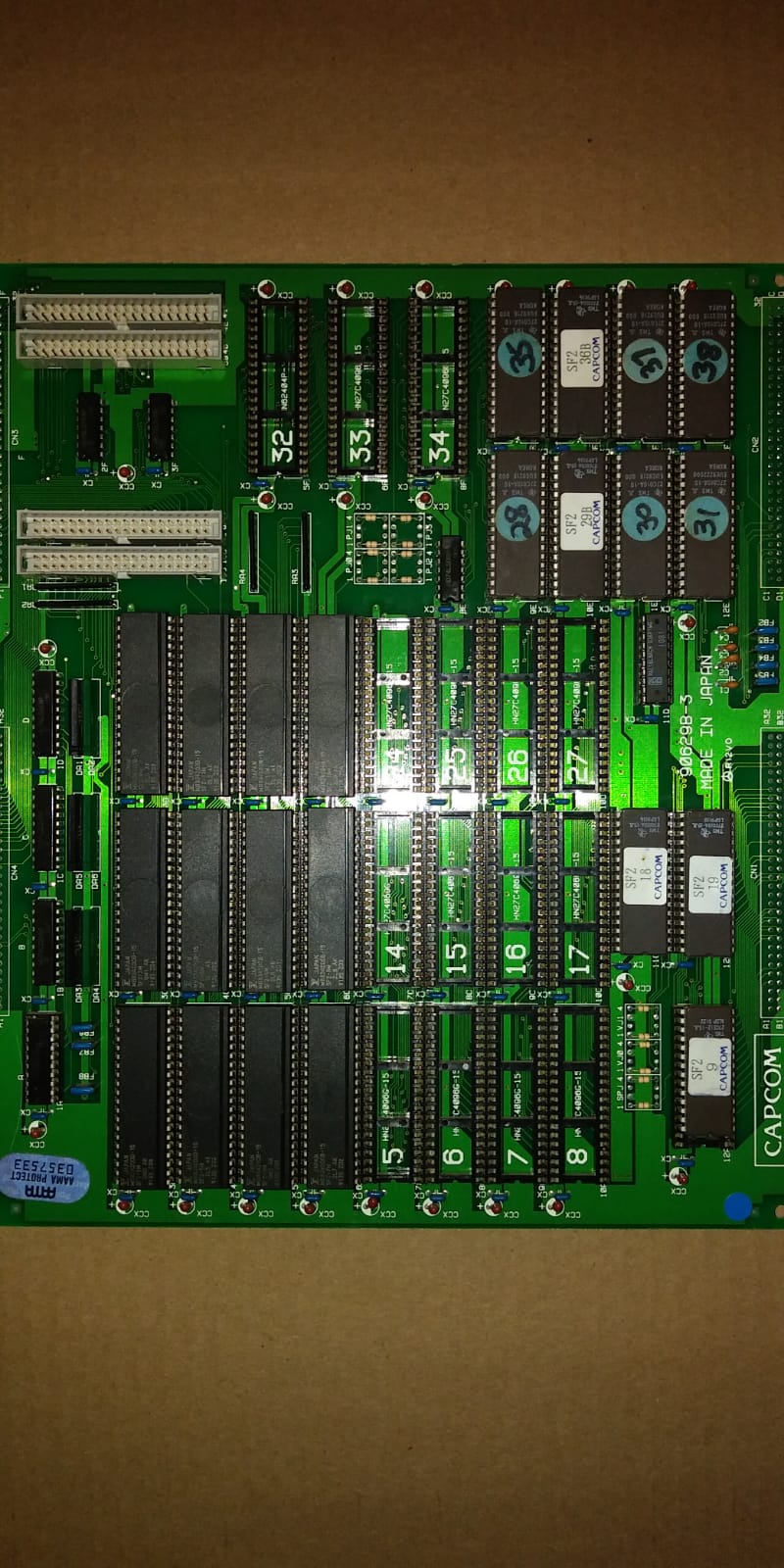

**HELP** Purchased CPS1 Street Fighter 2 World Warrior Jamma PCB
A B C added again.
I checked your video when you say the sprites are glitching do you mean how the fighters appear in a different place all of a sudden? If yes thats how this hack originally behaved. Also the inverted color on the cyclist in the Chunli stage is how it was with the hack back in the day. Didn't see Zangief's sprite issue (in the photo) in the video. This looks like a properly running hacked version of SF2WW.
NO, the Zangief upper body flickers Yello but then if you reboot the board... it is okay... functioning SOLID and Normal.
I'm not able to zoom in enough to be certain, but it does appear that the ROM1 pal has been replaced. It's the one with the sticker on it, below BUF1. If there is no clear "ROM1" label on the PAL, then it's a safe bet that it will need to be replaced.

He's got an old revision - 90629b-3. 27c4096 is printed under the sockets, as you can see in the picture. Rev 91653B-2 used 27c400. Please explain if I've get it wrong.

My "27C010s" Arrived, so I burned the 6 ROMs with TL866II Plus
28, 30, 31, 35, 37 and 38
Just curious, Do I need to burn "iob2.11d" and "c632b.ic1" ?
Took the A-Board ROM1 from the new faulty board and boom "Street Fighter 2 World Warriors" is Alive.
