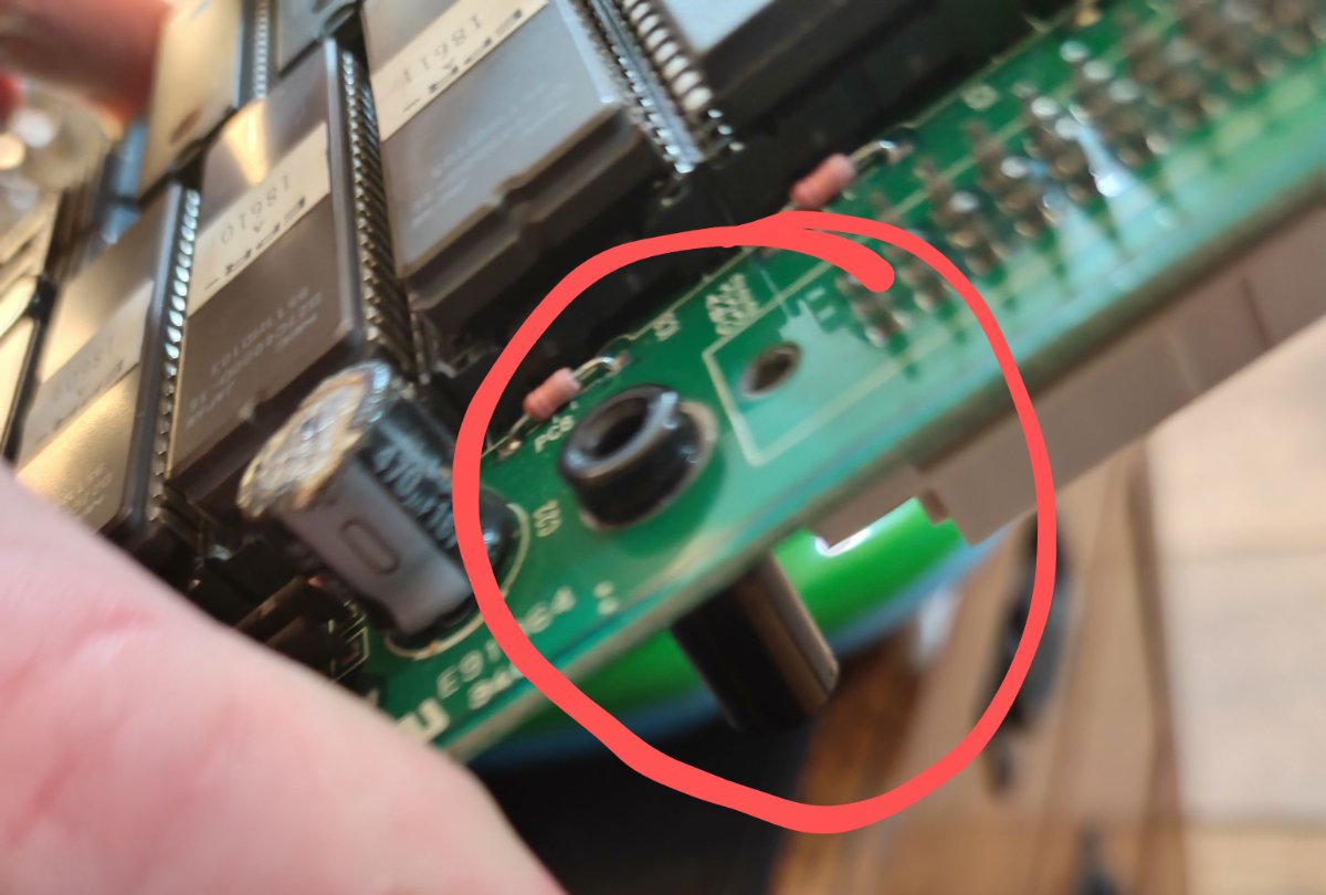

Hello everyone. I am swapping a model 2b rom board and the board I am swapping it with does not have the little black peg that fits over the center screw holes. I can rotate it but it does not unscrew. I want to do a part for part swap since I don't know if it's there to prevent any kind of short with metal touching something else.
Does anyone know the proper name for this part or where I can source another or even how to remove it from the other board?

I've emailed to them and bought it directly from them since I couldn't find any other way. Major local and international electronic components distributor like Digi-Key didn't carry them at that time and looks same today.

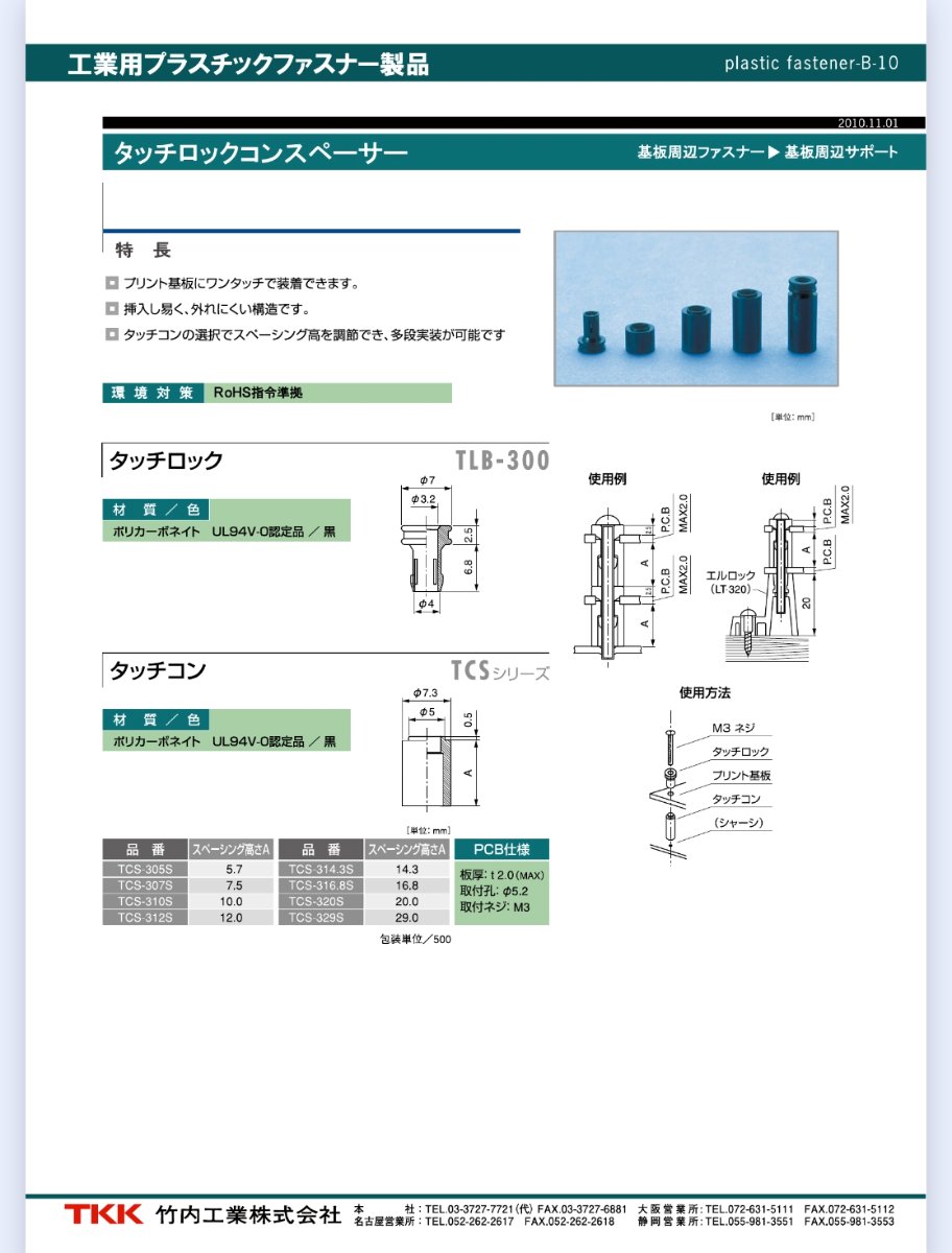

Hey Alpaca, good news! They are able to ship them to me.
Question: do you know the part number of the part for the model 3 board? I know I need the TLB-300 which is the touch lock. But I can't tell the length of the tube You mention 13 mm but I only see 12 and 14.3.

Cool! Good to hear that they can ship them out to you :)
13 mm… Hmm that looks like my typo, sorry for the confusion.
Here is the list for my SPIKEOUT FINAL EDITION. I think this one uses the most across all Model 3 step 2.0/2.1 upright title. They may differ across title so count and measure for yours.
Inside GAME BOARD
  • ROM board
    • Top side: TLB-300, 3 pcs
    • Bottom side: TCS-314.3S, 3 pcs
  • CPU board
    • Top side: TLB-300, 5 pcs
    • Bottom side:
      • TCS-314.3S, 1pcs (one in the center)
      • TCS-316.8S, 4pcs
  • Security board
    • Top side: TLB-300, 4 pcs
    • Bottom side: TCS-314.3S, 4 pcs
  • Communication board
    • Top side: TLB-300, 2 pcs
    • Bottom side: TCS-314.3S, 2 pcs
  • Video board
    • Top side: TLB-300, 1 pcs
    • Bottom side: TCS-320, 1pcs & LT-320, 4 pcs
Outside GAME BOARD
  • MIX-S board
    • Bottom side: TCS-310S, 4 pcs
  • MIX-L board
  • DSB2
    • Top side: Not used (instead, screw is used)
    • Bottom side: LT-320, 4 pcs
Hope it helps.

Thank you! You have been such a great help for this and I hope this information can now help others in the future.
