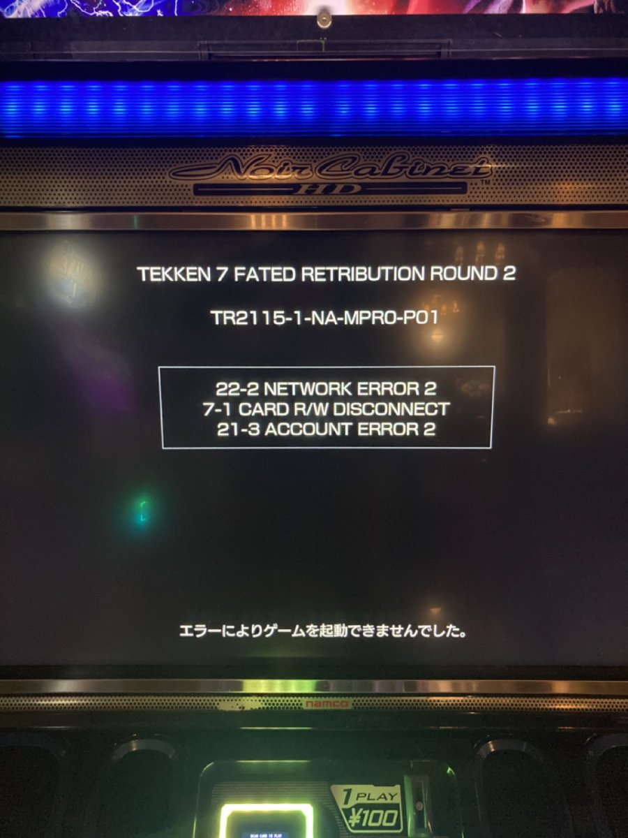

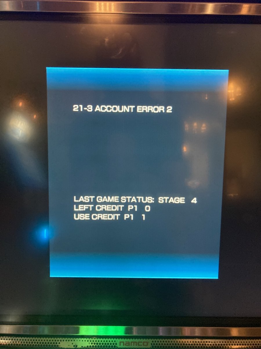

I've been running a pair of legit-hardware T7s in a public arcade for 4 months. Offline version 4.20. One of them stopped working with "account error" (see pics). It will no longer boot into the game and halts at the error screen. The cashless card reader indicates 1005 credits. It would seem the "offline build" is limited to 1000 credits?
In addition to fixing this issue, I'd love to get this game onto SSD. The original drives are super slow and can take 60 seconds of black screen to return to the title screen during normal operation or sometimes crash.
Will compensate someone who can help. Please PM if needed.

That’s not offline version if you’re getting 22-2 network error, which is a All.net/NBLINE server communication error. Seems like you definitely run into the “server points lock out” error.
Quote from Lost Land Adventure manual:
It is necessary to connect to the network (NBLINE) for operation of this machine. If there are any issues with the network connection due to communication problems, etc., “22-01 ERROR” is
displayed on the screen, and the game enters the “off-line operation state”. If 336 hours or more pass after entering the “off-line operation state”, it becomes impossible to start a new game.
In order to play the game again, correct the network problem, and connect to NBLINE.
Tekken is working the same way (or it's based on credit, but I think it was around 100 not 1000). Anyway, it's clearly not an export/offline version.
