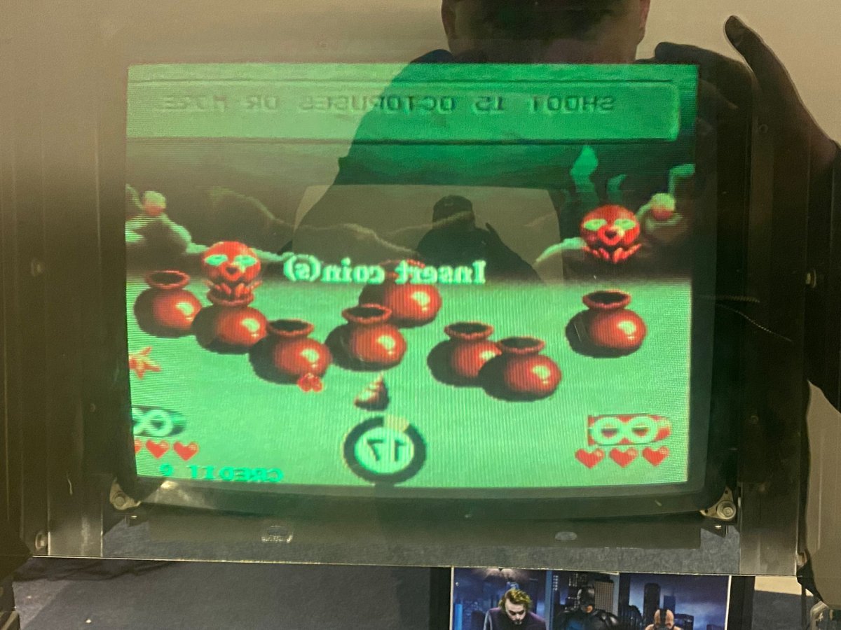

I've just installed a repaired Hantrarex polo in to a Point Blank I'm working on, and for the life of me i can't remember how you flip the image from left to right.
can any help ( see attach photos)

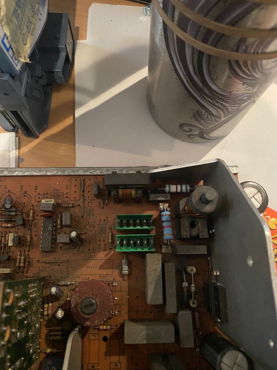

sorry mate its a Friday and my brain is not working, do you mean these to connectors were the scan coils are plug in to ( see attach)
I tried that and image just moved from bottom to top and not left to right

Those are connectors, yes. The other header should invert the image both ways, horizontally and vertically. Are you sure your monitor is installed correctly, and not upside down?
It's deliberately drawn 'backwards' since the game uses mirror reflection if I recall. The green plugs identified will essentially spin the image 180 degrees if it looks wrong installed.
