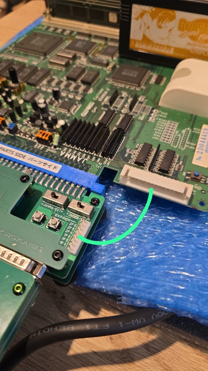

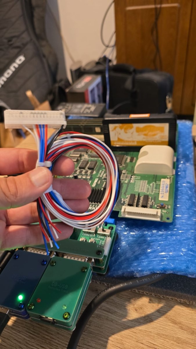

I received the CPS3 with 3rd Strike. I also bought from Axunworks "Arcade JAMMA SUPERGUN-MINI control board", "DB15 to USB" and a Scart cable.
Everything works like a charm!
The only issue that I have is that I bought the CPS3 with the hardness kicks cable but it doesn't have the other end. I can order from Axunworks the correct cable but he is asking 48 USD to ship a 16 USD cable.
1. Is there any way that I can use this cable?
2. How do I turn off the CPS3 safely? is it ok to just disconnect it from the power?

1. Yes you can use that cable but you need to join it to the supergun, ideally with the correct connector or solder direct.
2. Yes that’s fine.
48 dollars to ship a small cable seems very high, what you need only weighs about 25g and is the size of a Twix when wrapped.
But perhaps the shipping is insured and tracked.

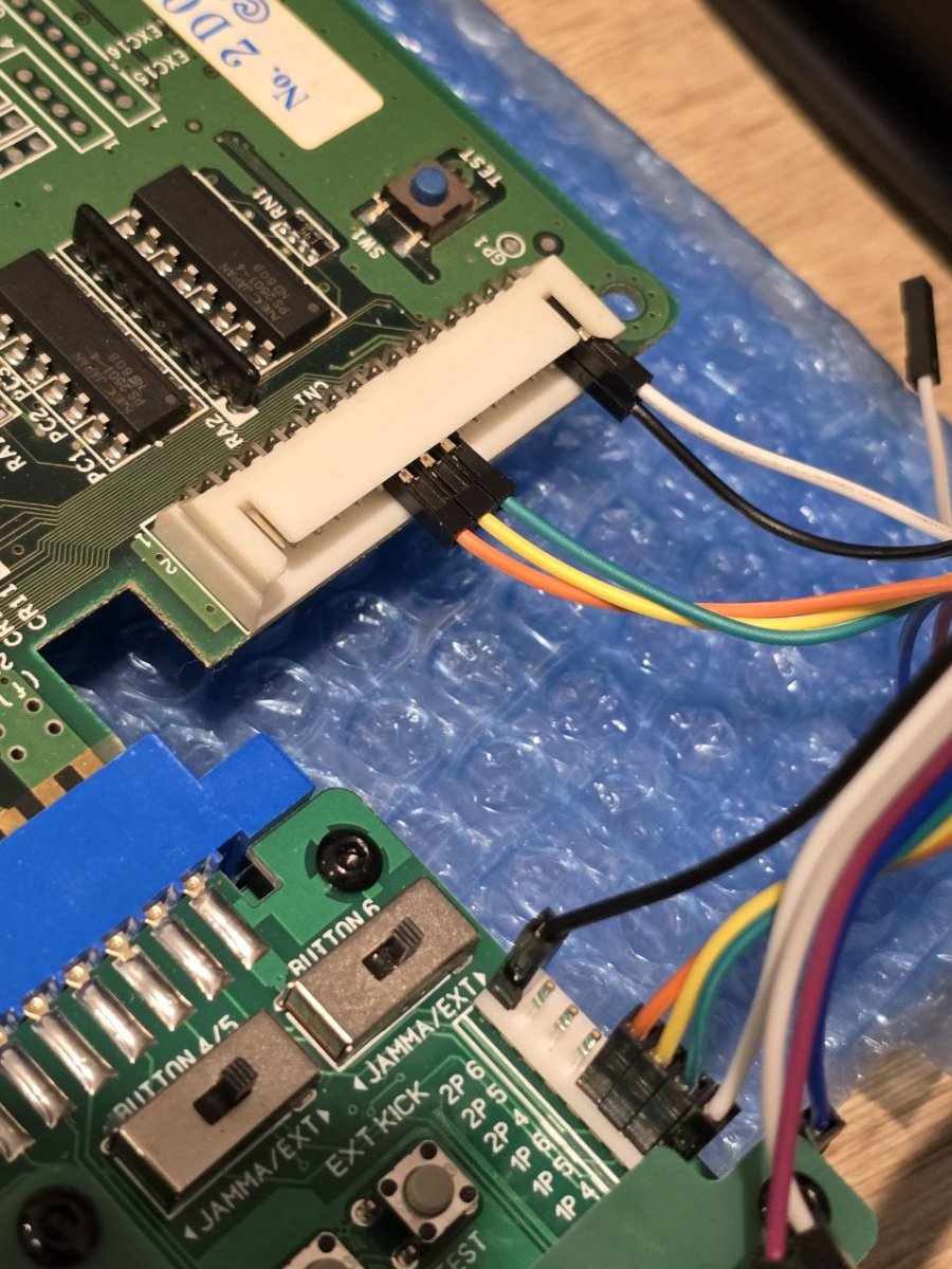

Since it's that close - I would just some female-female dupont wires.

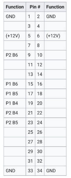

Have you tried turning off those switches marked BUTTON 4/5 and BUTTON 6 ?
Actually I think those are in the right position.. so not sure.🤔
It *looks* right to me - you don't need both grounds hooked up, just one... but it shouldn't stop it from working.
I am not 100% sure where pin1 is on the cps3 connector - what if you move them up to the top row?
You are correct! I moved them up and now everything works! I'm stupid for not thinking of that.
Thank you, man!
I connected Player 1 and Player 2 and it works!
