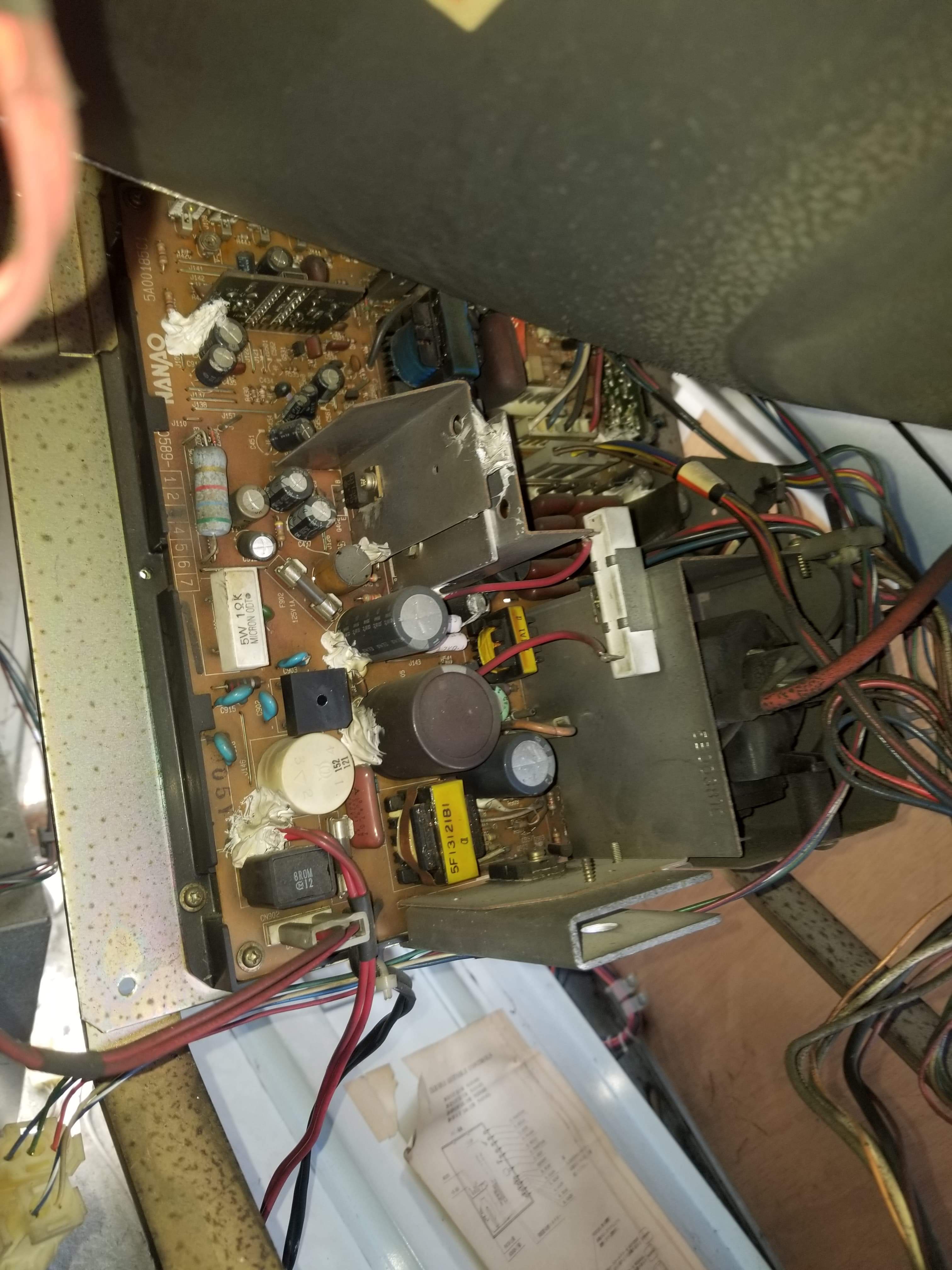

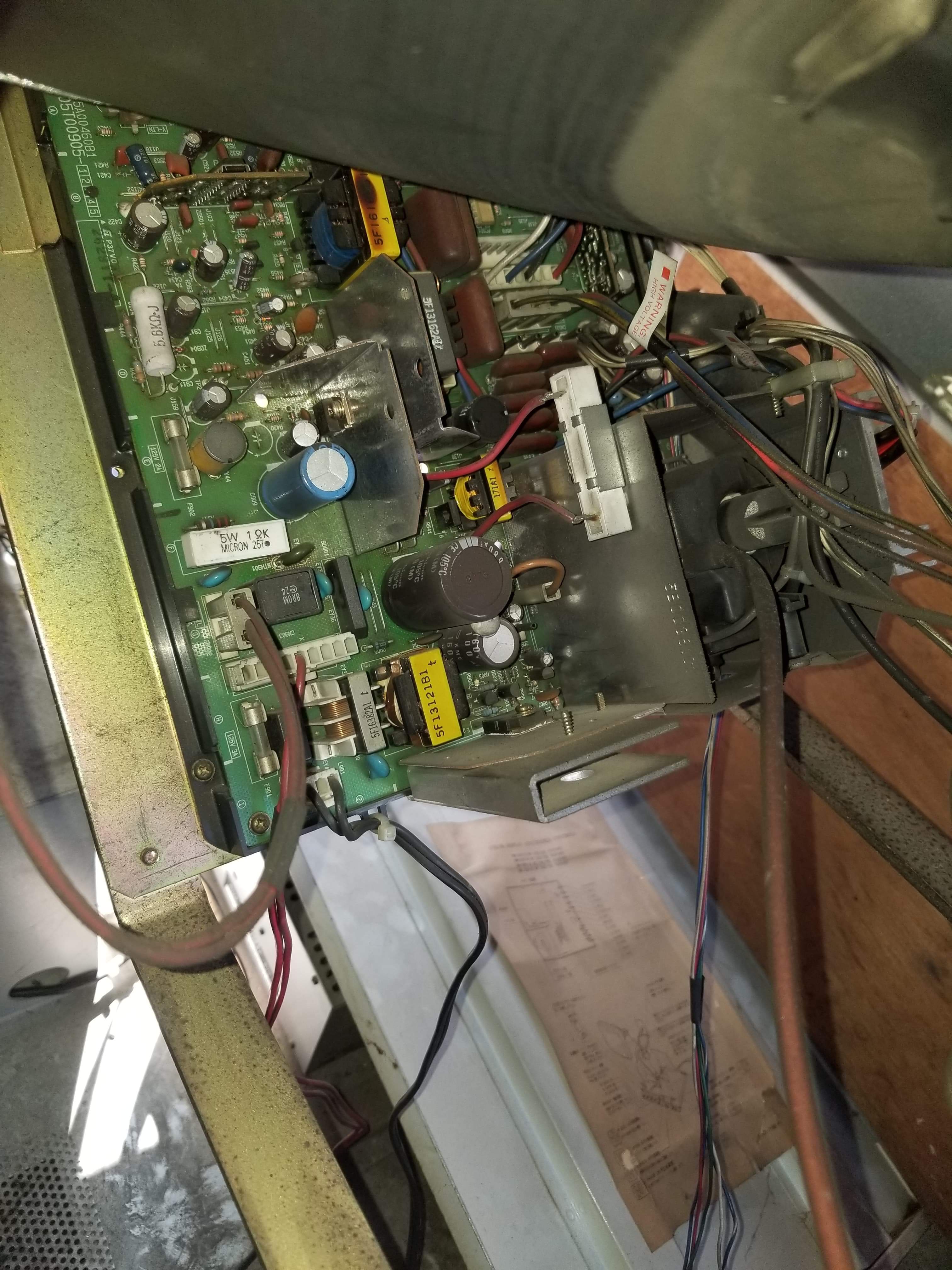

The other cab, which doesn't have a harness, has a different chassis but same tube. The controls are facing right on the pcb when looking from the back panel.
It also has a different frame, but mounts at the exact same point. I couldn't see the Neck pcb because it was behind the frame plate.
That's a MS8 as well.
All your cabs have MS8s.
Whoever passed on these cabs dropped the ball bad.
I guess they do fit mounted improperly after all.
There's always the possibility that the monitors didn't come from Aeros originally. Sega also used these in dedicated cabs. That could explain the different frame and why the chassis is mounted sideways. So it's possible the frame won't have the needed cutouts at the front for the controls.
Yeah those are ms8s with the chassis mounted weird. I have one with a brown PCB like that and the controls face forward.
So are you saying I can rotate the chassis so I can control it from the front? Sweet
I'd need better pictures to answer that. The Black tray the chassis sits in should only slide in one way to the monitor frame. However, on my MVS with the monitor replacement my chassis is held on with zip ties.

A lot of these cabinets had great looking monitors without burn, but of course covered in smoke. I suspect the original monitors were replaced during these cabinets' lifetimes, which explains them being a slightly wrong variant. The only significant difference would be how the frame mounts the chassis. On a normal Aero MS8-26, the pots face forwards. Having the side-mounted variant is a sign that it's a replaced monitor. On the upside, the replaced monitor is likely in great shape.
Yeah check out the wiring schematic here. looks like p1 is white p2 is brown.
You will need a white grounding wire for each switch, they are daisy chained into pin 9 of the connector. I assume if pin 9 is lower right corner then pin 1 is top left corner of your plug, pink wire?
Doesn’t matter which side you the switch you ground.
All four of the tubes have their MS8 tags on them.
That would be a dick move to transfer them to the replacements.
A brand new MS8 would have tags too. There is nothing wrong with a replaced monitor. There's just a good chance the operator that bought them from Sega didn't get the type intended for an Aero. If anything, this is a fortunate sight, as you ended up with tubes in good shape as a result!
