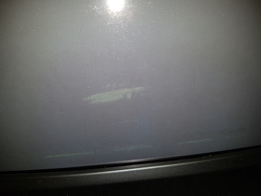

My initial problem was that big scratch

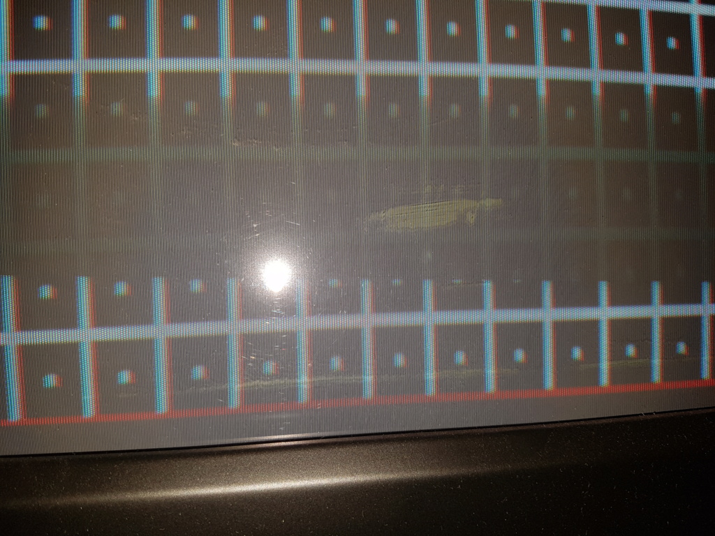

First i started polishing by putting a little polish in the corner and polish circle wise,
and this over and over again ...
After 1h ...
After 2h30 ...
Final result after 3h30 of polishing ...
At the end i discover nex scratch but we can't see them ...

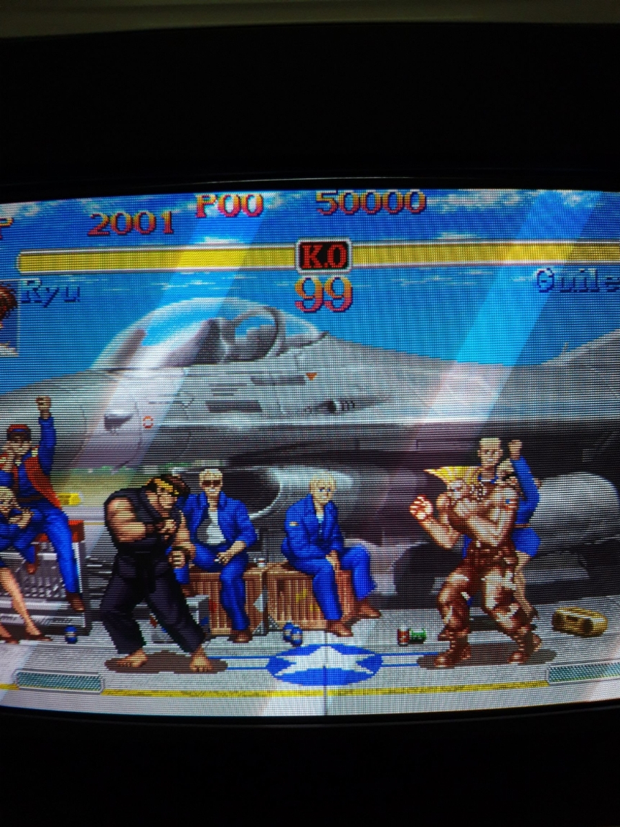

The game colours are more vibrant. There is of course a little bit more reflection
But I couldn't be happier
