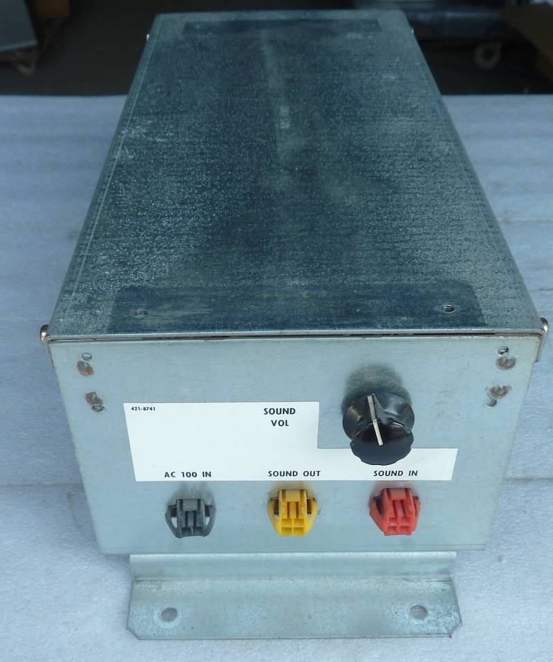

Hi, I have a new astro city with a stock jamma harness that includes this sega amp pictured below. Currently I have it plugged in but I only get sound coming out of my left facing speaker.
I was wondering if any special harness need to be made in order to just get regular sound out of both my speakers?
I bet it should work as is, you should have a problem elsewhere with the speaker/amp/cabling
If you look at my post on how to make a normal cabinet stereo, you should be able to work out where yours is wrong.
The little loop wires on the plug in the cp may be missing.
