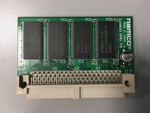

[align=center]The original WGN and WMR games shipped with a Driving chassis, equipped with a SINGLE 64MB RAM card.
ONLY 246"Driving" and 246A PCBs have interchangeable cache RAM slots to make this work.
System 246B and 246C boards do not, and likely only have 32MB onboard (I'll have to check)
!!!An option to finding a 64MB card is to fill the extra slot on the PCB with a SECOND 32MB RAM card.!!!
Neither game needs the Namco IO board or Force Feedback motor however![/align]
I can confirm that the game will work, using generic JVS input on either style 246 PCB, as long as the 64MB are present on the Namco board.
If they are not, the game will cycle through the attract movie ONCE, and hang when the Start screen should be shown.
The same occurs if you enter service mode BEFORE the end of the attract movie, then leave it.
It is HIGHLY unlikely that the RAM requirement can be hacked around, so either a replacement 64MB card, or additional 32MB cards would need to be found by anyone wanting to play these games, sorry to say.

If I were to do a repro of this, what would people prefer 32Mb or 64Mb?
If 32Mb, I'm sure they are very easy to do and memories seems to be widely available.
http://www.ebay.com/itm/LOT-OF-96-NEW-SAMSUNG-K4S281632B-TC1H-128M-SDRAM-8MX16-100MHZ-/301452155631
If we gather enough interested people who would preorder in total about 20, we could do a run...
I’m actually kinda curious to know if it’s possible to make reproduction RAM cards. I’m actually interested as I do have a Namco System 246 driving pcb and one of the extra 32MB RAM cards I bought has died, which means I can’t play Wangan Midnight. A 64 MB version would be nice to have! :)
