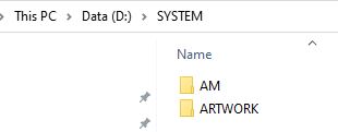

2. Extract to folder, I am using D:\SYSTEM\AM directory
While you are at it, create an artwork directory

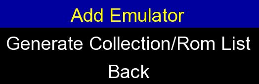

4. Go to Emulators, add Emulator, name it CAVE

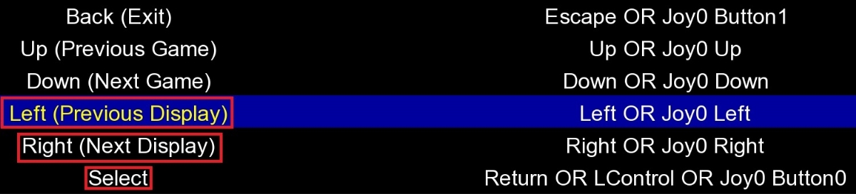

6. Go back to configure menu and choose controls. In here, change left, right, and select
7. Change the default action for left to previous page and right to next page
8. For Select, Add input and assign it to Q
9. Go down to Previous and Next Filter, assign W to Previous Filter and E to Next Filter

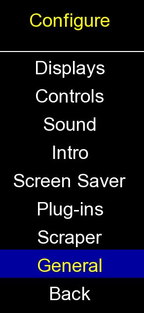

10. Go back to configure menu, go to General

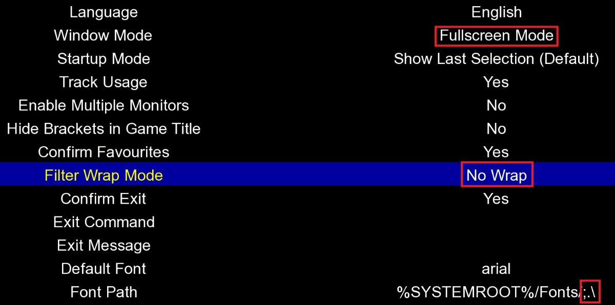

I choose Fullscreen Mode for the Window Mode
No Wrap for Filter Wrap Mode, this controls whether it goes back to your first filter after you get to the end or not.
Add ;.\ to Font Path to point to the fonts used in this theme
11. Exit the configure menu entirely and you should look like this:

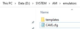

12. You can now exit Attract-Mode and go back to your AM directory. Navigate to the emulator folder and edit CAVE.cfg
13. Replace with the following:

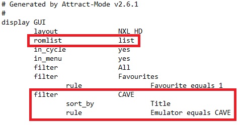

15. Go back to the AM folder and edit attract.cfg
Paste the following as shown here:
romlist list
filter CAVE
sort_by Title
rule Emulator equals CAVE

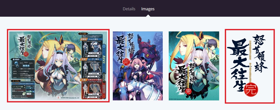

17. Go to https://gamesdb.launchbox-app.com/ or www.google.com and search for your game. Save some flyer/marquee images and the clear logo.
18. Put the clear logo in your LOGO folder

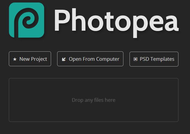

20. Go to https://www.photopea.com/
Drag template file to open it up

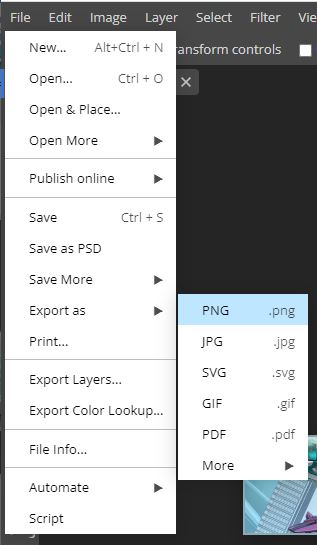

21. Drag your flyer/marquee image in and resize it. Make sure the border layer is on top if you even care about the border.
22. Go to File>Export as>PNG and save it to your WHEEL folder.

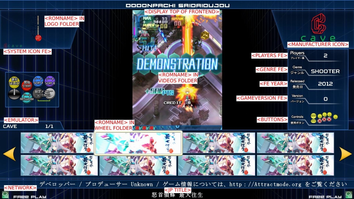

24. Start Attract-Mode again and it should look like this:
All this information is getting populated depending on what you put in your romlist as shown below.
<ROMNAME>;<DISPLAY TOP OF FRONTEND>;<EMULATOR>;;<FE YEAR>;<MANUFACTURER ICON>;<GENRE FE>;<PLAYERS FE>;<GAMEVERSION FE>;<BUTTONS>;<NETWORK>;;;<SYSTEM ICON FE>;<JP TITLE>;
If <MANUFACTURER ICON> shows up blank, put one in "D:\SYSTEM\AM\layouts\NXL HD\assets\publisher logos"
For <NETWORK>, any number > 40000 will turn the network icon on (Green)
If <SYSTEM ICON FE> shows up blank, put one in "D:\SYSTEM\AM\layouts\NXL HD\assets\system"
