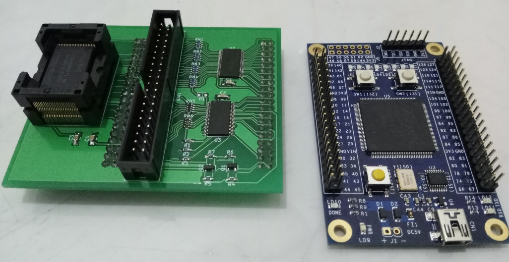

another board attempt iteration :
still no time to start coding.

I'd like to be hopeful they come up with something! I've designed a couple breakout pcbs and tests for experimenting with IDE/ATAPI, but ran into speed roadblocks with that design (using mcu+fpga). Got to loading files from DOS, but not streaming media above 4x. Since then I've been trying to learn about implementing 4Bit SD core within FPGA, along with DDR buffer and other fancy sauce parts I dont know how to use. The biggest problem is the mountain of software that needs to be written to design something like this, perhaps thats why nobody has done it...
would love to see some photos of your breakouts pcbs, please.. :D

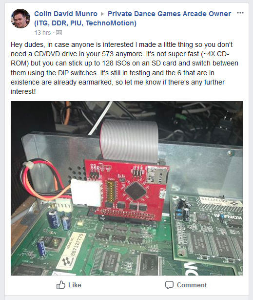

So I saw this pop up on my facebook feed earlier:
I of course expressed my interest in obtaining one to play around with :) no idea if/when these will actually be available or how well it will work in an application like the 2x6
iirc system573 games runs natively on 32x speed cdrom. and some games i knew, rely on the cdrom speed to play.
I honestly don't know or care about system 573 applications of this device. I'm more interested in it's use for System 246
