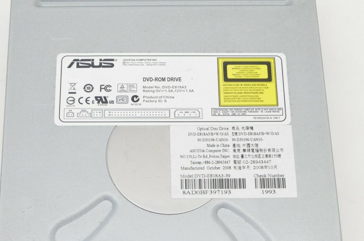

Just bought one on ebay now.... (new - opened but not used) hope it will works as you said...Can confirm the attached works in both my 246 & 256 setups, no issues running any game.

Can confirm too that works flawlessly on my 246.... soon i will try on my 256 tooCan confirm the attached works in both my 246 & 256 setups, no issues running any game.
..good to know because i've bought 4 more of them for 7€ each.I can tell you it works fine on 256![]()
This dvd drive works perfectly for all 246/256 games![]()

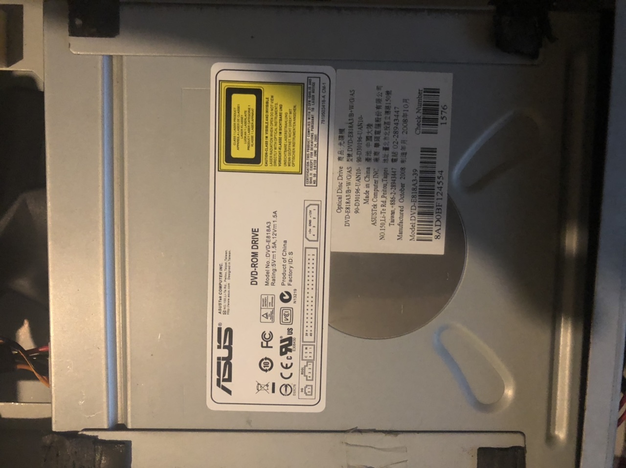

Seems to be like the same one, it should work perfectly.Hi, I need to replace the DVD Rom of my System 246 ... can you make sure this model works well? thanks![]()
