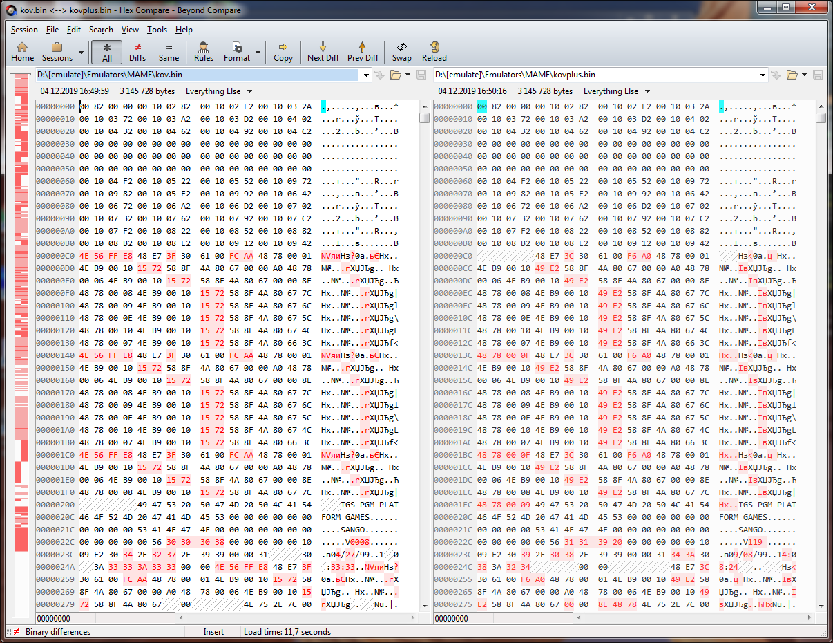

in reality, when comparing decrypted binaries from KOV117 vs KOVPLUS119 I see this, and I'd bet a lot of money on - it is really new game version/revision, not some kind of homebrew hack.
it maybe surprising to you, but internet is full of incorrect information (including Wikipedia) spread around by incompetent persons.
let's make Arcade-Projects bullshit-free! :)

You're comparing Plus to standard. Compare it to v117 which is what everything says it was modified from. Also number of IGM games with IGM mask roms and TAIWAN country codes???? Going to bet 0.
there is no dumps of KOV Plus v117. let us know if you have one.
add: also, IGS tends to use end-to-end versioning, so if exists KOV 117, KOV Plus expected to have bigger number - 118 etc
so, I'm personally doubt if KOV Plus v117 really exists

They do exist :)
On that site with the hacks you can find that there was a release with 115 and 117 in 三国战纪HACK版本合集01.rar. http://www.kuaihou.com/game/109983.html
I found some download links to the file on baidu but I don't have an account and that site is painful to navigate at best but if you want those builds, they're there.
Edit: have a friend grabbing the file, will post 115 & 117 later today/tomorrow.

these is a hacks collection, which may be numbered in any way, 117 or 1111111177777 or whatever.
in anyway, I see there no KOV Plus versions less than 119
also, mentioned earlier wiki page https://zh.wikipedia.org/wiki/三国战纪 have nothing about original KOV Plus v117. it says there was KOV v100 v115 v117, and KOV Plus v119, and number of hacks based on it.
in general wiki page looks like straight copy&paste information from MAME.
huh, it looks like you get something wrong. so please, stop wasting our time.
