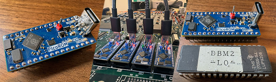

PicoRom is a DIP32 form-factor ROM emulator - up to 2Mbit in size and 70ns access speed
Github page here
https://github.com/wickerwaka/PicoROM
and cool writeup here
https://hackaday.com/2024/11/05/picorom-a-dip-32-8-bit-rom-emulator/
PicoRom does a bunch of cool tricks, but the coolest one (for me) is being able to connect via USB and push arbitrary data to it on the fly. My main use case for this is goofing off with NeoGeo carts but lots of other arcade hardware uses the Dip32 for various weird and wonderful EPROMS that are becoming hard to get or inconvenient to program.

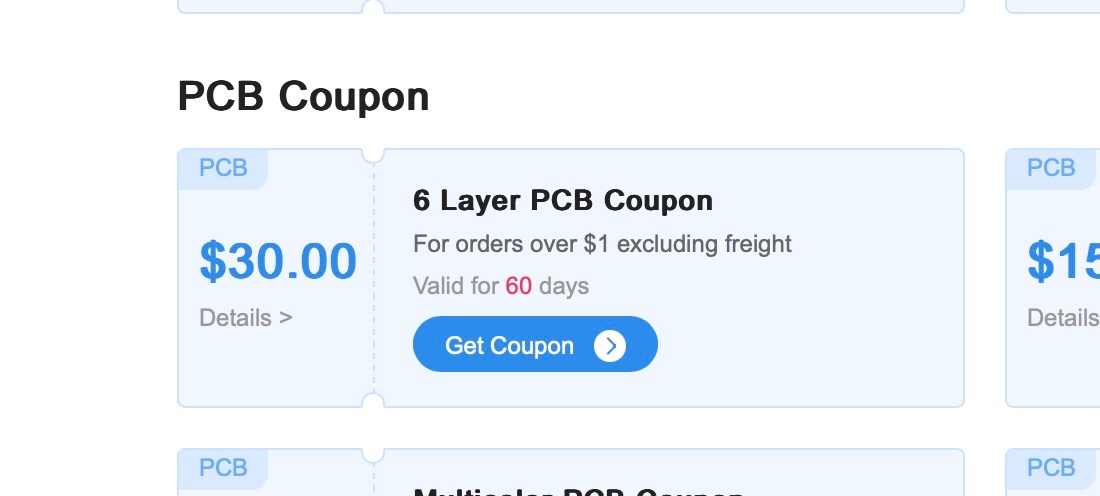

Version 1.7 (the most recent) is a 6 layer board - normally these are hilariously expensive to produce but JLCPCB currently have a promo for $30 off 6-layer boards so I applied that.
Unfortunately these boards are not particularly cost effective for PCB assembly - they are dual sided, and have many components that are "basic" rather than "standard". And several of the components were out of stock when I ran the job. So plan B is hand soldering and hot air.

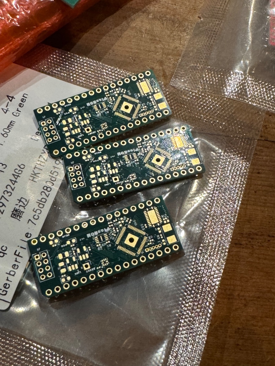

Let me know how the build goes! The design is optimized for size over everything else so it uses a lot of small and sometimes hard to find components. I have never tried to assemble one myself and I'm pretty confident I would fail if I tried. I switched to a 6-layer PCB after struggling to route a few final signals on the 4-layer version. The cost increase is pretty minor when you are getting 50 or 100 made at once (I've used that argument a lot of times to justify other BOM cost increases!)
Boards arrived today. I’ve never worked with 6-layer before, the quality is magnificent, it’s like jewellery.
I changed the USB header to 2mm IDC for these boards for my use case.
Will start work on fabrication shortly
