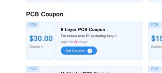

Version 1.7 (the most recent) is a 6 layer board - normally these are hilariously expensive to produce but JLCPCB currently have a promo for $30 off 6-layer boards so I applied that.

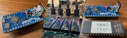

Boards arrived today. I’ve never worked with 6-layer before, the quality is magnificent, it’s like jewellery.
I changed the USB header to 2mm IDC for these boards for my use case.
Will start work on fabrication shortly

Hopefully not too much of a thread resurrection, but just to express my thanks to @wickerwaka for the picorom project. Despite my misgivings, I assembled them myself - decent solder paste, the correct stencil, stereo microscope and precision heat gun made it a rather enjoyable task. I had originally hoped that at least one of the 5 would work - but so far have 4 working examples. I adapted the design marginally to fit a different USB connector as I couldn't get the one specified. All other parts were readily available through either Mouser or Digikey.
It does exactly what I hoped it would do - removed the need for constant removal of the EEPROM from my 65C02 project to flash it. Adding it to the makefile in VS code complete automates the process. A picture below ( the additional wiring is to adapt the 32 pins to the 28 pin EEPROM that I am using, although I note that there is a 28 pin version now on the repo.
