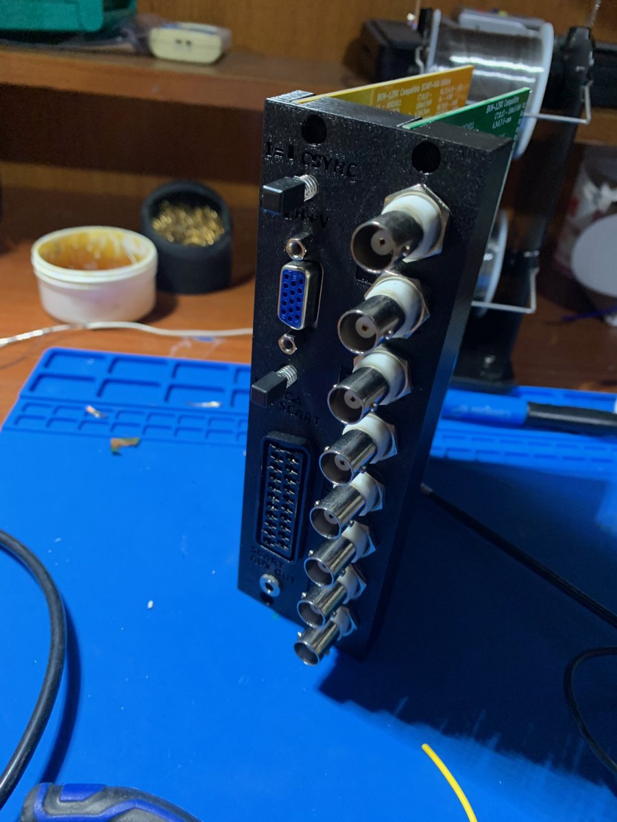

Did a test print of the double-wide bracket, pretty happy with that good, just a few minor tweaks and 6 more hours printing...

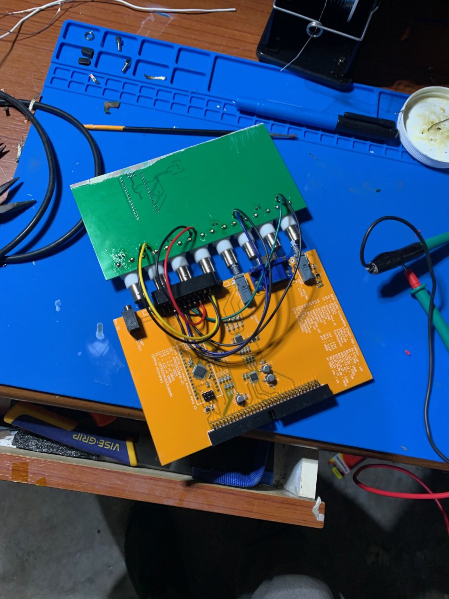

Then I'll need to figure out how to wire the BNC connectors on the "full size" card to the SCART pins on the "VGA/SCART" card.
I was wondering how you were going to do this. The main problem I could see is that the original 8x BNC board has the four switches to enable/disable the 75Ω termination on the passthrough so you either do away with those and live with always having to use some external terminators, but then they will likely interfere with the SCART lines so you'd have to take them off again, etc.
With my engineering hat on, what I was thinking of is to replace the current 4P2T VGA/SCART push switch with some sort of 4P3T slide switch so you can have VGA/SCART/BNC and keep each input isolated. Then have a narrow second PCB with just the BNC connectors and the 4x 75Ω termination resistors/switches and stack it on the main PCB with some standoffs and headers to pass the RGBS signals. I think the trickiest bit is finding a suitable alternative switch, assuming I've got the number of poles/throws right but I'm sure there'll be something on Mouser.

You're absolutely right, my current plan was to hardware the BNC output to open, terminate with external terminators and take them on/off as required. Being able to switch all the inputs and associated termination from the outside would be a much more elegant solution.
And also strongly in favour of the BNC PCB being a kind of sub-board that attaches nicely via headers. I think if we could do those things this would be getting close to "finished". Then it would be possible to have pretty much every single analogue input in the one monitor - how cool would that be?

Haha, it aint pretty, but it works as expected.
It was even less pretty when I discovered that the cage that holds the cards is about 2mm shorter on the right hand side than on the left, 2mm doesn't sound like much, but it meant that for all the ports to line up the card was not fully inserted into the edge connector. Clearly the only solution was to cut the back off the PCB.
But once its fully assembled it actually looks pretty darn good
Have been using this without issue for the last few weeks - great to have all the inputs, all in one place, all the time.
I probably would not make another one - there is a massive amount of manual rework, but I did have a lot of fun.

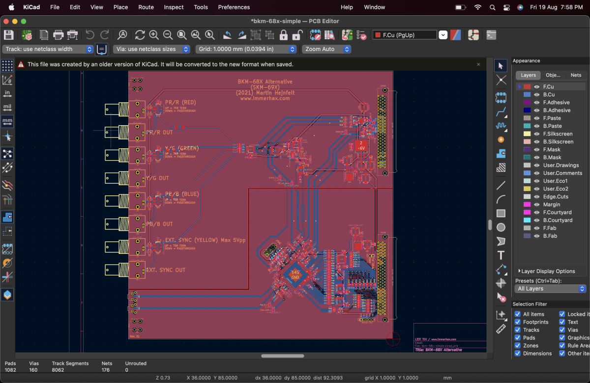

The limiting factor is that several of the parts are parts that are now impossible to get with the global component shortage. Suppliers aren't even accepting backorders any more, just... gone https://www.digikey.com/en/products/detail/intel/10M08SAU169I7G/5429537 and with the current ChinaUS tensions its possible that these parts will never be available to hobbyists again.
I started looking at merging the boards. Logically it's easy to do with a 4P3T switch, (I did get the poles/throws right!). However the hard bit is finding room on the back of the card for what is physically a larger switch than the current 4PDT push switch; there's not a lot of spare space.

I emailed Martin, the original designer of these clone boards, about something I'd noticed with the schematics and mentioned my plan to make an all-in-one card and he suggested maybe adding in an autodetect feature so the card will scan each input in turn for a valid signal.

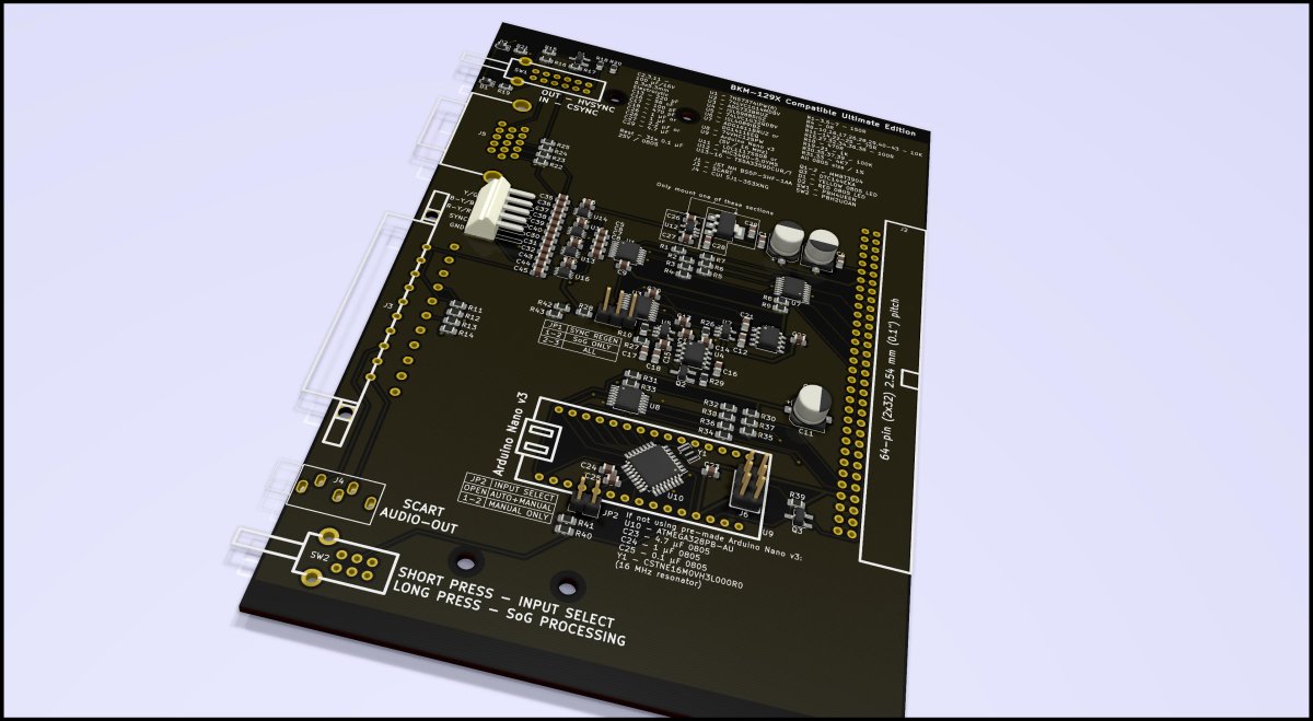

The PCB is 99% done, just some minor silkscreen tweaking to do. You can see there are quite a few additional components now:
Here's the smaller BNC input PCB that stacks on top:
I've gone for some JST NH connectors and a short wiring harness to connect the two PCBs together and 4x M3 brass or nylon standoffs keep everything bolted together.

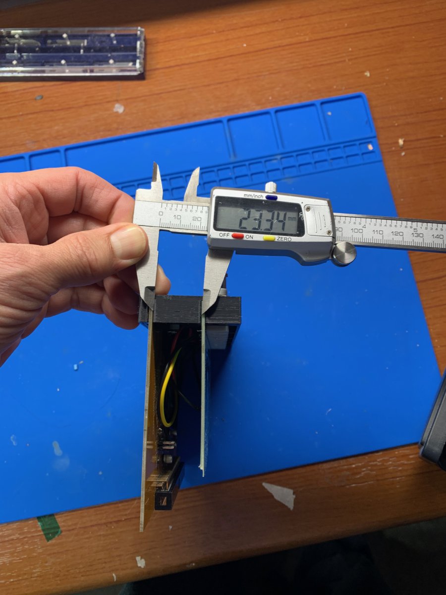

@hatmoose could you check the distance between the two PCBs on your stacked set? I think 24 mm standoffs might be about the right gap.

I modelled the gap between the boards as the same as the gap between the mounting holes which was 23.5mm
23.5mm feels like a weird number, I'm guessing its some commonly used imperial fraction?
3D printing is an inexact science so the way it came out in real life was 23.35mm
Sooo either 23mm or 24mm should do the trick.

Thanks. I stacked my two BKM-129X clones together by the brackets and measured roughly 24mm between them but the boards wouldn't stay parallel. For the sake of 4 standoffs I'll try and get both 23 and 24mm and see which fits better. It might be that one size isn't available anyway...

I think I've tweaked them enough, I just wanted to make sure I credited Martin somewhere on the PCB for the original design(s). I've set up a CI/CD workflow on Github so the Gerbers and BoM are built automatically. If you use a fab other than JLCPCB then let me know, I can possibly build an additional set of Gerbers tweaked for whoever.
The project is at https://github.com/bodgit/bkmm-129x-ultimate, just navigate to the releases and everything is there for both boards. I'll add the Arduino firmware and an STL file for the bracket later.
Just be aware I've not tested this yet so it might destroy worlds and/or PVMs.
