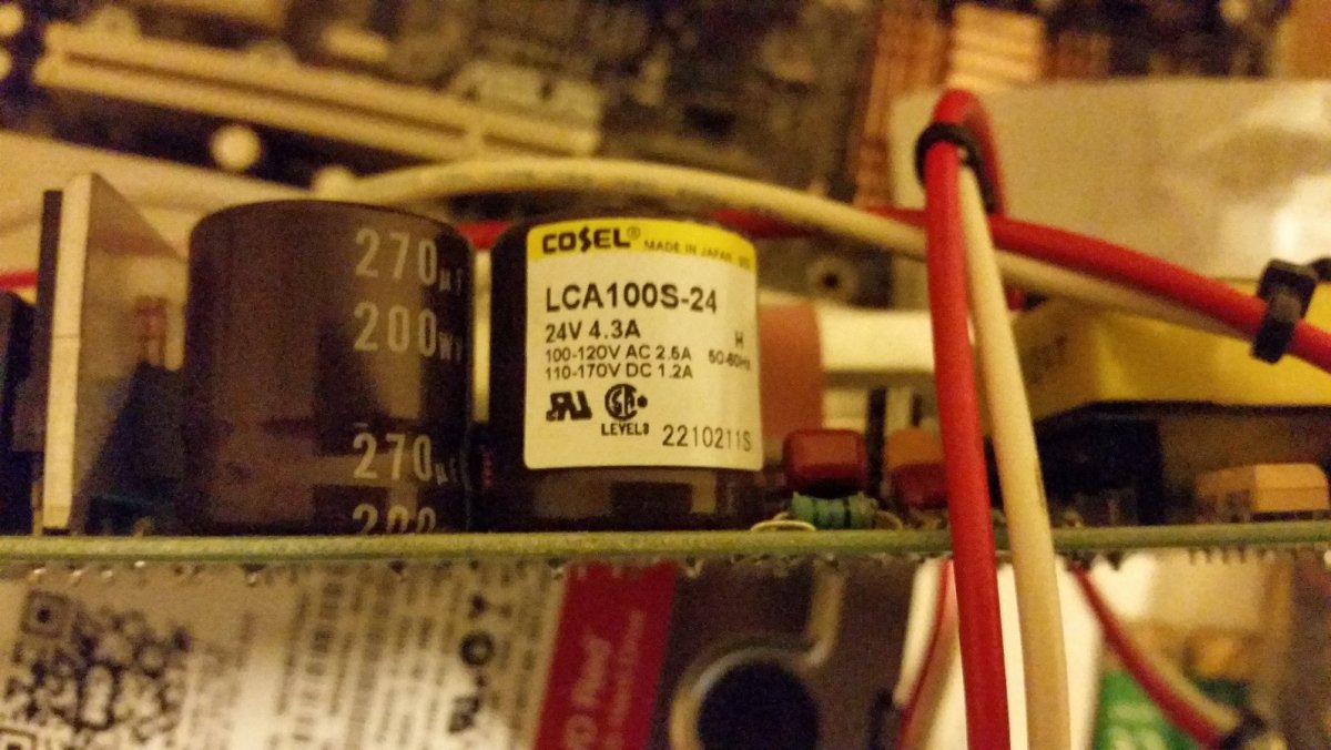

I use a Cosel LCA100S-24 PSU.
It uses JST VH connectors for power.
For the serial cable I used a cheap adapter from eBay and reused some stranded wire with the connector attached. It may have been repurposed from some old Naomi cabling? I can't remember to be honest. Sorry I don't know what the name of the connector that plugs into the card reader is.
