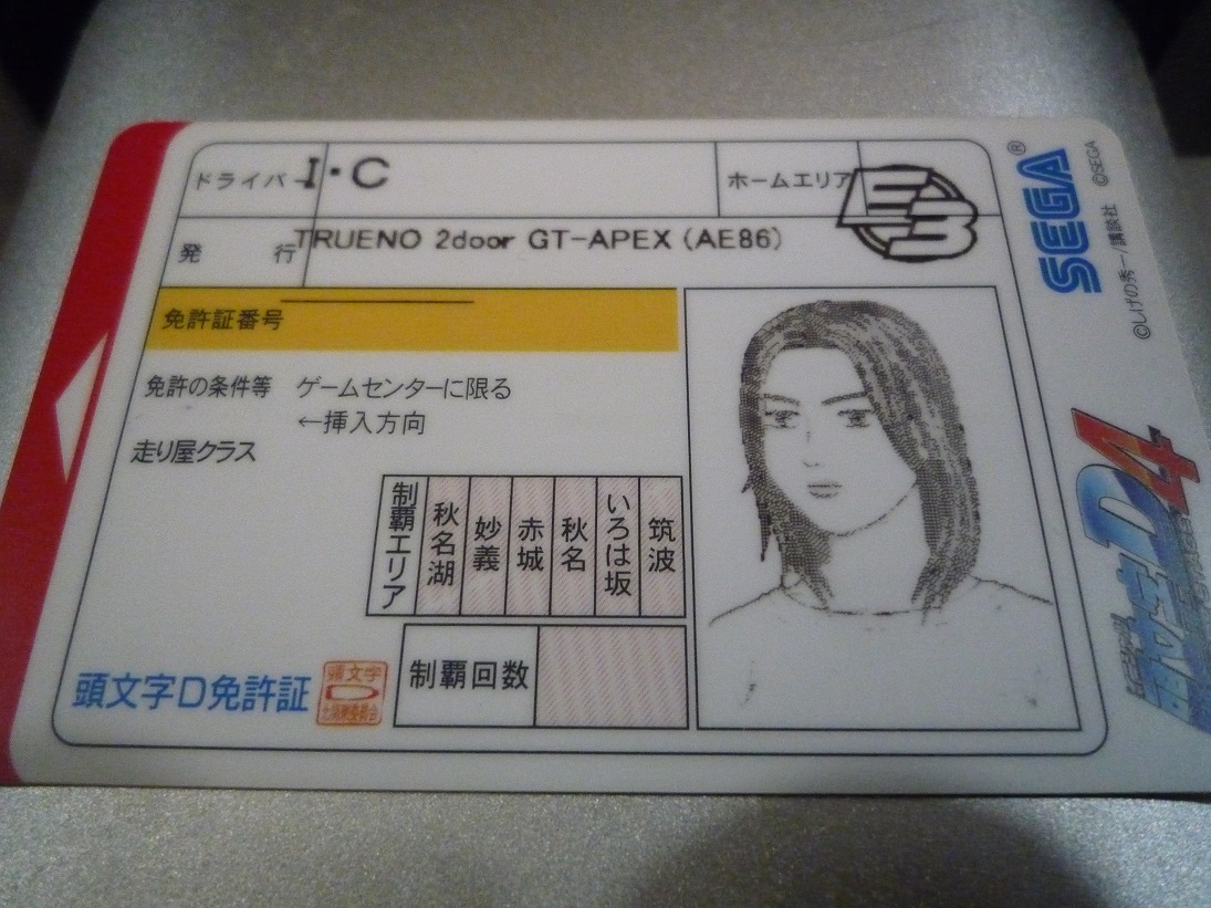

I've now had a chance to test an ID4 card with ID7 and I'm happy to report that they work fine.
I've not tested them with ID8, but may test one of the ID4 cards on ID8 when I've got ID8 setup again. I'm currently rinsing ID7 before moving onto ID8. :D
