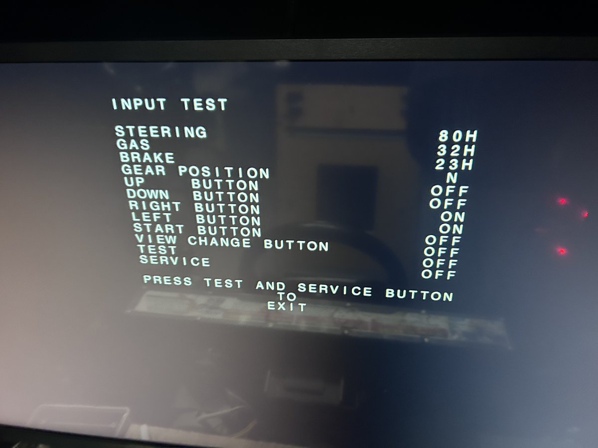

On my ringedge initial D6 cabinet the car select menu will not scroll when attempting to select a car using steering wheel. This is a converted initial D1 cabinet so it does not have the d-pad.
Installed a new steering pot and still same issue.
JVS i/o check shows analogue feedback ok and the game plays fine. Center position set to 80H.
Any ideas whats going on here?

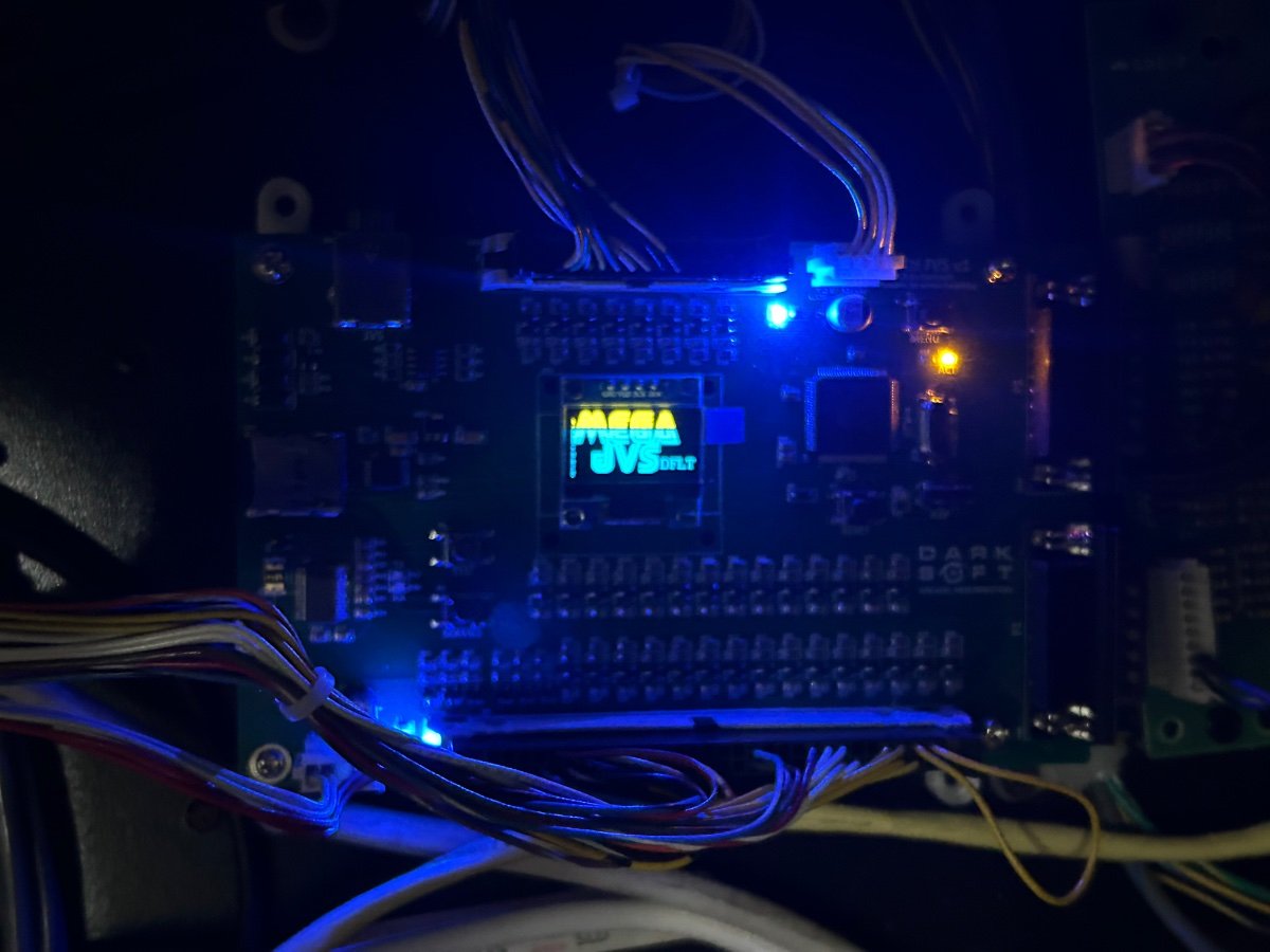

Looks like right and left buttons are always on. They are not even wired on the jvs 60 pin connector.
One of these fixed my game up good 👍
