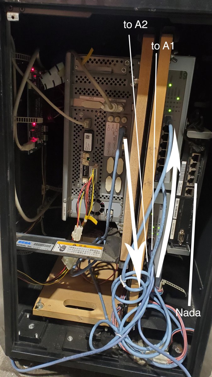

So if I don't need more than a switch for local play, I'll just power up this switch which currently has and connect the cabinets to port 1 and 2? And that should allow for in store/local play? So I don't need the ringedge PC connected to the cabinets for local?
Right now the Ringedge is connected to a switch (lets call it switch 1) which is then daisy chained to switch 2. Cab A1 and A2 were connected into switch 1. Switch 3, the small 4 port LAN switch currently has NADA connected;
You need the server… which you call the ringedge pc so plug it in port 3 of the switch was has the A1 and A2 cab
I plugged it in that way, still nothing on the link. They're pretty old network cables, maybe I need to replace them? I'm getting green indicator lights on the switch when I plug in the cabinets, so something is recognized.
I set it to in store vs, opened the other side panel of the server to verify that the server PC is coming on. Do I need to connect the server to my router so the machines can obtain an IP? Or is that not required for in-store mode?
