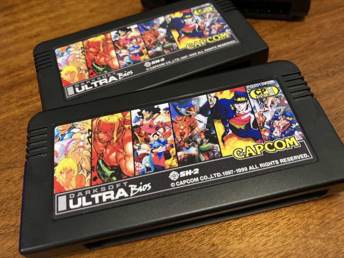

If anyone needs an UltraBIOS label for their cart, I recently had them reprinted, hit me up: https://www.arcade-projects.com/thr...lti-kit-labels-cps-2-cps-3-st-v-f3-etc.18226/
