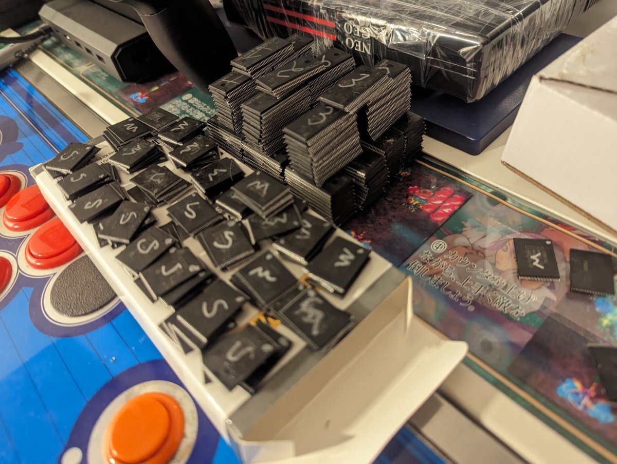

For this reason alone I'm never going to do a huge batch of these again.
3 14 hour days programming roms to make these little stacks...
Very thankful that there are only 15 AES carts to follow this, ha.
On the upside, wrist is feeling great, and ready to tackle the rest of this now.
