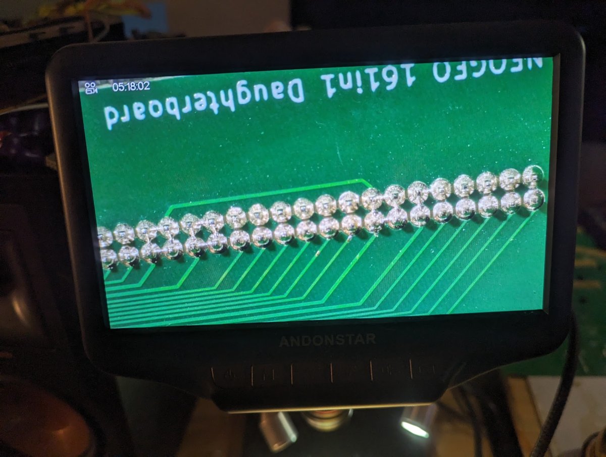

As should come to the surprise of no one, but yet still surprised me somehow: every one of the daughterboards that JLCPCB assembled is riddled with bridged pins.
14 bridged pins on this one alone...
What happens in a case like this? Is it tough shit for you or will JLCPCB do something for you?
Your guess is as good as mine. I have a ticket in with support, and they'll get back to me.
I did find some of these are connected on the PCB anyway, so no big deal those ones are bridged. But I have had to clean up 3-4 bridges per PCB so far. Which is defeating the point of shelling out decent money to save myself a ton of time.
