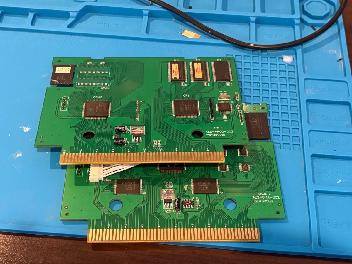

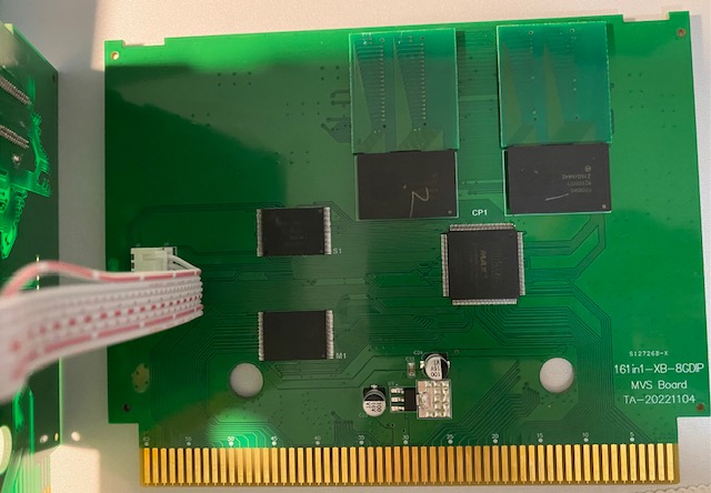

Here's a pic of the PCBs and the graphics glitch.
Unfortunately there's not enough room in that version to do the mod with the whole library.
These two chips on the CHA board are what you're looking at.
Check to see if any of the pins are bridged, and if not, then you'll have to reflow. Whether it's the chip to the daughterboard or daughterboard to the main PCB, you'll have to figure out.

You were correct on the chip issue. I haven’t gotten it 100% but a quick reflow from the daughter boards to the main pcb cleaned up some of the games. More skilled hands could probably permanently fix that issue.

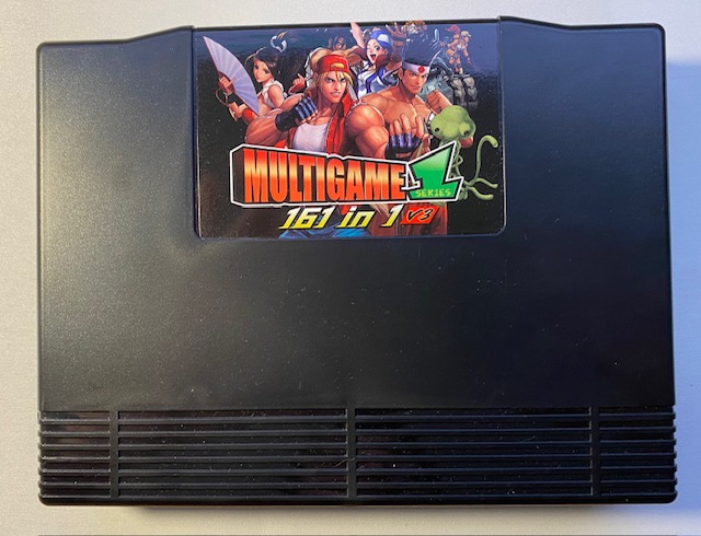

Hi! I have an AES V3 cart here

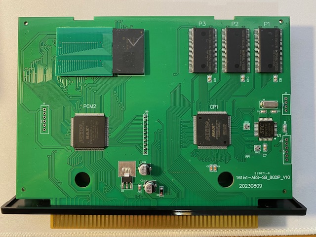

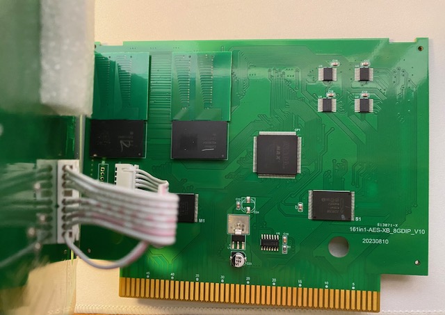

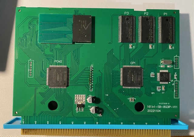

The AES V3's seem to come in two revisions. If you could kindly pop it open for me and make sure it does NOT look like this. You want the bigger chip on the left to be on a daughterboard, not this style.
This bad:
This good:
Let me know if you have the good one, and if so I'll shoot you a message and get the ball rolling :)
This bad:
This good:

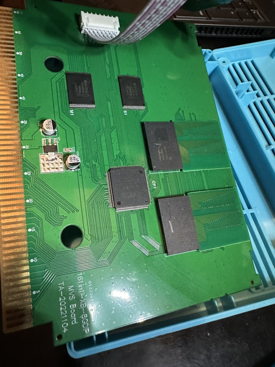

Ah.. I'm looking for AES, but that's good to know. Can I get you to reflow the solder on my chips? Seems like one game works, two get glitchy every time I touch it. ||
I'm happy to do that.
I'll shoot you a PM with my address. If you don't mind waiting a few weeks, probably into January, I will look into this type of PCB. I ended up with one here on accident and now if there are two of them it's probably worth looking into, but I'd like to finish up this set first. Shoot me back a "must have" and a "don't care about" list of games, and we'll see what fits on two chips and see how much of a pain these ones are, ha.

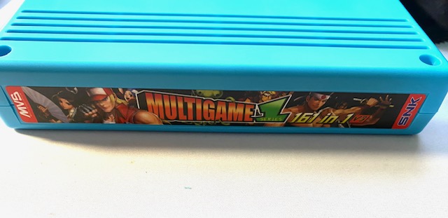

Post a pic here and we'll get you taken care of if possible! Label doesn't mean much so you'll have to pop it on open.
