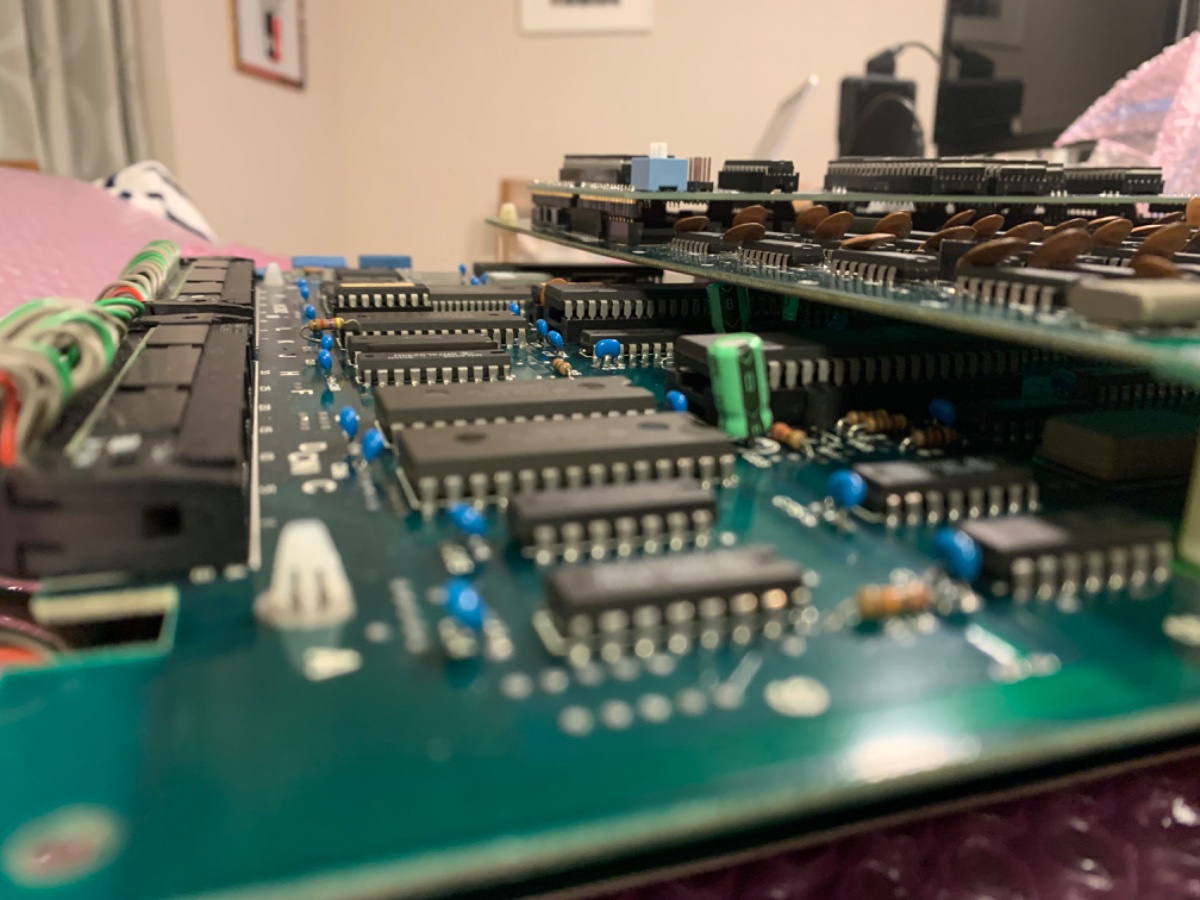

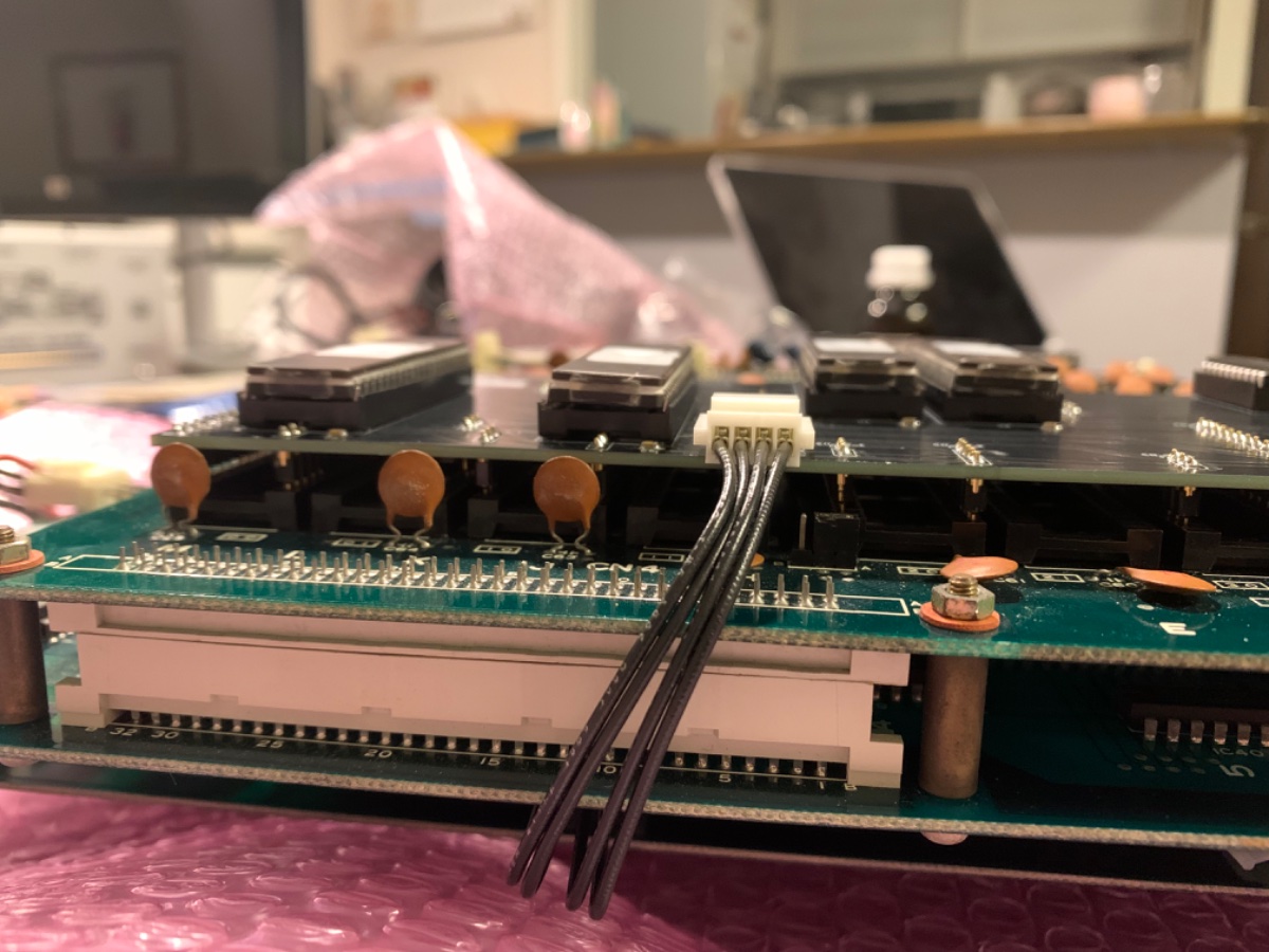

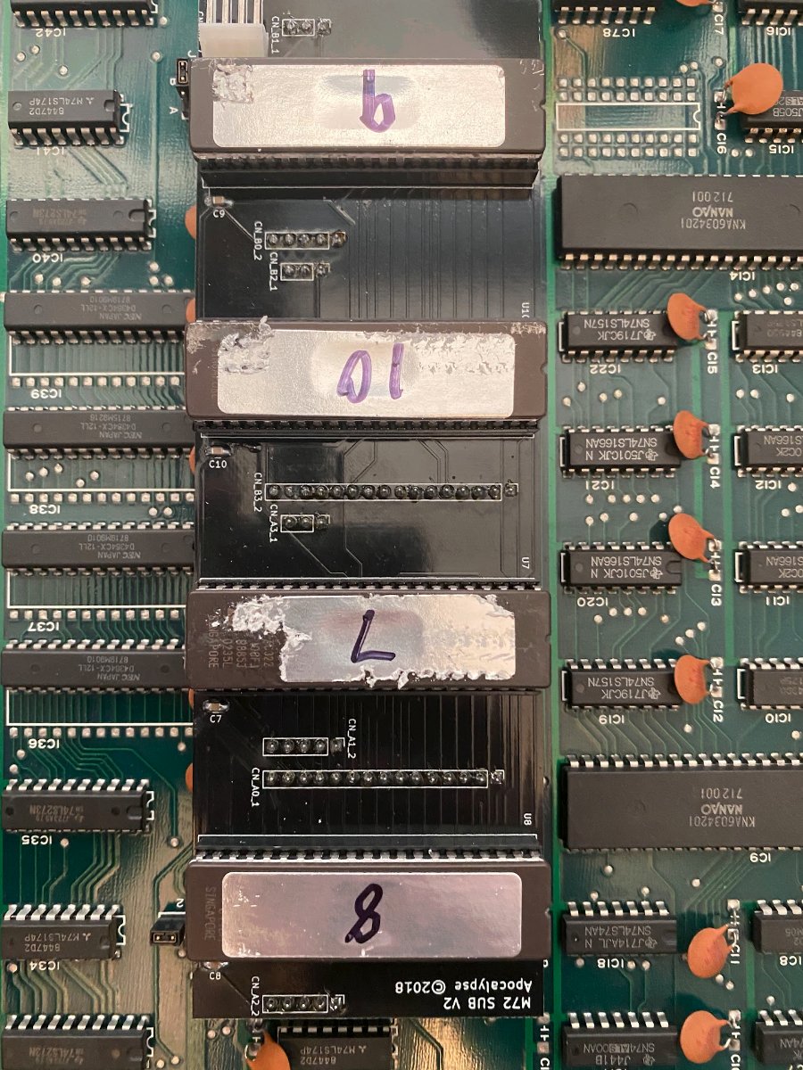

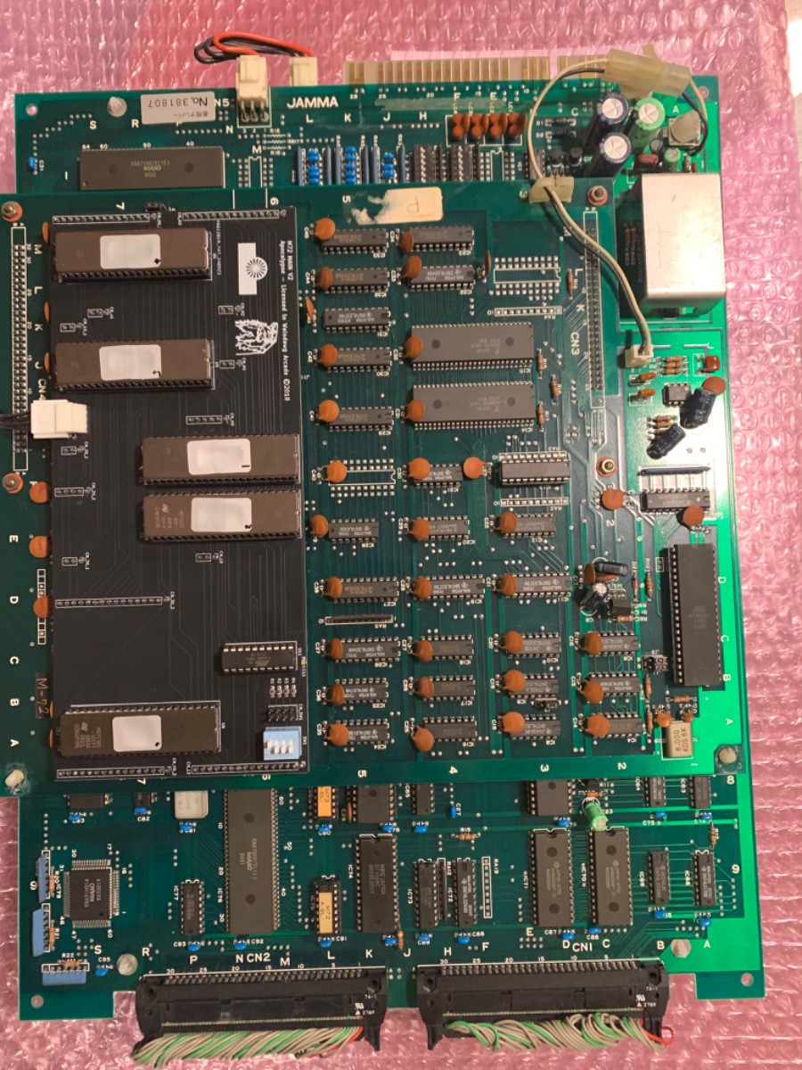

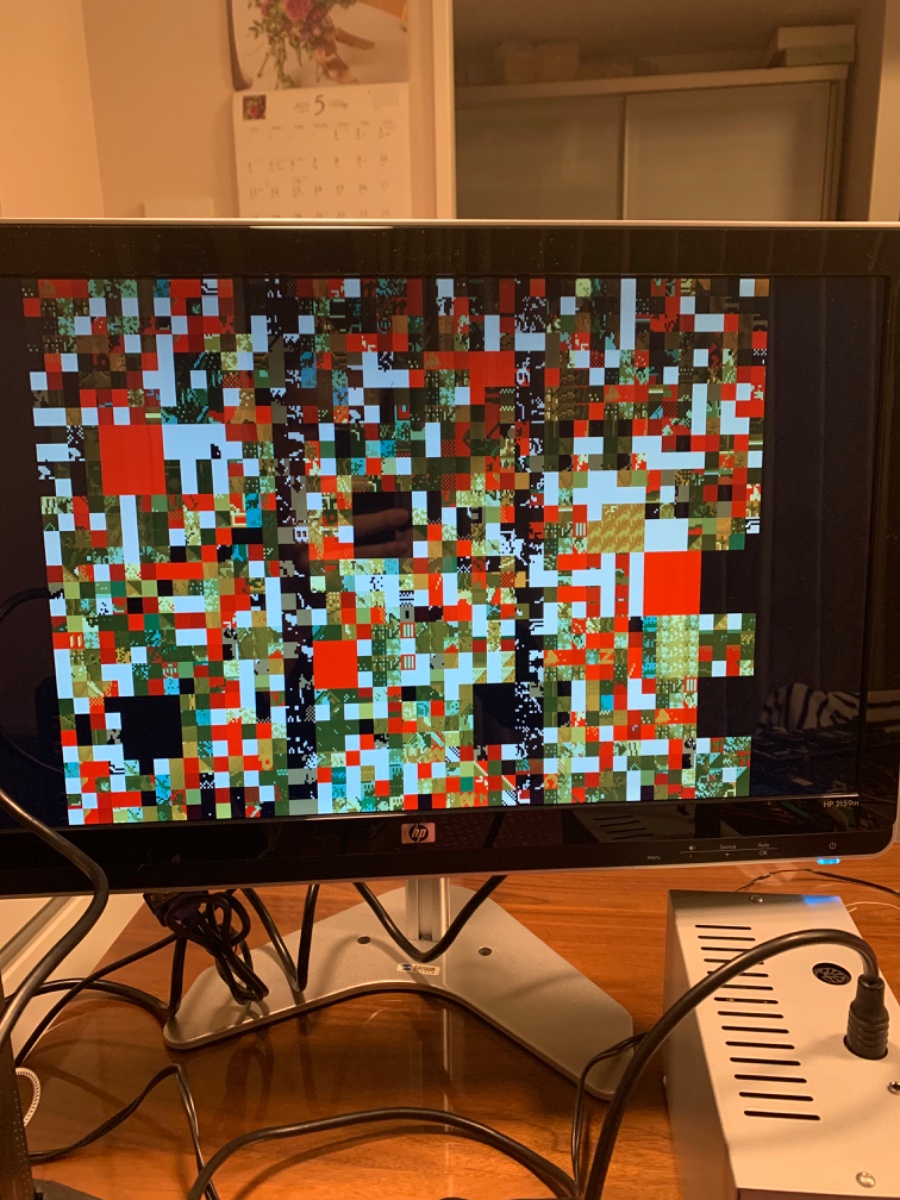

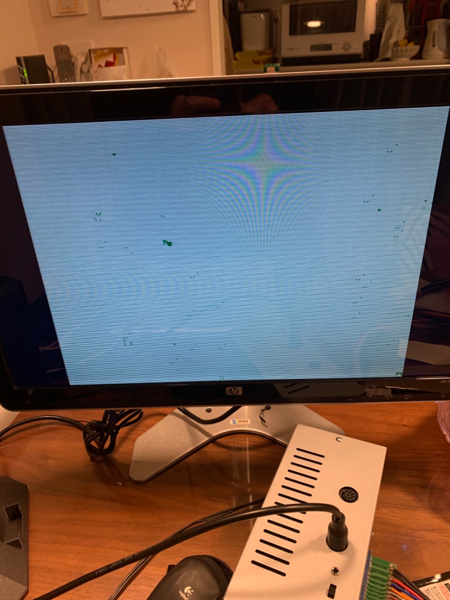

Hi, I have set up the multi but I obtained a grey screen with some messy pixels shown on the following picture.
Is it the program, the multi board not well seated or the switches ?

The rom generator does not work anymore. You must use the newest rollup pack on archive.org.

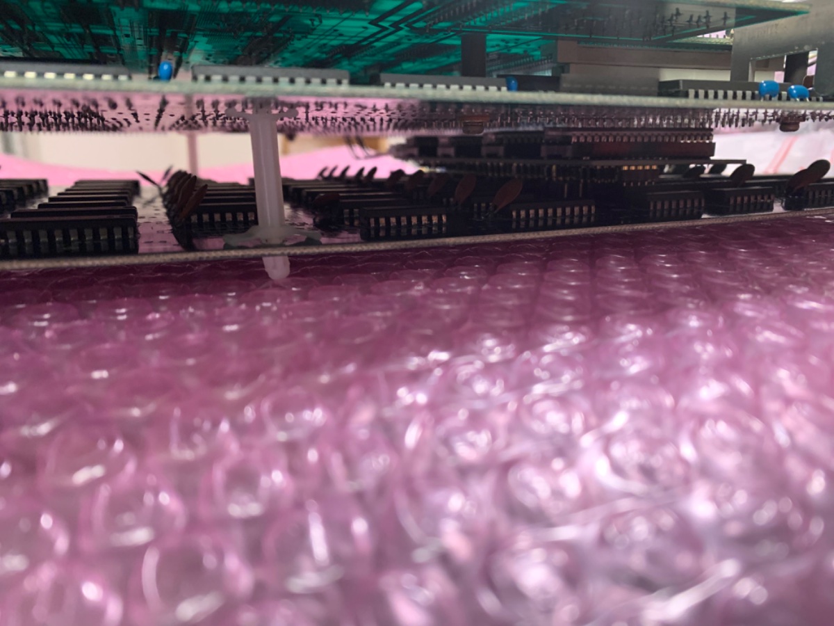

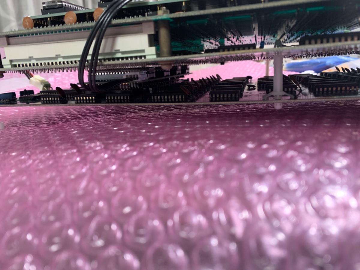

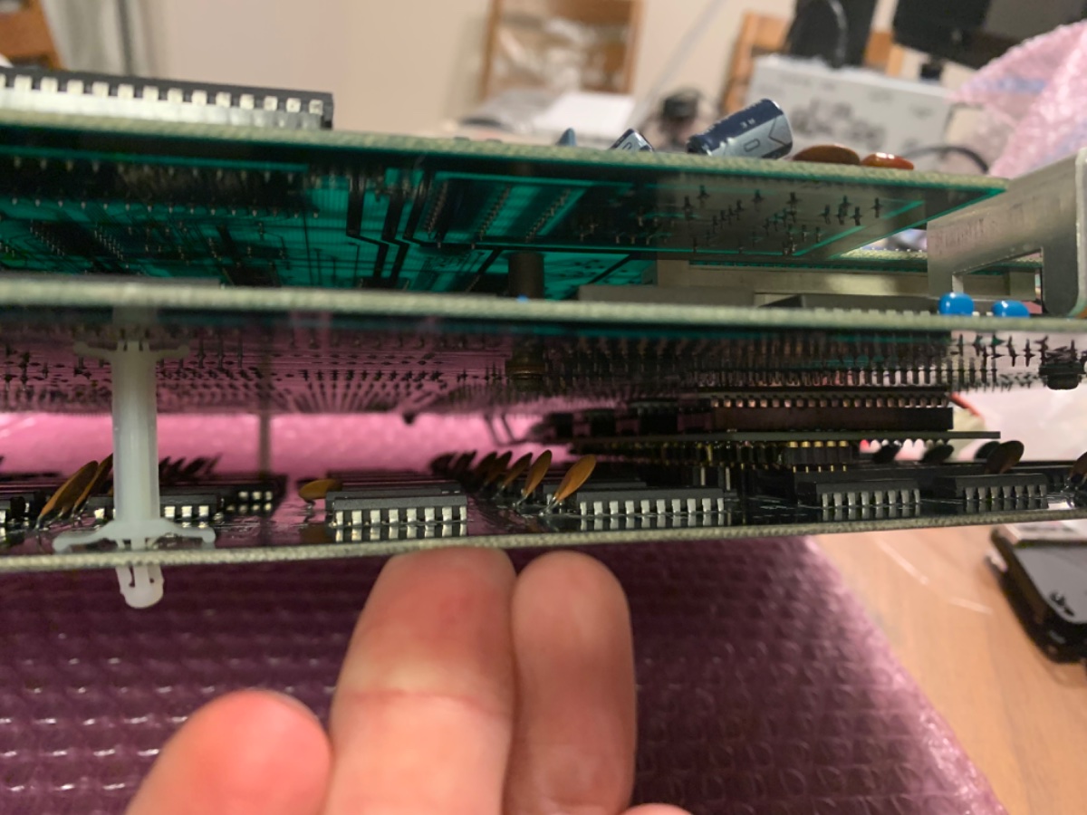

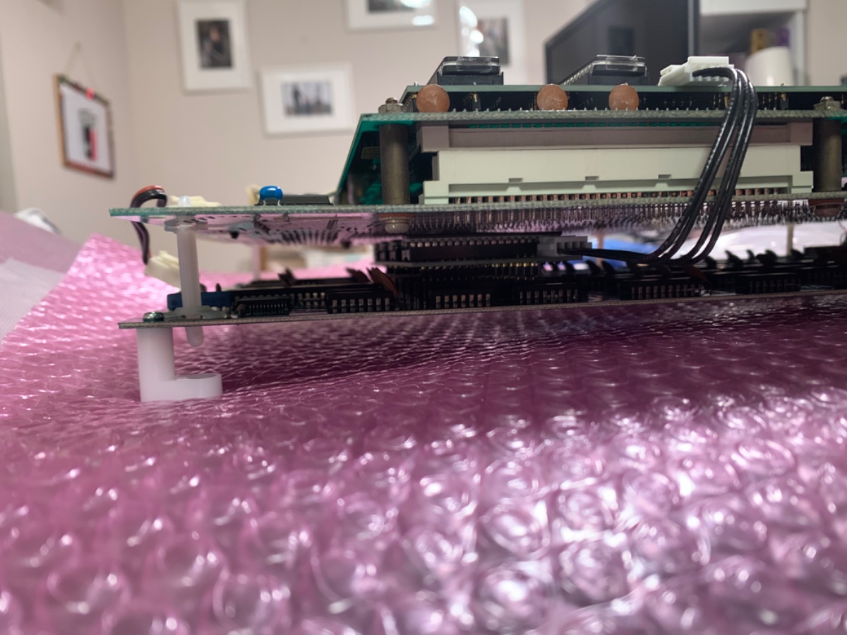

I recommend replacing those plastic standoffs with metal ones. Otherwise the underside of the middle PCB can scrape on the top of the Multi daughterboard on the bottom board and cause problems.
Thanks it was a nightmare to install the plastic standoffs. What s length for the standoffs you recommend ?

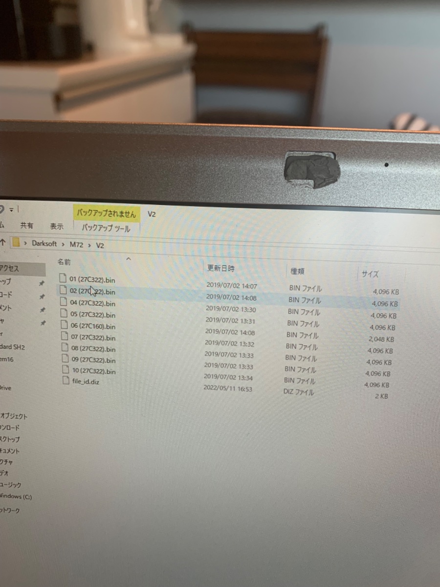

Rom 06 is a 27c160, correct?
Try the rollup here:
Yes you can see it on the picture . On U6, 27c160
