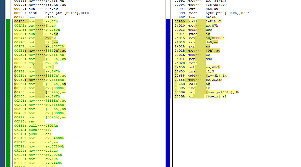

I found an issue, a DMA RET not working correctly, but it's just another fix that gets it a tiny bit further and not much improvement.
It's maybe a good idea to scrap this attempt and start from a known good patched set, the regular changes are not a problem for me but the MCU is.
Also i know the mame patches are no good, as they write some values into B000 (and work ram), and guess the game reads those at random.
B000 is the new irq, so any time the game sends anything down there it crashes, same as e000 - sound ram on the 72 but work ram on the m84.
The error below was an unneeded POP.
