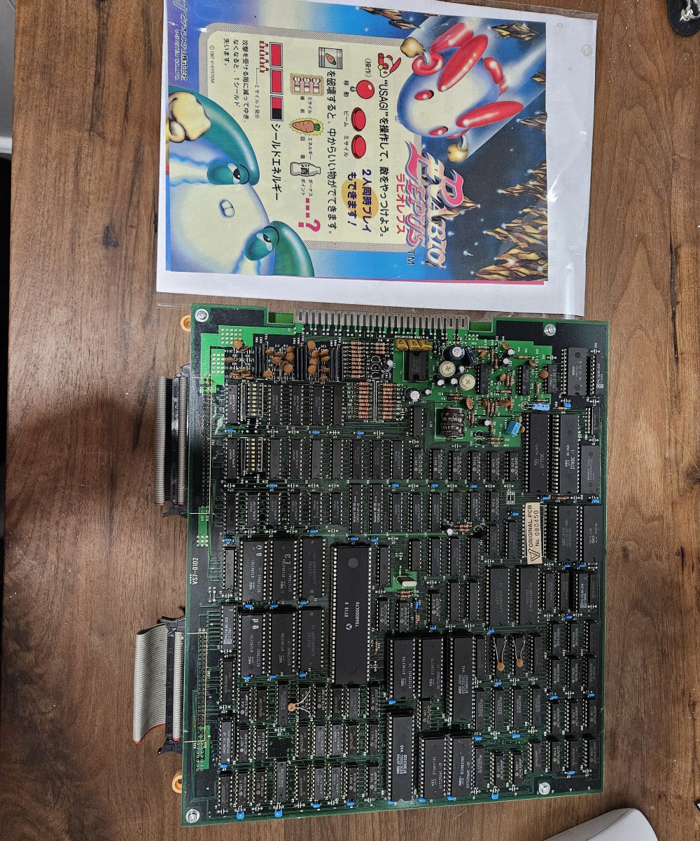

Also lack of jamma key is not an abosulute indicator that it is a bootleg. Look at Rabio Lebus by Video system. That doesnt have a Jamma key.
It's an exception to the rule, I didn't know Rabio Lepus didn't have a JAMMA key.
It would be great to list original titles with that peculiarity, I'm anticipating the list to be rather short.
UPL was also notorious for licensing manufacturing and distribution to Asain companies to cut costs, hence keyless jamma edges.
