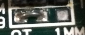

Now, these jumpers are simply wire bridges soldered into place. That works great for the longevity of this game as originally intended. But doesn't work well for us tinkerers that want to convert this game to R-Type Leo. As we work to reconfigure these jumpers, there is a consideration we have to make here. Other methods discussing this conversion around the Internet simply state to replace this wire bridges once you have moved them into the alternate jumper position. Since this forum is populated by a bunch of arcade snobs (me among them), we are going to do this a little bit cleaner. There is one more ancillary benefit for doing this which shall be discussed later. For now, here is a snap of what the wire bride looks like at J8, J15, and J16:
To remove the wire bridges, perform the following:
  1. Apply a small amount of liquid flux on a cotton swab and brush it over the 3 points of the J8 jumper on the components side and solder side of the rom board. This helps the solder to flow easier. Do the J8 jumper first as this one has the most clearance and is the easiest one to do.
  2. Place your iron on any one of the 3 points of the jumper on the component side of the board and with the solder pump extract the solder for the thru-hole point until you can see space through the solder point.
    • Repeat for the two remaining solder points for that jumper.
  3. At this point, the solder pump should have pulled the solder from the other side of the board. If not, repeat step 2 on the solder side of the rom board.
  4. From the solder side of the rom board, place the flat side of your iron tip so that it touches both of the ends of the wire bridge. Apply gentle pressure as the wire bridge heats up. Do not push hard or your will bend the pins, making life harder on yourself. The idea here is that as the wire bridge heats, whatever solder is holding it in place shall melt and you will be able to push the wire bridge most of the way out. If you do this correctly, the pins will be flush with the rom board.
  5. Flip the board back over to the component side. Now you will have clearance under the wire bridge and will be able to use needle nose tweezers to pull the wire bridge out. If you are lucky, there is no solder holding the wire bridge fixed to the board and it will come right out. If you have any kind of resistance, DO NOT apply any force to pull out the wire bridge. Apply your iron to one point of the wire bridge and pull that side until the bridge comes free. Repeat the same for the other end of the wire bridge if needed.
    • Pay particular attention as you do this, be sure not to scratch the board with your tweezers! You may cut a trace in doing so.
    • Also be sure not to pull the wire bridge out if it is still soldered in place. You may pull the point along with it!
  6. Discard the wire bridge. You won't need them anymore.
  7. Apply a small amount of isopropyl alcohol to a cotton swap and clean both sides of the solder point of the flux residue.

Congrats! Now repeat the two previous steps for jumper points J15 and J16. If you choose to run the unencrypted sound roms, you do the same for J1 and J6. Once done, the solder side of your board will look like this!
In reality, it doesn't look all that much different than from before you started this. But this photo just illustrates everything is in order now that the soldering is done with! You can now put away the soldering tools.
