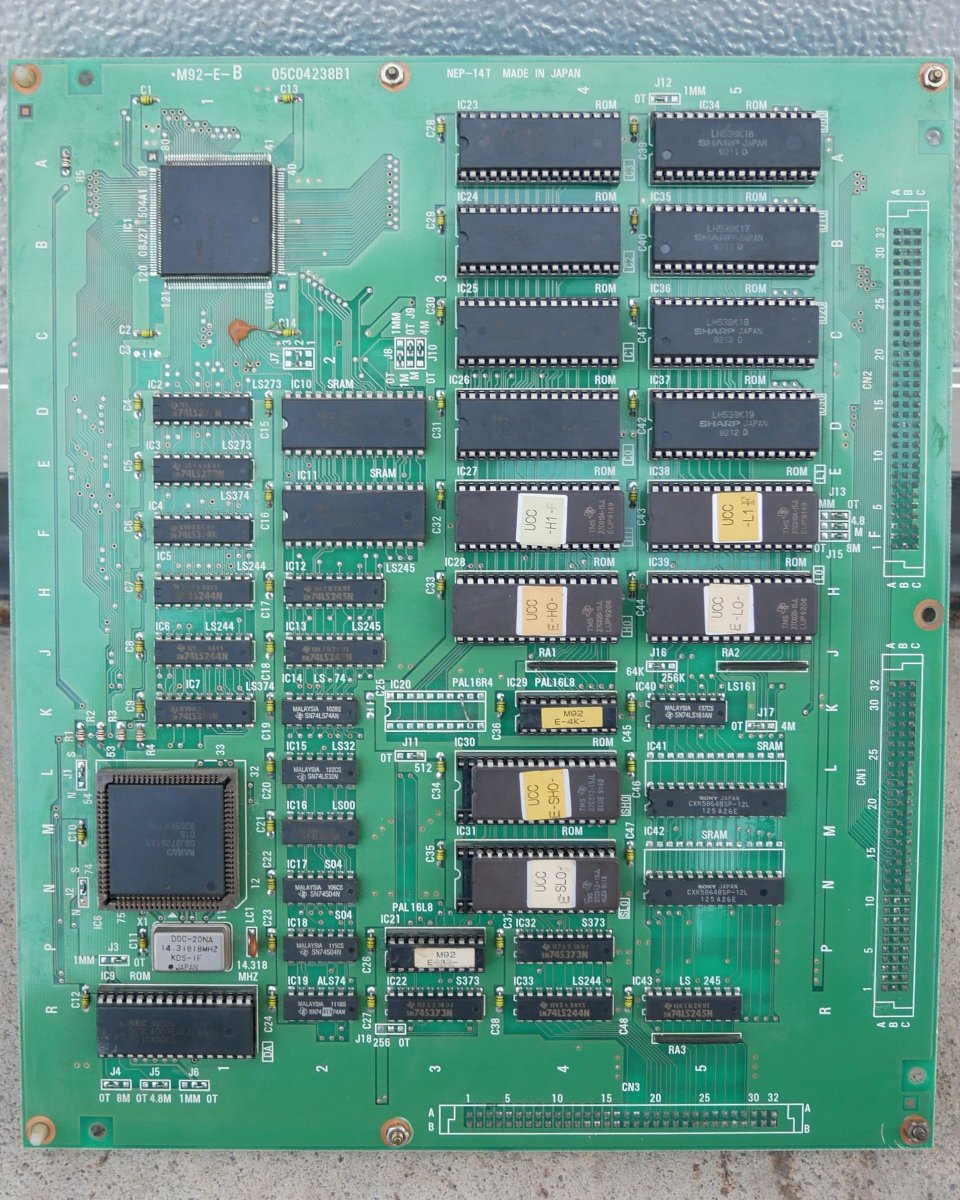

Hmm…this one is a bit of a head-scratcher.
Since the palette is still messed up when transferring the original ROMs to a known-good B board, it definitely sounds like a bad Sprite ROM. Perhaps the replacement EPROMs you tried are too slow? Make sure you’re using 27C080 EPROMs for the Sprites that are 120ns or faster.
Do dumps of the original Sprite ROMs match the MAME checksums?
Also make sure that your power supply is delivering 5.0V to the board set. These are power hungry boards and it’s possible that your Undercover Cops ROMs need more juice.
