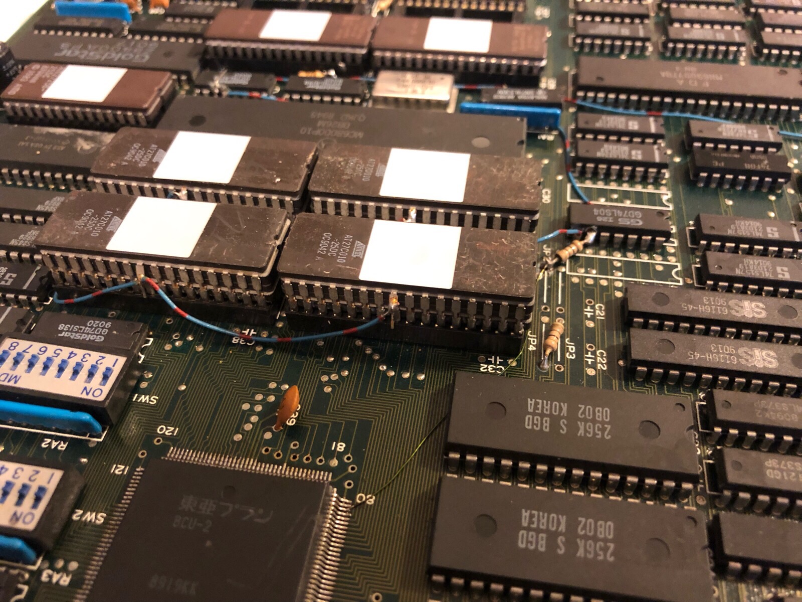

Is the picture you posted the result of the "official" conversion Zero Wing -> Out Zone?
Interesting sub board there. The idea of a switch is cool but probably a bit out of my league :D

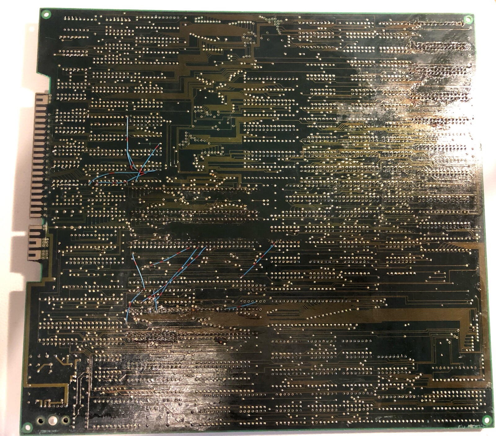

I have yet to find a high def picture of the original Zero Wing on the net where you can see the all the board clearly for ref, so if you have access to one (both sides) I'll take it :D

the previous wire work/conversion was made by a savage. It will be hard to salvage it but I'll do my best (lots of lift pads and borked jumpers/traces). Thanks!

My faulty Out Zone seems to have been converted from Zero Wing, judging by serial of the PCB. It's a real mess unfortunately, I don't even know where to start on how to repair it.

It's running on the original set not the conversion set! Very interesting and explains the extra wire work used.
I guess they (the 'converter' back in the day) did not have access to the actual conversion roms.
