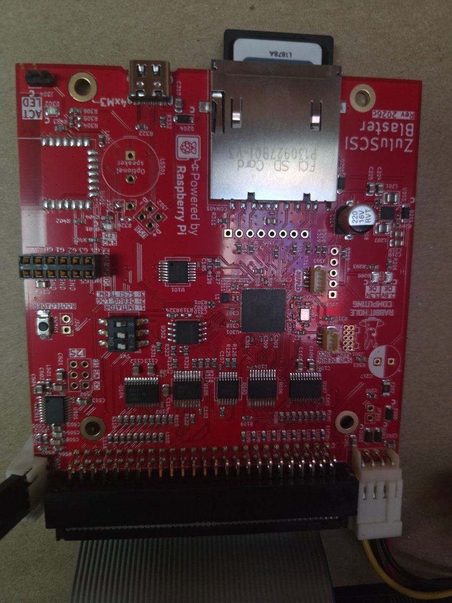

I got in the new ZuluSCSI with the Zulu Blaster Audio DAC Unfortunately I haven't got it to work with the Konami GV yet.

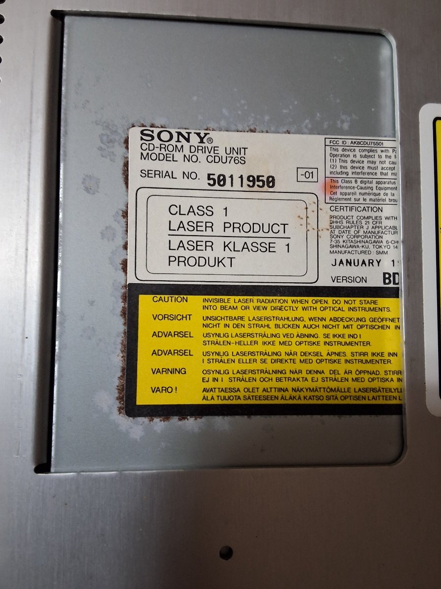

The specific drive that my hardware uses is the Sony CDU76S: http://insight.actapricot.org/insight/common/drives/cd/so76sc.htm

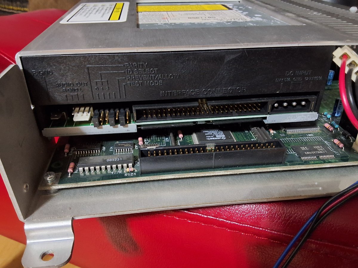

The jumpers in the back have "Parity", "ID2" " and "Test Mode" jumped (unsure what test mode does).
The Prevent/Allow Jumper is removed (which disables the eject button on the drive).
The Bin/Cue Image I'm using with the Zulu for the disc is the same bin/cue I used to burn a CD-R to play in the drive so I know that's correct. and I have it labeled CD2.cue and CD2.bin (this is the way the new firmware sets the drive ID)
When you boot up this hardware it does some system checks then does a "Media Check" where it compares some data on the CD to data stored on the GV board in an EEPROM as a security check, so if the drive is bad or you're using the wrong disc then it fails this check and the system reboots and starts over. and it's failing that check.
I don't think it's locked to any specific model CD-ROM drive as these GV systems also sometimes shipped with a Toshiba XM-5401B and I did grab a completely different model drive from a Capcom CPS3 setup (Panasonic / Matsushita CR504-KCM) and it ran from that drive fine once I configured the parity and ID jumpers correctly (it's worth noting that the CPS3 drive does not have a "test mode" jumper nor a prevent/allow jumper).
I've attached a couple of log files from my attempts one where I used an ini file and one where I didn't (the settings seem to match all the defaults)
this is the log file I'm getting when the system reports "BAD" on the media check step

anyone have experience with the Zulu or any other SCSI emulator that sees anything obvious I might be missing?
